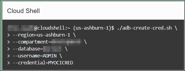

Create Credentials using OCI Cloud Shell
You can create OCI native credentials using a Cloud Shell script.
adb-create-cred.sh to generate credential scripts. The adb-create-cred.sh script searches for existing credentials, if found you are asked if you want to reuse them or if you want new credentials created. Depending on your decision, the generated credential scripts include new or existing credentials. Download the OCI Native Credential script or copy it to run it directly in your database using any SQL or JSON tool or utility.
For a list of arguments supported by the Create Credential script, enteradb-create-cred.sh --help.
In this example, OCI Native Credential scripts are generated in the script area for your tenancy without running them in your database.
- On the Connections page, click Create and select New Cloud Store Location. You need to know the Name and Cloud Store Location of the Credential to create a new one.
- Select Create Credential.
- On the Create Credential wizard, select Create using OCI Cloud Shell. You will view a script in the script editor field.
- If you are in your home region and the Autonomous AI Database is in your home region, run the script without the region argument. The script assumes the Autonomous AI Database is in your home region and will not prompt for an alternate region.
- If you are in your home region and your Autonomous AI Database is in an alternate region, then you must pass in the --region argument when running the script.
- Click Copy Script.
- Sign into your OCI Tenancy, select the Developer Tools icon and click Cloud Shell from the drop down list.
- Paste the
adb-create-cred.shscript you copied in the previous step that includes arguments the tool uses to locate the database, connect to the database and the credential name you provide in the Credential Name field. - The Cloud Shell script informs you of existing OCI API Keys and Fingerprint and if you want to reuse them. Enter
yto reuse the existing keys and fingerprint.If you choose to create new credentials, and decide after overwriting the credentials that you want to use the overwritten credentials, you can go back to the directory where the backup is and reuse them. The backup file name or folder has a suffix with this syntax:
_bkp_YYYYMMDD_abc. For example, this backup file was created on June 06, 2024:_bkp_20240603_woT. - The Cloud Shell script window displays if you want to run the credential scripts on your Autonomous AI Database. Enter
yto run the credential script in the database with the region, compartment and database arguments. - You can view a notification that informs you that you do not have a wallet file. The script creates a wallet file. You must specify the ADMIN password you use to connect to the database. In case the script detects the wallet file, the script prompts you to either reuse it or set up a new one.
If you have an Autonomous AI Database private endpoint in a Virtual Cloud Network, the
adb-create-cred.shscript generates the SQL and JSON scripts. However, it does not perform the steps required to access the Autonomous AI Database private end point. Instead, it prompts you to executecat ~/oci_native_credential.sqlto copy the SQL into whatever SQL tool you have access to via a Bastion or Jump Host. - The Cloud Shell script displays a notification of successful login and creation of credentials in the specific database.
The script prompts you if you want to run it on another database. Enter
nto not run credentials in another database.The script exits and displays the path to run the
oci_native_credential.sqlscript to create a credential.Note:
If the connection to the Autonomous AI Database is unsuccessful, you can runcat ~/oci_native_credential.sql, and copy the SQL to run it directly in your database using any SQL tool.
