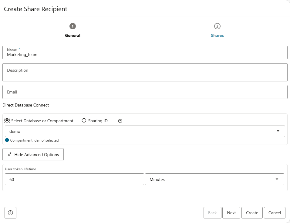

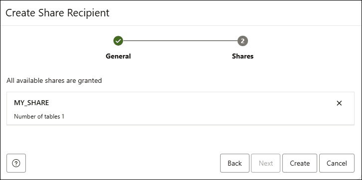

  • Create Share Recipient
    Use the + Create Share Recipient icon on the Provide Share page to create a consumer of the data share. When there is already a recipient created, use the + Create Recipient icon on the Recipients widget of the Provide Share page to create a consumer of the data share.

  5. In case you want to create a new recipient, select New Recipient. Selecting New Recipient opens a Create Share Recipient wizard. See Create Share Recipient.
    Ensure there are no spaces in the name of the recipient. This field does not support duplicate recipient names. If you try creating a recipient with a duplicate name, the creation of the share fails with the "Name is already used by an existing object" error.
    Click Create to finish creating the share recipient. The newly added recipient is displayed in the list of recipients. Click Cancel to cancel the ongoing process of recipient creation.
  6. After you create a new share recipient, in the granted recipient's list you can:
    • Select copy profile activation link to clipboard icon to copy the activation link.
    • Select Email recipient profile download link icon to mail the profile link to the recipient you select in this step. Once you select it, the Share tool triggers an activation mail with the profile link to the recipient’s email address. Click Send to share the profile link with the recipient. See About the Consume Share Page to know more about the activation mail and how to proceed as a recipient once you receive the activation mail.
    • Click deselect Recipient icon to remove the selected recipient.Description of new-recipient.png follows
    Select Create to create the share. Note that the status of the share changes from unpublished to published depending on the size of the table in the share. You will receive a successful share notification message at the top right of the display that says the share is successful. The Provide Share page displays the share along with its details such as the entity type, owner, shared objects and the recipients.

23.3.5 Create Share Recipient
On the Provide Shares page, click the Recipients widget and select + Create Recipient to create a new Share Recipient.
Share Recipients are those with whom we intend to share objects with. You can share objects securely with users outside of Oracle workspace. Apart from creating recipients from the Create Share wizard, you can also create a share recipient from the Create Recipient icon on the Provide Share page and verify the details you configure while its creation.
  1. On clicking the + Create Recipient icon, a Create Share Recipient dialog box appears.
  2. On the General tab, specify the following fields:
    • Name: Enter the name of the Share Recipient. For example, Marketing_team.
    • Email: Enter the email ID of the recipient. For example, marketing@oracle.com.
    • Description: Add a description. This is optional.
    Under Direct Database Connect section you can select any of the available options:
    • Select Database or Compartment: You can select the Database or Compartment from the drop-down.
    • Sharing ID: An intended Recipient should copy this ID from the consumer page and send it to the Producer to be used here. The Share Provider wont have access to the consumer page. This field is required for Live Share Recipients only.
      On the User token lifetime section, enter any value in the TOKEN_LIFETIME field for the share recipient. This property specifies for how long the generated token will be valid after which the recipient loses access to the data share and must request a new token. Enter 60 in the first text field. Select Minutes from the drop-down menu.
    Click Next to progress to the Shares tab of the Create Share Recipient dialog box.
  3. On the Shares tab, select an available share from the drop-down. As you select the share, it lists under the Granted Shares section. You have the choice to share multiple shares to the recipient.
    Select Create to create the Share recipient.
Once you have created the Share recipient, you will be able to view the newly created Share Recipient entity in the display area of the Provide Share page. The new recipient card displays details such as the entity type and the owner.Description of new-share-recipient.png follows
