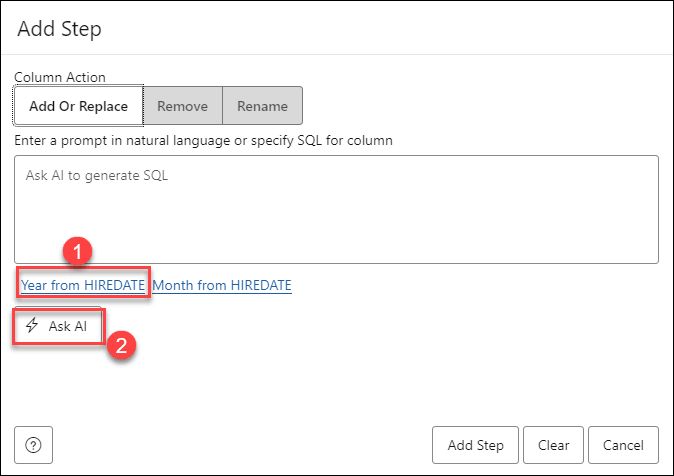

- Add Steps to build the recipe that is comprised of various column actions.
- Click Add Step to update the source tabular data.
- Specify the following fields in the Add Step dialog box:
On the Column Action, you can select one of the following available actions:
- Add or Replace: You can add or replace the data in the source column based on the SQL code the tool generates in the prompt field. See Add a Column or Replace a Column. For example, if you replace
SALES_DATEwithYEAR, (assumeSALES_DATEas a date data type) with prompt such, you will get aSALE_DATEcolumn with years. - Remove: You can remove a column from the source data. See Remove a Column.
- Rename: You can rename a source column. See Rename a Column.
The fields generated when you add steps varies on the column action you select.
- Select Year from
HIREDATE. - Click Ask AI.
- Click New Column to create a new column and store the Year from
HIREDATEvalue. - Click Add Step to create a recipe.
