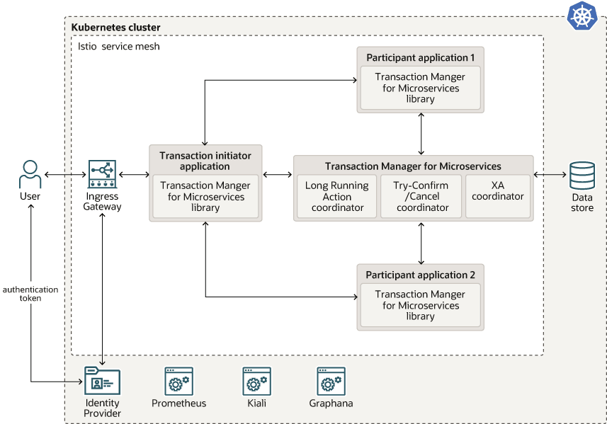

The following image shows a sample deployment where MicroTx Distributed Transactions is installed in a Kubernetes cluster within an Istio service mesh along with other microservices.
Istio is a service mesh that provides a separate infrastructure layer to handle inter-service communication. Network communication is abstracted from the services themselves and is handled by proxies. Istio uses a sidecar design, which means that the communication proxies run in their own containers beside every service container. Envoy is the proxy that is deployed as a sidecar inside the microservices container. All communication inside the service mesh is done through the Envoy proxies.
