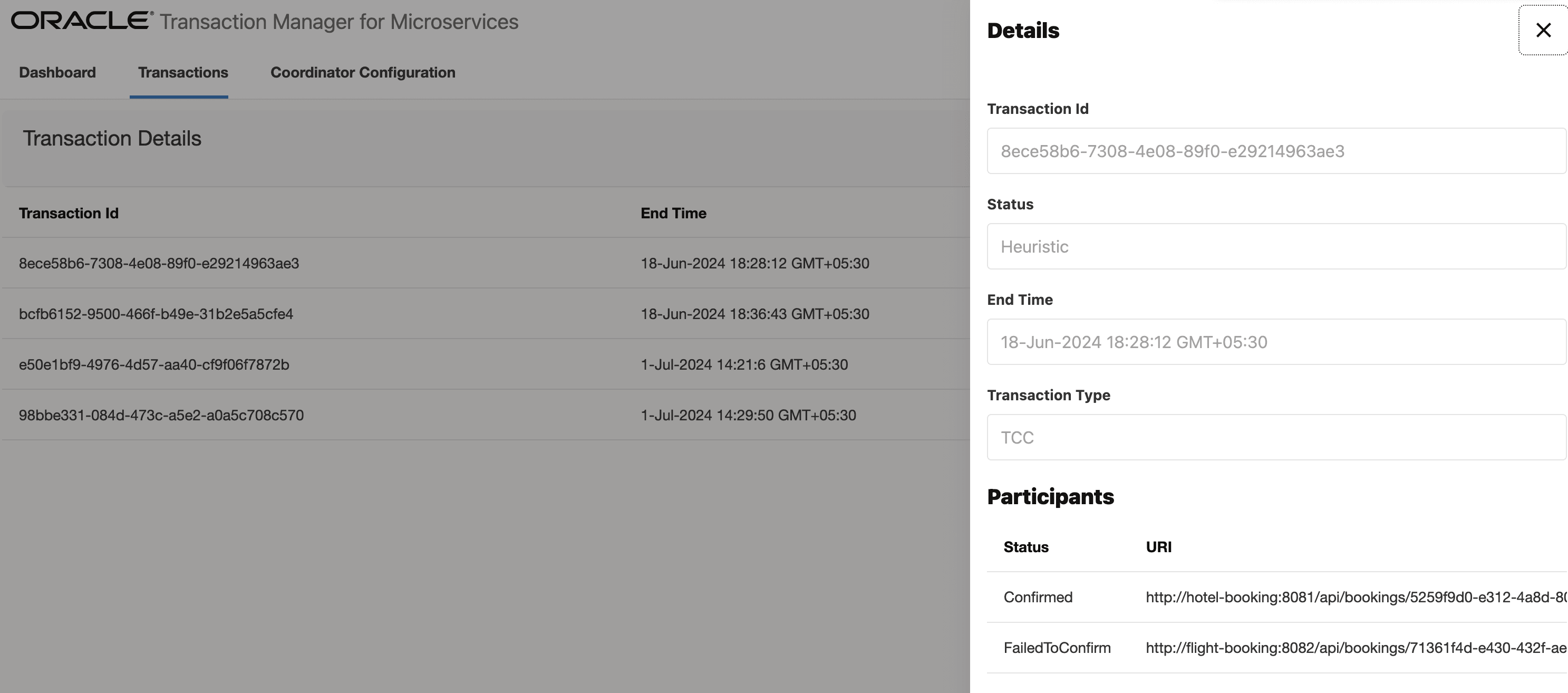

The following image shows the details of a TCC transaction which is in heuristic state. The Participants section provides details about the participant service that failed to confirm the TCC transaction.
Details of a TCC transaction which is in heuristic state
