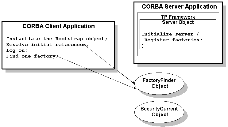

The CORBA client application needs to perform the following steps:
- Obtain a reference to the factory for the object it requires.
For example, the client application needs a reference to the SimpleFactory object. The client application obtains this factory reference from the FactoryFinder object, shown in the following figure.

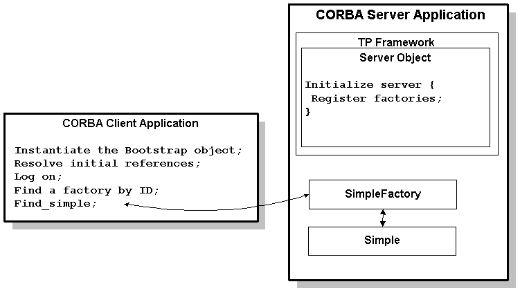

- The TP Framework invokes the
activate_object()
andfind_simple()
operations on the SimpleFactory object to get a reference to the Simple object, shown in the following figure.Figure 2-8 Operations on the SimpleFactory object
The SimpleFactory object then returns the object reference to
the Simple
object to the client application.
Because the TP Framework activates objects by default, the Simpapp sample application does not explicitly use theactivate_object()
operation for the SimpleFactory object.
