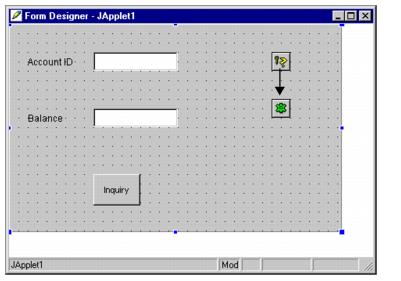

- Click the Interaction Tool icon in the toolbar of the Visual Café Form Designer window to display the bean components.
- Click on the JoltSessionBean and drag a line to the JoltServiceBean, as shown in the following figure.
Figure 5-14 Wire the JoltSessionBean to the JoltServiceBean

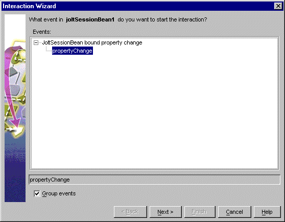

The Interaction Wizard window is displayed as shown in the following figure, with the prompt:
What event in joltSessionBean1 do you want to start the interaction?
- Select propertyChange as the event that starts the interaction, as shown in the following figure.
Figure 5-15 Select propertyChange Event
- Click Next.

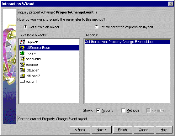

How do you want to supply the parameter to this method?
and a list of available objects and actions from which to choose.
- Select joltSessionBean1 as the object that supplies the action, as shown in the following figure.
- Select Get the current Property Change Event object as the action, also as shown in the following figure.
Figure 5-17 Select joltSesssionBean1
- Click Finish.
