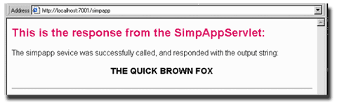

Step 9. Return the Results to the Client
The final step constructs and sends an HTML page, which contains
the results of the service call, back to the client through the
HttpResponse output stream. The uppercase result is retrieved from
the ServletResult object using the
result.getValue() method.
The following is a simple example of passing this data back as HTML that the browser can display:
out.println("<p><center><font size=+1><b>"+
result.getValue("STRING", "")+
"</b></font></center><p><hr
width=80%>");The output stream produces a page similar to the one shown in the following figure:
Figure -2 Output Stream Results Example
