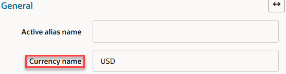

    8. Assign currency names to members in the country dimension. For the top-level member, assign the currency name of the base currency (for example, USD) to ensure that the base currency is inherited down the country dimension hierarchy. When the children of a member share a single currency, you only need to define a currency name for the parent.
      Image of the Currency Name field on the General tab of the member inspector at the top of the Market dimension (country dimension).

    7. Assign currency names to members in the country dimension. For the top-level member, assign the currency name of the base currency (for example, USD) to ensure that the base currency is inherited down the country dimension hierarchy. When the children of a member share a single currency, you only need to define a currency name for the parent.
      Member properties, General tab, showing USD selected as the currency name
