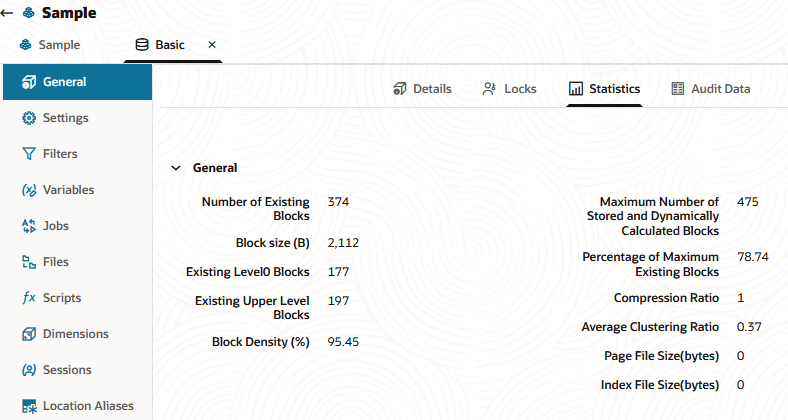

View information about a cube, including the potential and actual number of data blocks and the data block size, by using the Essbase web interface or MaxL.
Storage statistics for a cube are available in storage > statistics. Image displays some of these statistics for cube Sample Basic, including: Number of existing blocks 374, Block Size (B) 2,112, Existing Level0 Blocks 177, and more.
The equivalent statement for viewing block statistics using MaxL is:
query database appname.dbname get dbstats data_block;
