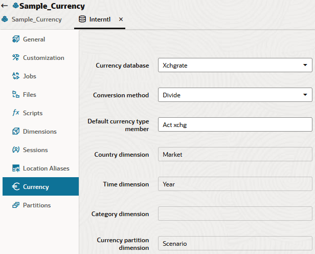

  3. Link the main and currency cubes, if they are not already linked. The following image in the context of the Interntl cube shows that Sample_Currency.Interntl already has a linked currency cube named Xchgrate:
    Image of the Interntl cube context, showing that it is linked to currency cube Xchgrate.
