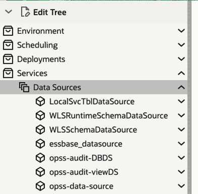

  10. As the WebLogic administrator, log in to WebLogic Server Administrative console http(s)://<hostname>:<admin server port>/console, and update all Data Source passwords with the new password. You can use the same password for all schemas.
    1. From WebLogic console, under Edit Tree, navigate to Services > Data Sources.

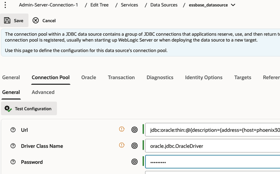

    2. For each Data Source in the table, click the Data Source name, click the Connection Pool tab, update the Password field with the new password, and click Save.

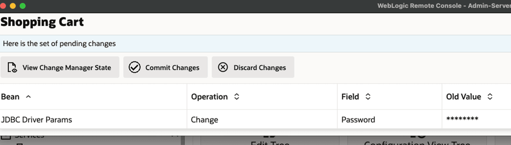

    3. After all Data Source passwords have been updated and saved, click on the Shopping Cart option on the top right corner.
      Shopping cart icon on the top right corner of the WebLogic Console.
    4. View the changes and click on Commit Changes.
      Shopping Cart section of WebLogic Console with the Commit Changes button available.
