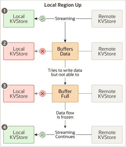

    The XRegion agent streams changes to the multi-region table from each remote region and persists them in the local region. Therefore, if the local region is down, the agent will keep retrying but won’t be able to write any changes. After a period of time, when the buffer in the XRegion agent is full, the XRegion agent will stop streaming data from the remote regions and the data flow gets frozen. When the local region is back, the XRegion agent will just resume the stream and the workflow. No manual intervention to the XRegion agent is needed here. However you may have to fix the issue with the local region manually.

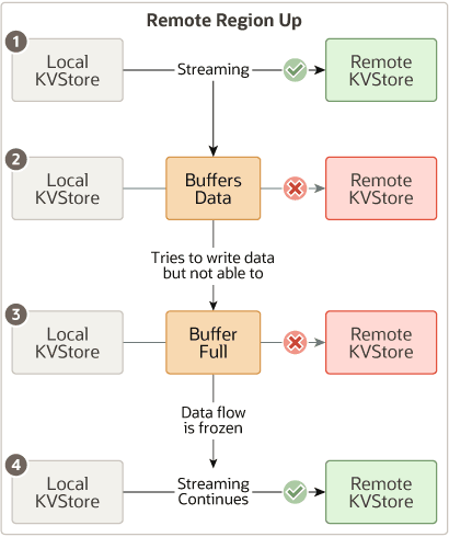

    If a particular remote region is down, the XRegion agent will just keep retrying till that remote region is back. This issue is similar to any network connection problem with the XRegion agent. Until the connection to the remote region is established again, the multi-region table at the local region won’t be able to see the changes in that remote region. But changes in the other remote regions are not affected as long as the XRegion agent is able to maintain the connection to these regions.

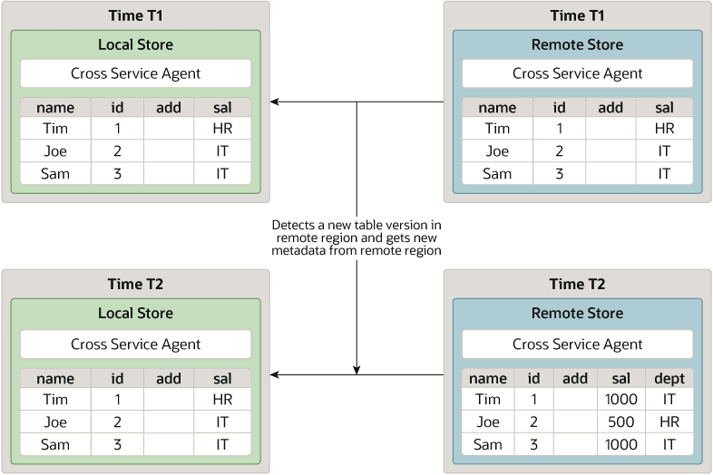

    Schema evolution happens when there is a schema change in any of the remote regions. Then the schema of a multi-region table at the local region differs from that in the remote region. In such a situation the XRegion agent will try to solve the difference by converting a row from the remote region to the schema of local region. For example, if you add a new column to a multi-region table at a remote region but this new column is not yet added in the local region. The multi-region table at the local region will not be able to see the new column in the changes streamed from the remote region, but the local region should still see the other columns. This would last until you fix the problem by adding the same column in the local region to end the schema divergence. In a multi-region table, there is no automatic notification to other regions when a schema changes in one region. The XRegion agent of local region is able to detect the change when it sees the data from a remote region with higher table version, and it will refresh its table metadata from the remote region to get the latest schema.

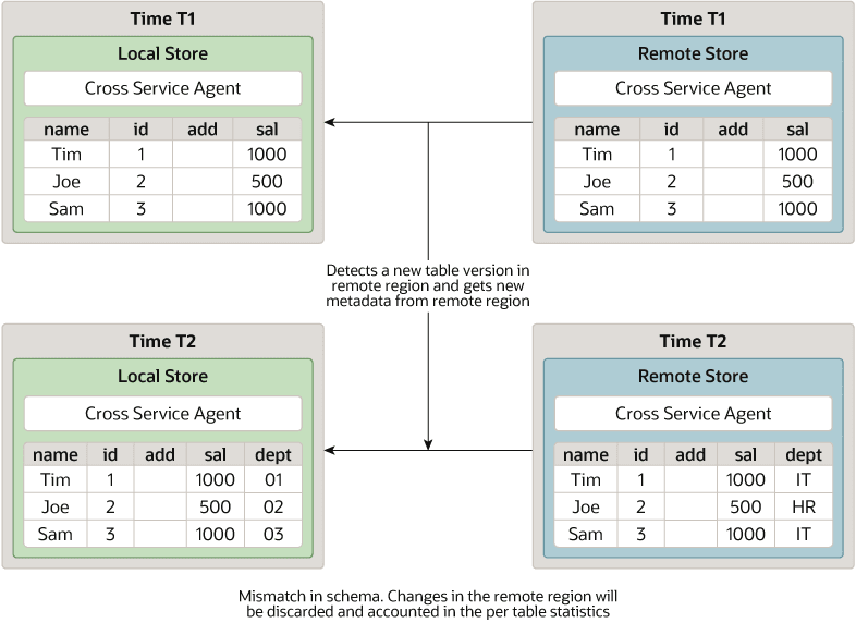

    Consider the situation when the schema in different regions diverge in a way that the agent is not able to fix the schema differences by refreshing the local region table metadata from the remote region. For example, if you add a new column “Foo” with type “STRING” to the remote region but adds the same column with type “LONG” in the local region, these changes at the remote region are considered incompatible to the local region, and the agent cannot fix this difference. These changes from the remote region will not be persisted locally. Consequently the changes in the remote regions will be discarded and accounted in the per-table statistic incompatibleRows. See the details about persistence of remote data in the show mrtable-agent-statistics section.\
