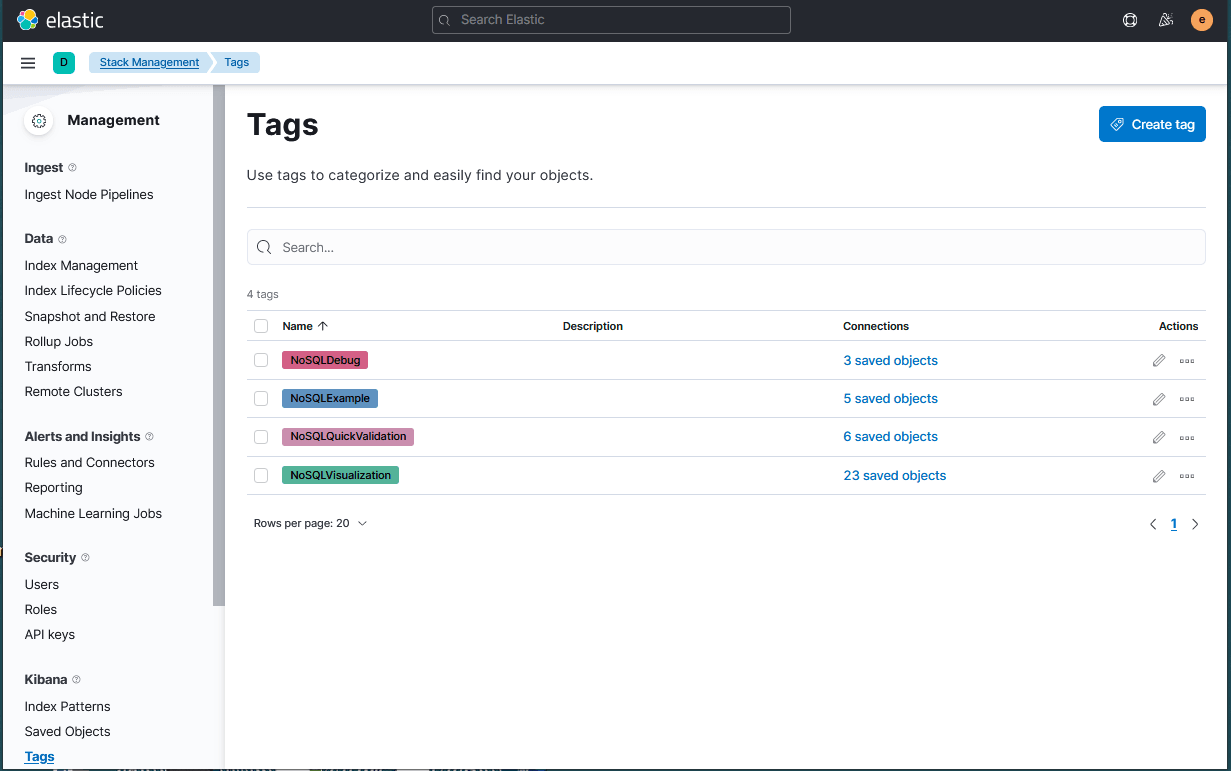

The save objects are classified into 4 types using tags. 1. NoSQLVisualization
  1. NoSQLExample
  2. NoSQLDebug
  3. NoSQLQuickValidation

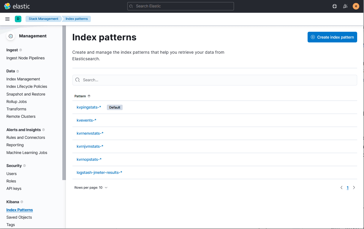

Creating Index Patterns
By using the command import, you automatically configure index patterns.
  1. kvrnjvmstats-*
  2. kvrnenvstats-*
  3. kvpingstats-*
  4. kvrnopstats-*
  5. kvevents-*
Note: This index may not exist if the store is brand new as no events have occurred.

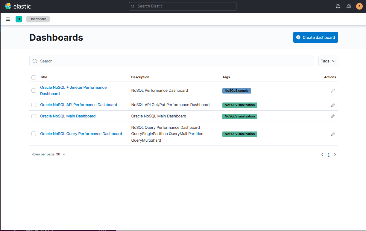

Figure 4 - Kibana Dashboards

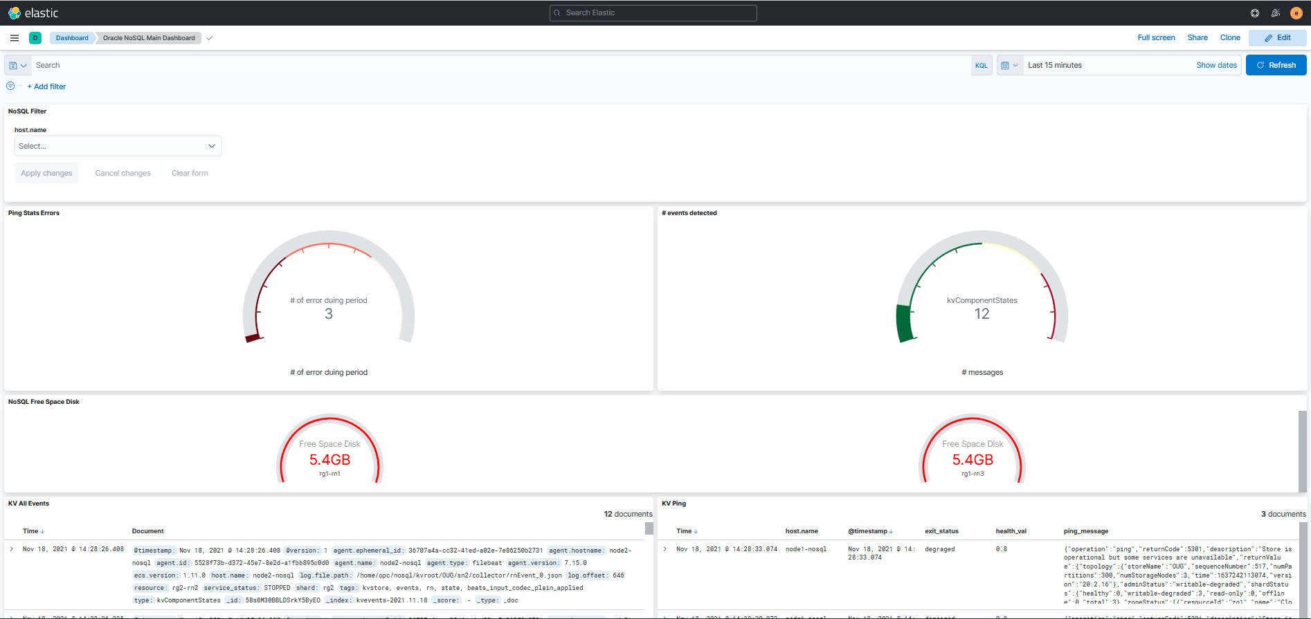

TheOracle NoSQL Main Dashboard shows you the important information about the health of the cluster.
Figure 5 - Oracle NoSQL Main Dashboard
Description of kibanamaindashboard.png follows

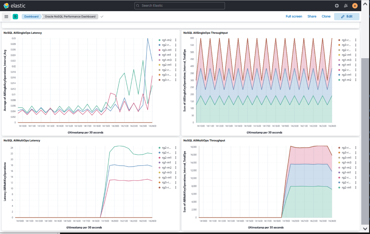

TheOracle NoSQL API Performance Dashboard and Oracle NoSQL Query Performance Dashboard shows you summarized information about the performance of the NoSQL cluster. You provide information about throughput and average latency for the following important API calls. 1. NoSQL AllSingleOps/AllMultiOps shows throughput and average latency.
  1. NoSQL QuerySinglePartition/NoSQL QueryMultiShard/NoSQL QueryMultiPartition shows detailed information on SQL query performance.
    • QuerySinglePartition, operations using primary key indexes
    • QueryMultiShard, operations using secondary indexes
    • QueryMultiPartition, operations doing full scans
  2. PutOps/ GetOps shows detailed information on CRUD API calls.
Figure 6 - Oracle NoSQL API Performance Dashboard
Description of kibanadashboardperf.png follows

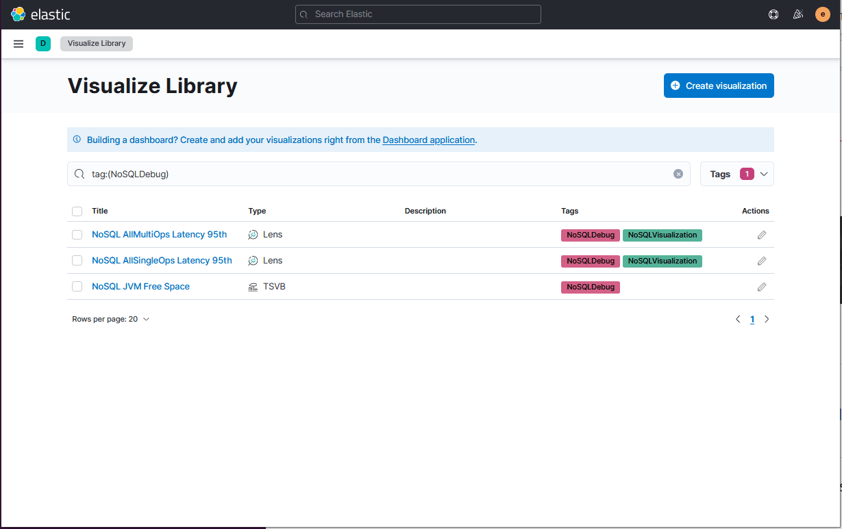

Oracle NoSQL exposes hundreds of metrics that could be valuable when debugging. In order to visualize this information, visualizations are provided in the NoSQLDebug category.You can use these visualization and also create more customized visualizations when necessary. These metrics contain statistics of each type of API operation. And each operation statistics is calculated by interval and cumulative statistics.

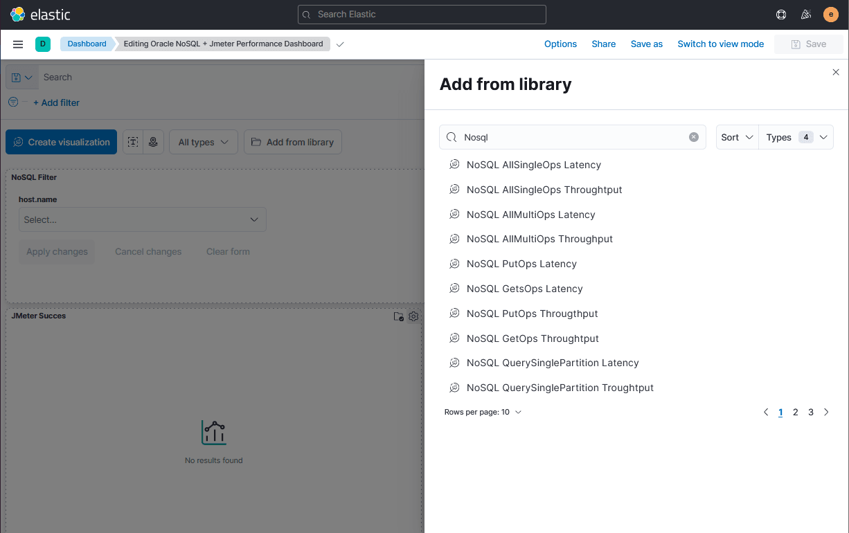

By providing standard Kibana Visualization, you can add this information to your Standard Application Performance Kibana dashboards. It allows you to do a correlation between the application activity, the NoSQL performance and other OS statistics collected (e.g CPU metrics collected using Metricbeat).

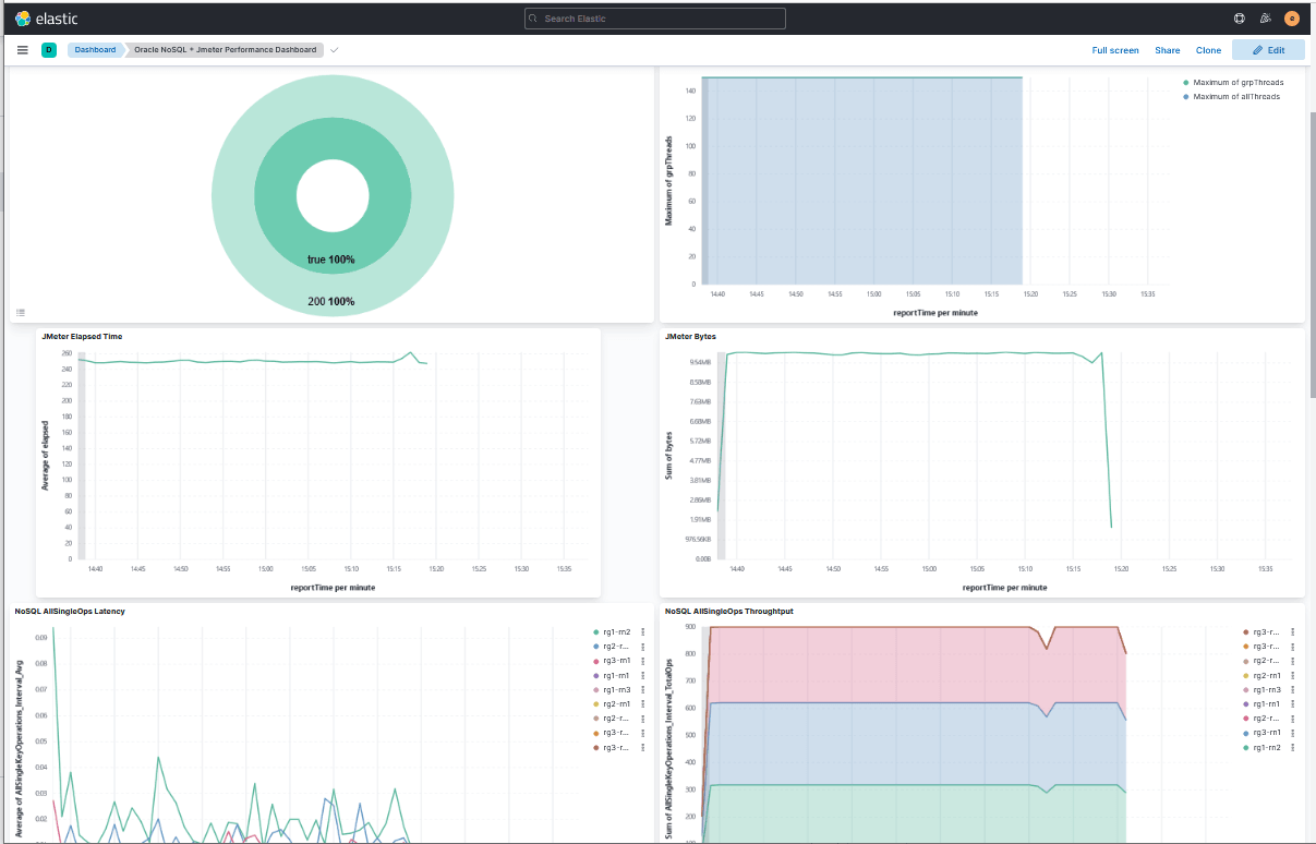

The Oracle NoSQL + Jmeter Performance Dashboard is a good example of the applications dashboards allowing these kind of correlations. The dashboard is used to show how to do the correlation between Application Performance statistics (provided by JMeter) and NoSQL standard performance metrics.
