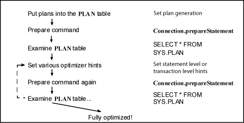

When using JDBC, a developer tuning a join on T1 and T2 might go through the steps shown in the following figure.

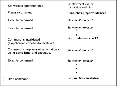

During processing, the application may then go through the steps shown in the following figure.
