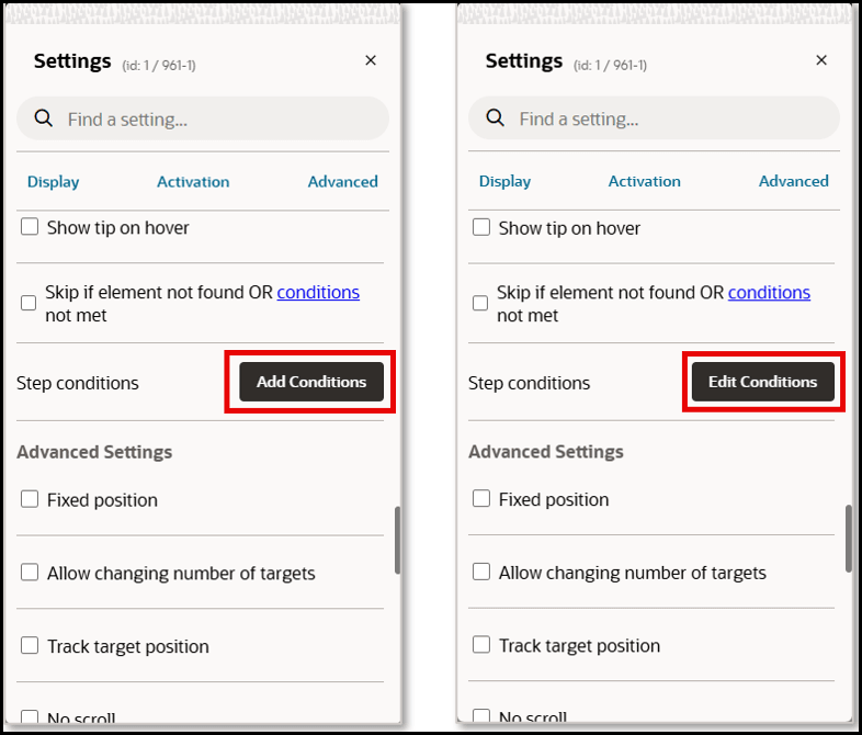

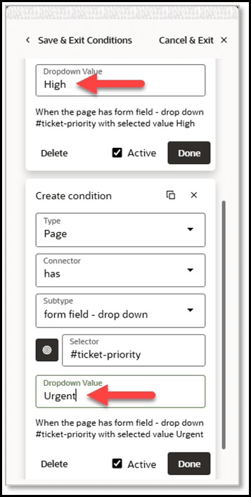

Clone Step Conditions
OGL Full Editor adds a new Clone function to the Create/Edit condition panel, which allows content developers to duplicate an existing step condition and all its field values and settings. This adds convenience and efficiency for content developers who may wish to create multiple step conditions, each with similar settings or field values.
Edit Conditions
Use Cases:
  • When applying validation rules to a guide step, developers can create multiple step conditions, each with similar settings or field values. Cloning a step condition saves time as it duplicates all of the field values from the original condition, allowing the user to adjust just one value, as needed.
  • When setting a condition in which a user has seen a particular guide ‘x’ number of times, several hours apart, based on both time and count.
How to use the Clone Step Condition:
In the following example, we will set 2 step conditions using form field validation that will trigger when the page has a form field – drop down value of ‘High’ or ‘Urgent’.
  1. Create/Open a guide in the Full Editor.
  2. Create/Edit a step and open the Step Settings.
  3. In the Step conditions section, select Add Conditions (or Edit Conditions)
    Add or Edit Conditions

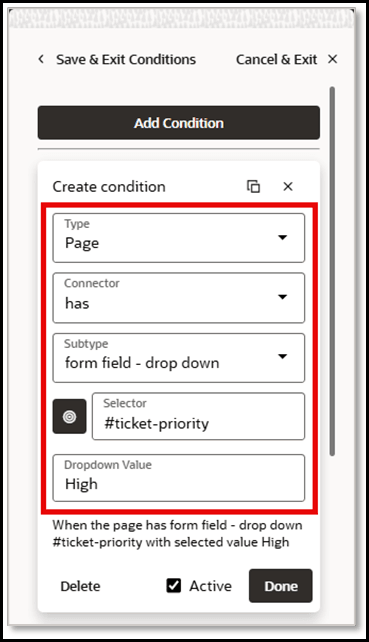

  4. Here we have set a step condition in which the Page has a ‘form field – drop down’ value of ‘High’:
    Form Field

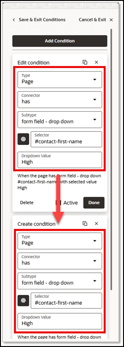

  5. Select the Copy condition button to duplicate the step condition, preserving all of the current settings.
    Create Condition
  6. In the second step condition, change the Dropdown value to ‘Urgent’.
    Dropdown
  7. Select Done for each condition.
  8. You have now created 2 step conditions, each with similar settings.

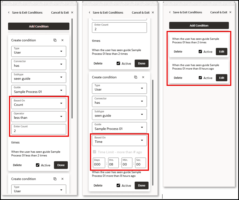

    Below is another example of a cloned step condition that will trigger when a User has seen a particular guide based on Count (less than 2 times) and Time (8 hours apart):
    Count Time

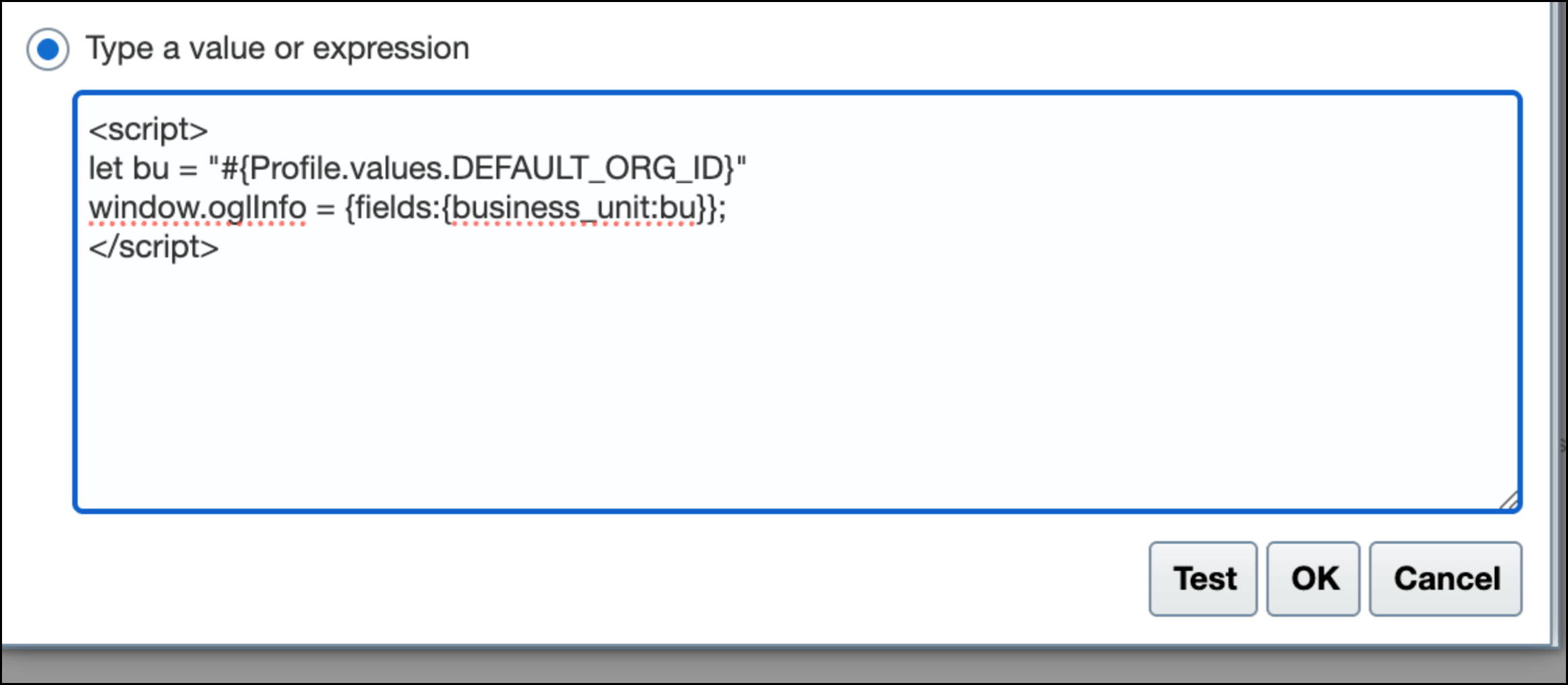

How to configure Country Segmentation
To configure Country Segmentation, you will need to add the following code to the custom script in Fusion:
window.oglInfo = {fields:{user_country:"#{Profile.values.FND_TERRITORY}"}};
Step 1: Create Sandbox
The first step is to create a sandbox so that the global page template can be updated.
Please make sure you don’t have any active sand box.
  1. Select Navigator and select “Sandboxes” under Configuration.
    Sandboxes
  2. Click the “Create Sandbox” button. Enter the “Sandbox Name” and optional description.
    Create Sandboxes
  3. Select “Page Composer” ,“Page Template Composer” and “Guided Learning” from All Tools.Select “Create and Enter”.
    Page Composer
Step 2: Customize Global Page Template
  1. Select the dropdown under the username and select Edit Global Page Template.
  2. Select the View button and then Design.
  3. Select the Edit icon next to HTML Markup.
    HTML Markup
    If you are not able to select Design you may need to enable the Administrator Profile Value: FSM > Manage Administrator Profile Values > FND_PAGE_COMPOSER_SOURCE_VIEW > Set to “Yes.
  4. On the Component Properties pop-up, select the Edit icon next to the Value field and then Expression Builder.
    Expression Builder
  5. Copy and paste the JavaScript into the “Type a value or expression” field. Select OK.
    Please contact your Guided Learning Delivery Point of Contact for JavaScript.Script to be updated:
    <script type="text/javascript">
    </script>
    Expression Editor
  6. Select Apply button then OK.
    Apply
Step 3: Activate Sandbox
  1. Select the hyperlinked sandbox name and then “Publish”
    Publish
    Publish OK
  2. Select Publish.
    Publishh
  3. Select Continue to Publish on the Warning pop-up.
    Continue to Publish
  4. You may need to log out and then log back in to view the widget.

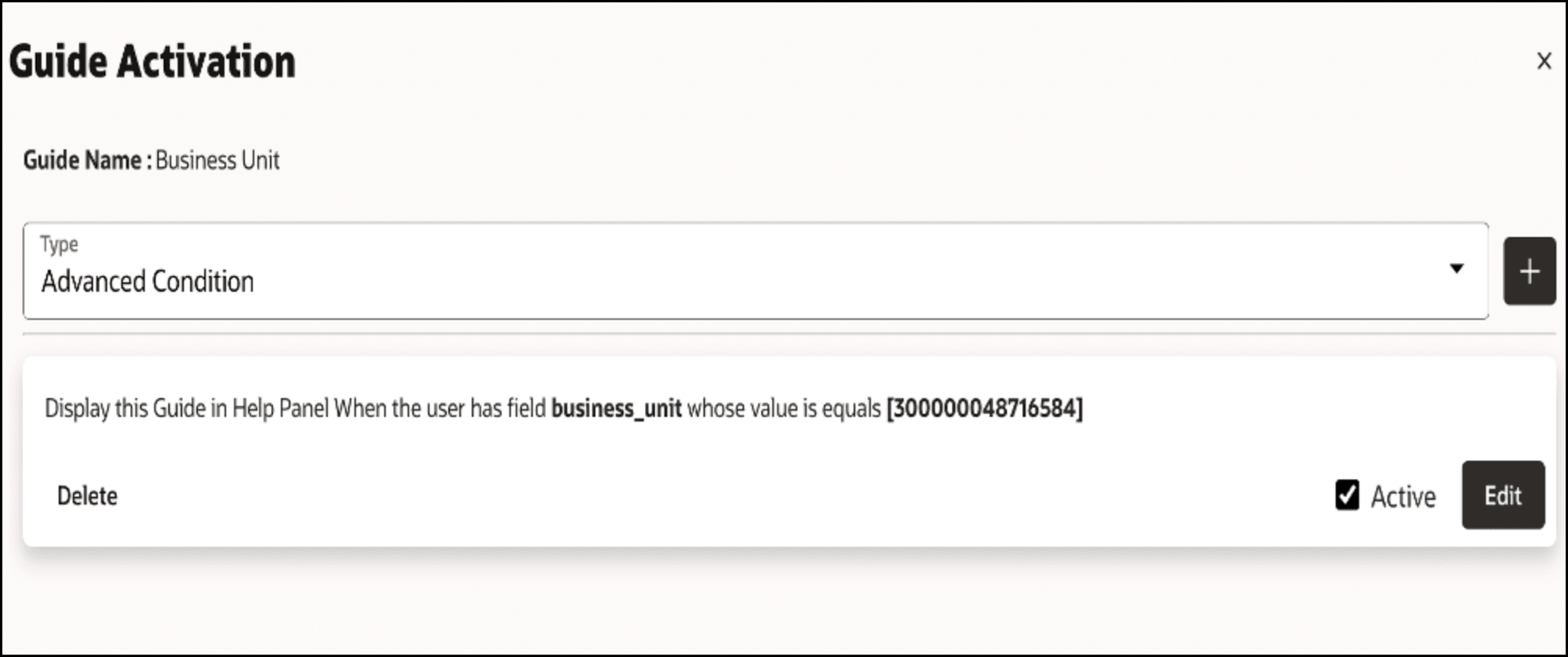

Enabling Country Segmentation in Guide Activation conditions
Now that you have configured Country Segmentation in Fusion, you can now reference the 'user_country' field in Advanced Conditions.
  1. From the My Content page, select Activation from the bottom of the guide tile:
    Activation
  2. In the Guide Activation modal, select Advanced Condition from the Type dropdown menu, then select the Add ( add icon) button.
    Activation Type
  3. In the Create condition section, set the following parameters:
    • Type = User
    • Connector = has/has not
    • Subtype = field
    • Name = user_country
    • Operator = Equals
    Enter Operand value = 'enter a country or territory value' (For example: US for United States of America)
    Check Display in Help Panel and/or Autoload, as needed.
    Guide Activation
    For multiple countries/territories, you can use a vertical pipe ( | ) symbol to separate each value.
For information on how to enable Guide Activation conditions, refer to the following OGL User Guide topic:
https://docs.oracle.com/en/education/customer-success/guided-learning/user-guide/creating-ogl-content.html#GUID-D53AB2B2-98E7-4090-A08C-B0741FB0263A

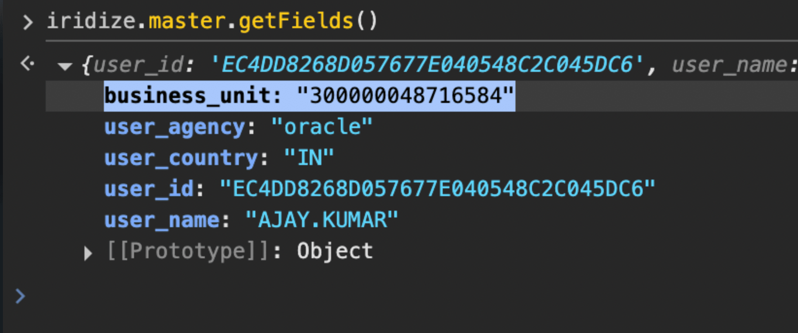

How to Configure Business Unit Segmentation
Perform the following steps to configure business units:
  1. Get the profile option from https://docs.oracle.com/en/cloud/saas/financials/24b/faipp/set-the-default-business-unit-profile-option.html
  2. Add a custom script in fusion expression builder.
    Add a Custom Script
  3. Check if the default business unit is working as expected.
    Default Buss Unit
  4. Once this script is added and verified, now the Default business unit can be used to segment guides.
    Business Unit
