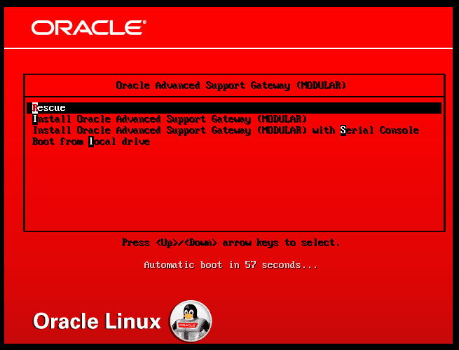

  1. Boot the server with the ISO image.
    A screen similar to the one shown below appears.
    image:Graphic showing gateway installation options
    By default, Rescue option will be selected. To proceed, move the selection down to Install Oracle Advanced Support Gateway (MODULAR).
  2. To start the installation process, choose the default option, Install Oracle Advanced Support Gateway (MODULAR).
