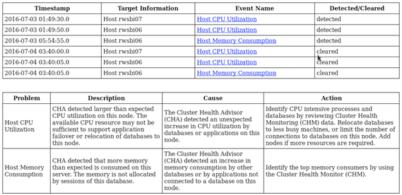

Here is an example of what the output looks like in the HTML format.
$ chactl query diagnosis -start "2016-07-03 20:50:00" -end "2016-07-04 03:50:00" -htmlfile ~/chaprob.html
Figure 4-5: Cluster Health Advisor Diagnosis HTML Output
Description of image follows
