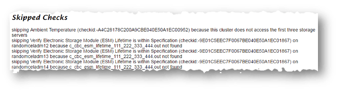

When Oracle Orachk and Oracle Exachk run commands, a child process is spawned to run the command and a watchdog daemon monitors the child process. If the child process is slow or hung, then the watchdog kills the child process and the check is registered as skipped:
Figure 8-1: Skipped Checks
The watchdog.log file also contains entries similar to killing stuck command.
