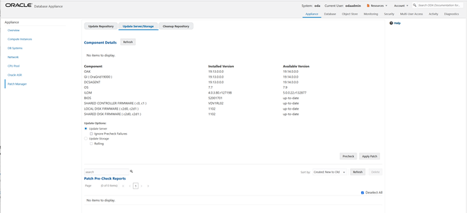

Before you start patching the server, you can check the current installed components from the web console. Go to the Appliance tab, click on Patch Manager on the left, and then click the Update Server/Storage tab. Note all the installed 19.13.0.0.0 components. Since you have not updated the repository to 19.14.0.0.0, all components are displayed as up to date.

}After you update the repository, you can use the web console to see the 19.14.0.0.0 available component versions.
