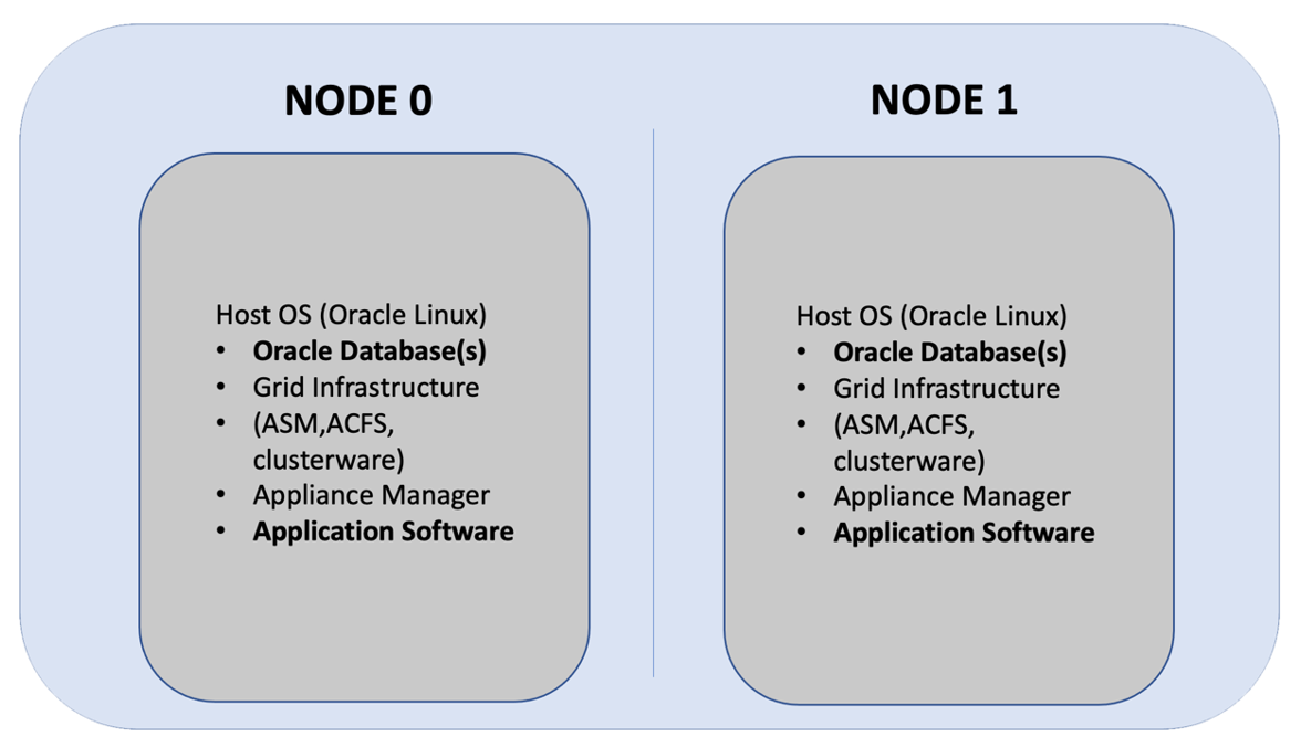

Application and Database installed in bare metal system
This option is only applicable for a few applications which do not interfere with the database software and operating system installation. One supported example is the Oracle Enterprise Manager software.

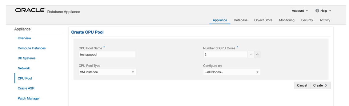

Create a CPU pool to specify how many CPU cores your KVM should use. This CPU pool is later assigned to the KVM guest machine.
In the Browser User Interface (BUI), in the Appliance tab, navigate to the Create CPU Pool page and specify the CPU Pool Name, Number of CPU Cores, and select the CPU Pool Type as VM Instance.
ODACLI command for creating a CPU pool:
# odacli create-cpupool -n testcpupool -c 2 -vm

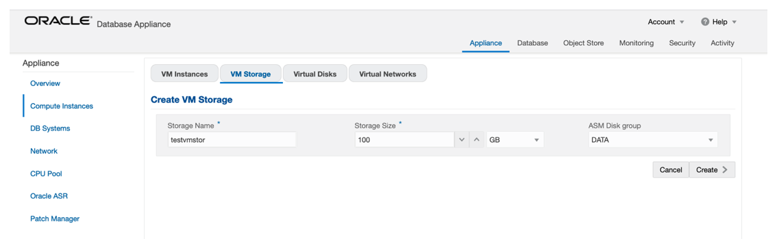

Step 2: Create VM Storage
In the Appliance tab, select Compute Instances, and then navigate to the Create VM Storage page and specify Storage Name, Storage Size, and ASM Disk group. Click Create.
ODACLI command for creating VM storage:
# odacli create-vmstorage -n testvmstor -s 100G -dg DATA
Note that the default value of -dg
is
DATA.

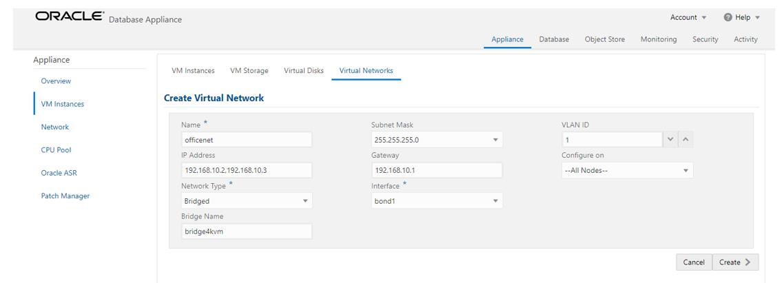

Step 3: Create a Virtual Network (if required)
Any VM
that needs to access the public network must be attached to the
pubnet virtualnetwork. No bridged network other than the default
pubnet bridge is allowed to be created on the public network
interface. Additional bridged vnetwork (public network without
tagged VLAN configuration) can be created on other interfaces that
are not used for the public network. It is not mandatory to assign
IP addresses to the bridge. IP addresses are only required if
communication between the bare metal system host and the KVM guest
is desired. When two IP addresses are assigned to a
high-availability machine, the first will be assigned to the bridge
on node0
and the second IP address to
node1
ODACLI command for creating a virtual network:
# odacli create-vnetwork –name officenet –bridge bridge4kvm –type bridged –interface bond1 –ip xx.xx.xx.xx –gateway xx.xx.xx.xx –netmask xx.xx.xx.xx

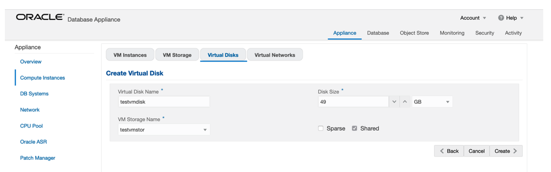

Step 4: Create Virtual Disk (if required)
During the VM creation, a VM disk is created to host the operating system. If additional disks are required ,you must create them in advance. Using virtual disks provides better control over the storage layout of your VM.
ODACLI command for creating a virtual disk:
# odacli create-vdisk -n testvmdisk -vms testvmstor -s 49G -sh

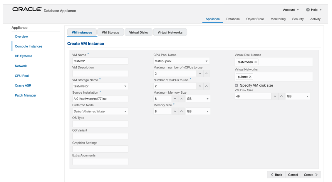

Step 5: Create the VM Instance
To create the VM go to ‘VM Instances’ and ‘Create VM’. Type in the mandatory information for your VM plus the additional configuration you would like to use for your VM guest. Mandatory information is the ‘VM name’, ‘VM Storage Name’, the path to the application to install, under ‚Source installation‘. You have as well to define how many CPUs and how much memory to use for the VM. If you have created a CPU Pool a Virtual Disk or a Virtual Network, select them into the respective fields. Specify the size of the OS disk to be created for your VM guest in “VM Disk Size”. If you need your VM to access the DB System via the pubnet, make sure ‘pubnet’ is selected in the ‘Virtual Networks’.
VM Instance page and specify VM
Name and VM Storage Name.
Specify the path for the installation of application in the
Source Installation field. Define the
Number of vCPUS to use and the
Maximum Memory Size for the VM. If
you have created a CPU pool, virtual disk, or virtual network, then
specify their names. Specify the operating system disk size to be
created for your guest VM in the VM Disk Size
field. To ensure that your VM can access the DB system through the
pubnet, select pubnet
in the Virtual
Networks field. Click
Create.

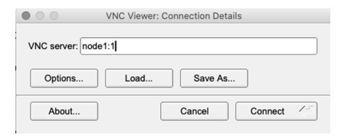

Step 7: Connect to the Oracle Database Appliance bare metal system node using VNC
vncserver
command.# vncserver
perl: warning: Setting locale failed.
perl: warning: Please check that your locale settings:
LANGUAGE = (unset),
LC_ALL = (unset),
LC_CTYPE = "UTF-8",
LANG = "en_US.UTF-8"
are supported and installed on your system.
perl: warning: Falling back to the standard locale ("C").
You will require a password to access your desktops.
Password:
Verify:
Would you like to enter a view-only password (y/n)? n
A view-only password is not used
xauth: file /root/.Xauthority does not exist
New 'node1:1 (root)' desktop is node1:1 VNC port
Creating default startup script /root/.vnc/xstartup
Creating default config /root/.vnc/config
Starting applications specified in /root/.vnc/xstartup
Log file is /root/.vnc/node1:1.log
Use a VNC client of your choice and connect to
host:vncport
(the host is your Oracle
Database Appliance bare metal system, the VNC port is from the
vncserver
command).

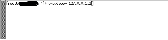

The command prompt in the VNC viewer of type
vncviewer 127.0.0.1:2
is displayed. Note
that this Display Port: 127.0.0.1:2 is the same as displayed in the
odacli describe-vm
output.

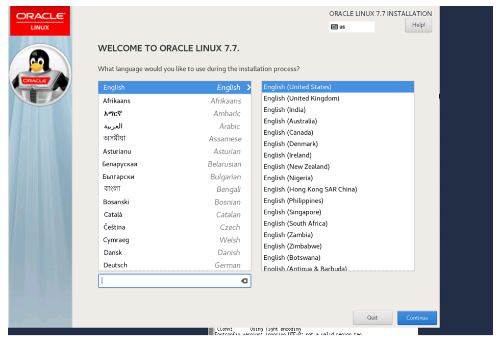

Step 8: Complete the installation process
Select the language:

Step 1: Create a VM CPU Pool (Optional step, required only for cases when you need dedicated CPU resources for the Windows VM)
# odacli create-cpupool -n winvmcpupool -c 2 -vm
# odacli create-vmstorage -n winvmstor -s 100G -dg DATA

Step 7: Connect to the VM guest machine using VNC
Use
host:vncport
vncserver
command).
is displayed. Note
odacli describe-vm
output.

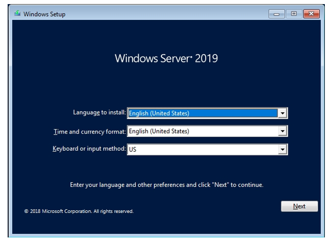

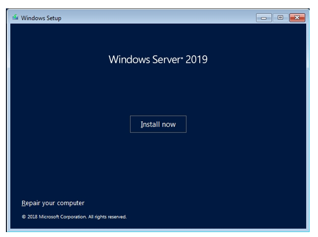

Step 8: Complete the Windows operating system installation
Select the configuration details.
Provide the required values and navigate through the installation setup.

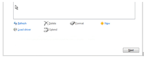

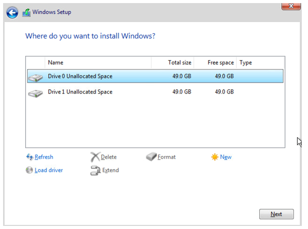

When prompted Where do you want to install Windows?, select Load driver.

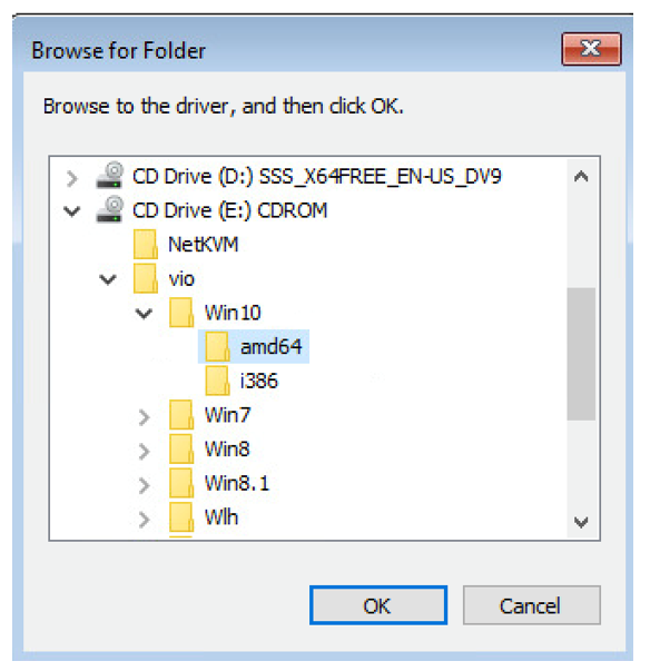

Navigate to the VirtIO driver on E:
CDROM
drive.
In the vio/Win10/amd64
directory,
select viostororcl.inf
from the list.
After loading the driver, the pre-created virtual
disk and the extra virtual disk (winvmdisk
) is
displayed. Select the pre-created virtual disk and continue with the
installation.

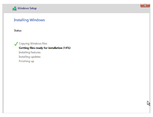

Review the progress of the installation.

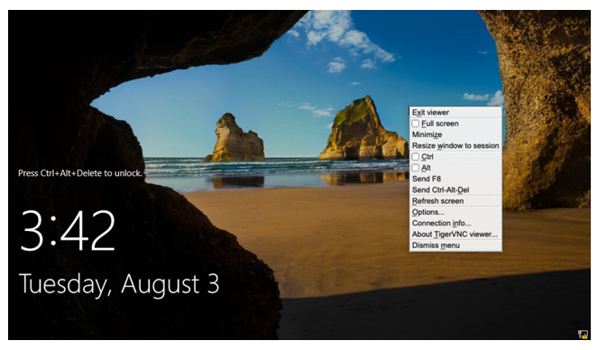

To run Ctrl+Alt+Delete in the Windows operating system, click inside the Windows screen and press the F8 key. On a Mac, press Fn+F8.

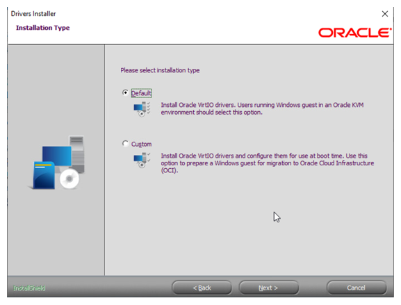

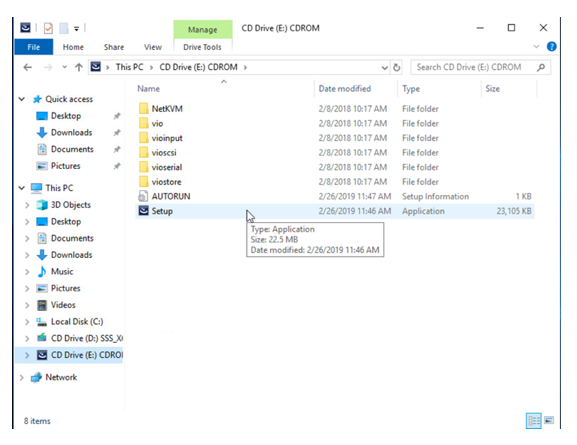

Step 9: Install the VirtIO drivers by running Setup from the CDROM drive E:
Navigate through the installation setup.
Select the default option.

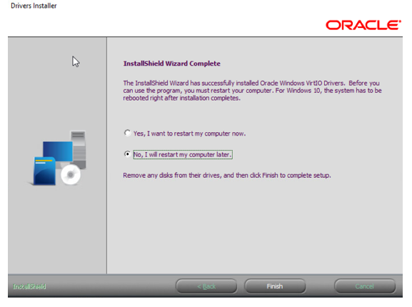

When prompted, do not select to restart the computer.

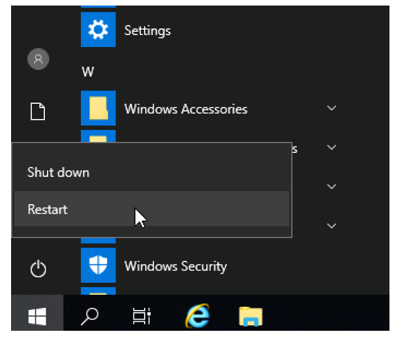

Restart the computer from the Windows Start menu.

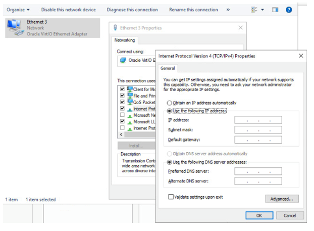

Connect to your guest VM using VNC and configure it according to your needs. For example, you can assign a fixed IP address.

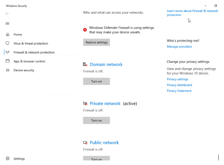

After disabling the Windows firewall, you can ping the bare metal system host IP from the KVM guest machine and vice versa.

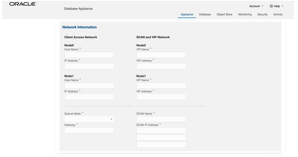

Create the DB System: Network Information
Provide the network information.

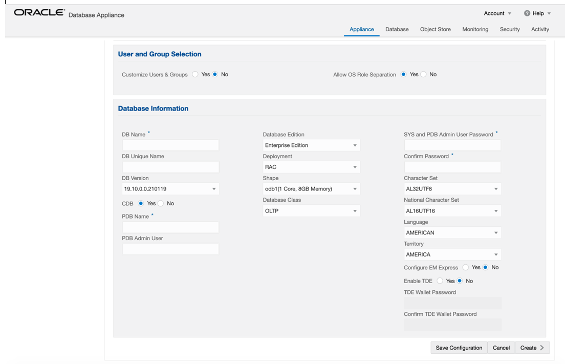

Create the DB System: Users and Groups and Database Information
Customize
users and groups and decide if you want to use operating system role separation. You
must specify the same configuration details for the DB system users and groups as
the configuration details for the Oracle Grid Infrastructure installation on the
bare metal system . If your bare metal system has a user grid
and a
user oracle
, then you are using role separation. You can also
provide information about the database you want to create.

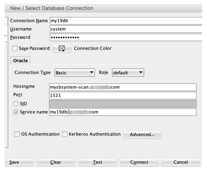

Test the database connection
Test connectivity to your DB System. During creation of the DB system you specified the SCAN name and database name. With this information you should be able to build your TNS connect string using the default service name which is the same as the database name. It is a best practice to create your own database services based on your high-availability requirements. For an initial connection test, the default service is sufficient.
# ssh root@node1n1
# su – oracle
$ export ORACLE_HOME=/u01/app/oracle/product/19.0.0.0/dbhome_1
$ export ORACLE_SID=my19db1 (the ‘1’ after the DB name is for instance 1 on the first RAC node)
$ /u01/app/oracle/product/19.0.0.0/dbhome_1/bin/sqlplus / as sysdba
SQL*Plus: Release 19.0.0.0.0 - Production on Mon Mar 15 08:32:37 2021
Version 19.10.0.0.0
Copyright (c) 1982, 2020, Oracle. All rights reserved.
Connected to:
Oracle Database 19c Enterprise Edition Release 19.0.0.0.0 - Production
Version 19.10.0.0.0
SQL>
