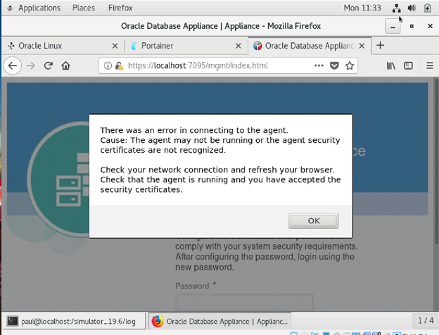

You may encounter a BUI Agent Certificate Issue. See the following example:
https://server IP:7097/mgmt/index.html
Your assigned port number maybe differentYou may see a BUI agent security certificate error message:
To fix it, you must add a certificate exception to the BUI agent port, with is your assigned port number -1. In this case, the port number is 7097-1 or 7096.
https://:7096
( Your port number maybe different)
Go through the certificate exception process and add the exception. Then go back to your assigned port.
https://:7097/mgmt/index.html Go through the certificate exception process again and add the exception. Then you can access the BUI to create the appliance.
