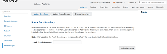

You can also use the Browser-based User Interface (BUI) to update the Oracle Database Appliance repository, by pasting the complete file path of the patch file or even clone file in the patch bundle location box of the patch manager in the web BUI.  However, it is not necessary as you have used command line to update the repository (clone files) already.
Update Patch Repository page in the BUI
