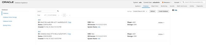

Because we may not want to patch all databases at once, we must first identify which database home corresponds to which database.
To use the BUI to identify the database homes, go to the Database tab.
Databases tab
Click on the database name, for example, db4 to identify the database home ID for patching.

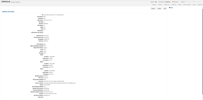

Database Information
Note the Database home ID, or the Database home location.  You will need this to patch the database by pointing it to a home.

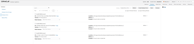

You can also use the GUI web console to update the database homes by clicking Patch on the left panel, and then select Apply in the Patch drop-down.  We have already updated the db4 database by pointing to a new home using the command line already.
