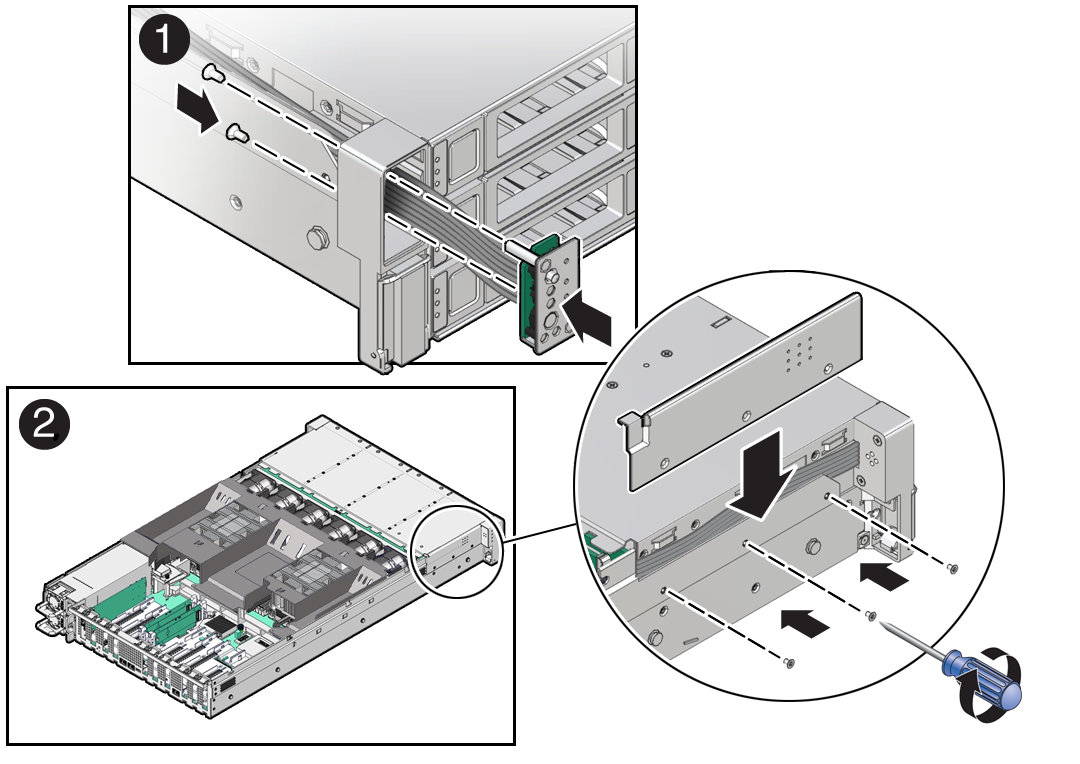

Install the front LED indicator module.
Push the LED indicator module and cable through the LED housing on the server front panel [1].
- Install the LED indicator module cable by carefully pulling the cable through the left-side cable trough.
To ease installation of the LED indicator module cable, you might need to lift the disk backplane auxiliary signal cable and SAS cable (if present) from the left-side cable trough. - Insert and tighten the two No. 2 Phillips screws to secure the LED indicator module to the server front panel [1].
- Install the FIM cable cover to the chassis by inserting it into the FIM cable cover slot [2].
- Install the three No. 2 Phillips screws to secure the FIM cable cover to the chassis [2].

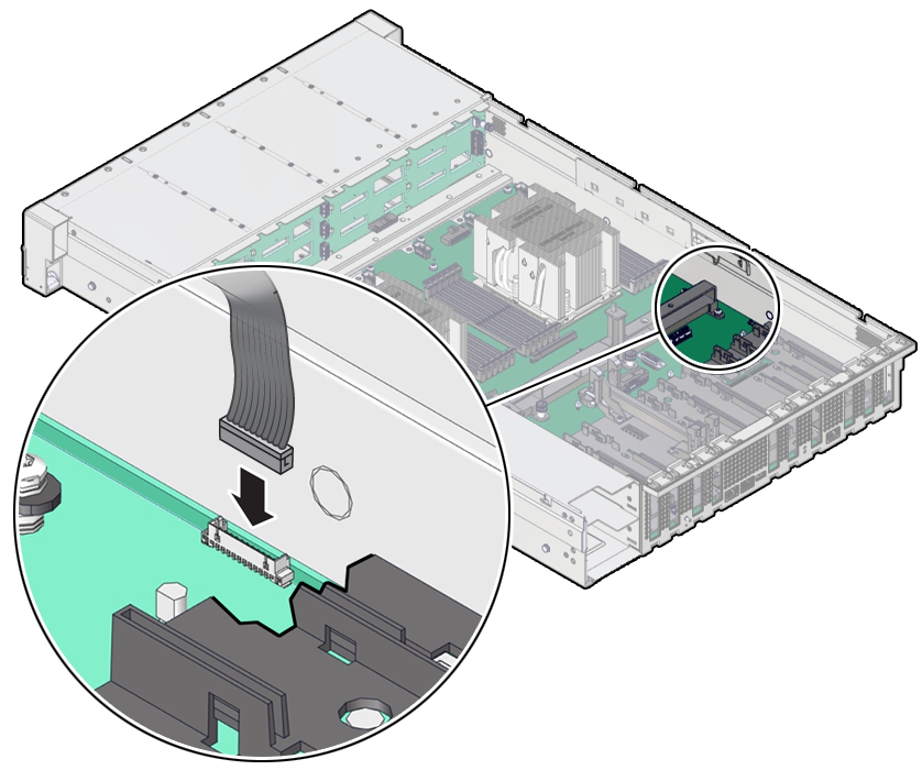

Reconnect the LED indicator module cable to the motherboard.
