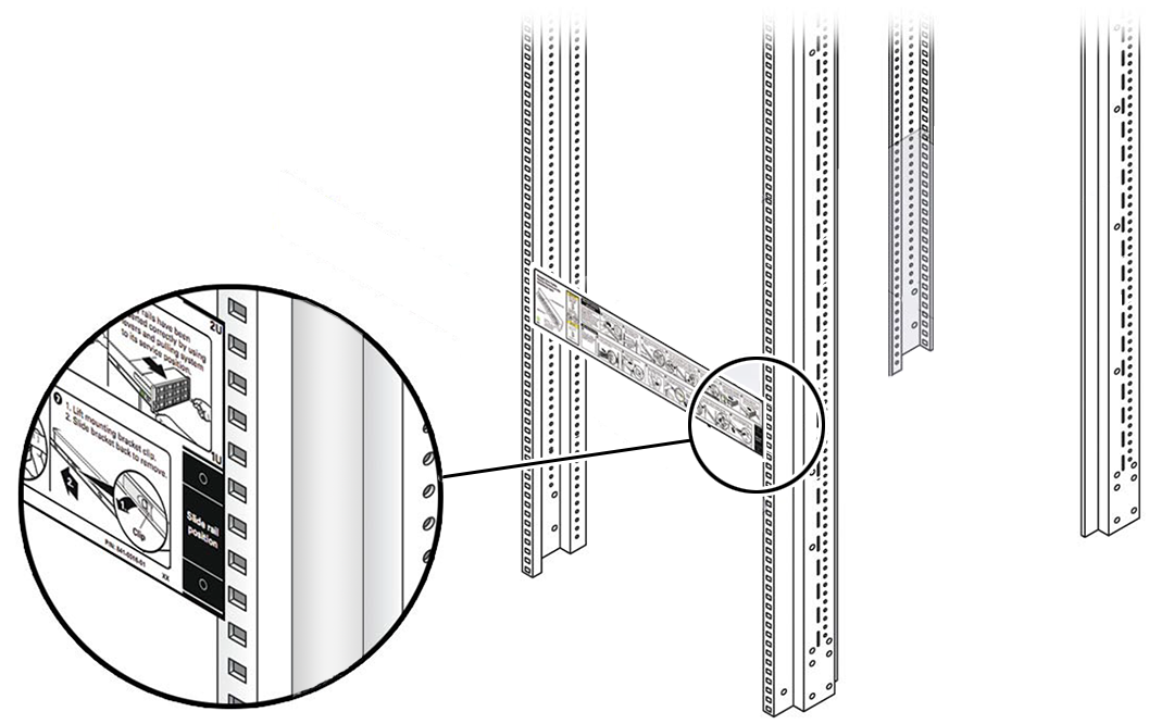

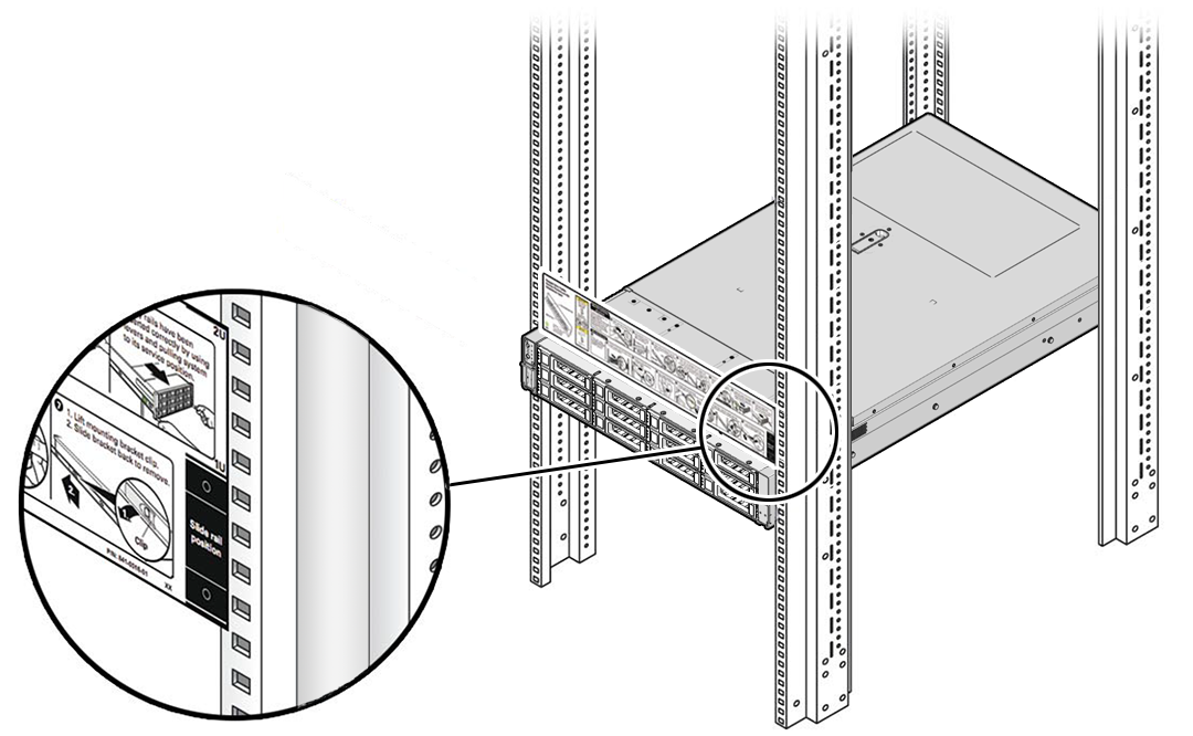

Identify the location in the rack where you want to place the server. Exadata Server X11M requires two rack units (2U). Use the Rackmounting Template to identify the correct mounting holes for the slide-rails.

- Place the Rackmounting Template against the front rails, and measure up from the
bottom of the Rackmounting Template. The bottom edge of the Rackmounting Template
card corresponds to the bottom edge of the server.
- Mark the mounting holes for the front slide-rails.
- Mark the mounting holes for the back slide-rails.
