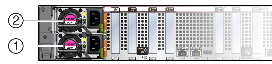

Identify which power supply requires replacement.
Callout Description 2 PS1
Power supply 1
1 PS0
Power supply 0
A lit amber Fault-Service Required LED on a power supply indicates that a failure was detected. You also can use the Oracle ILOM
showfaultycommand at the Oracle ILOM command-line prompt (->) to identify a power supply failure.To list all known faults in the server, log in to the Oracle ILOM Fault Management Shell from the Oracle ILOM service processor and issue the
fmadm faultycommand. Alternatively, log in to Oracle Solaris and issue thefmadm faultycommand (Solaris root privileges required). For more information about how to use the Oracle ILOM Fault Management Shell and supported commands, refer to the Oracle ILOM User's Guide for System Monitoring and Diagnostics at Oracle ILOM Documentation.Note:

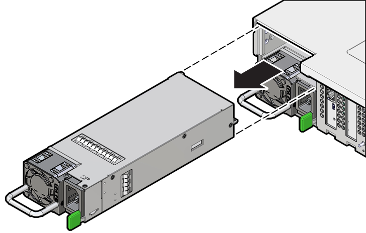

Grasp the power supply handle and push the power supply latch to the left.
Open the power supply handle if the handle is folded flush. Open the velcro straps if present.
Pull the power supply out of the chassis.
Caution:
When you remove a power supply, be sure to replace it with another power supply within 60 seconds; otherwise, the server might overheat due to improper airflow. - Continue to Install a Power Supply.
