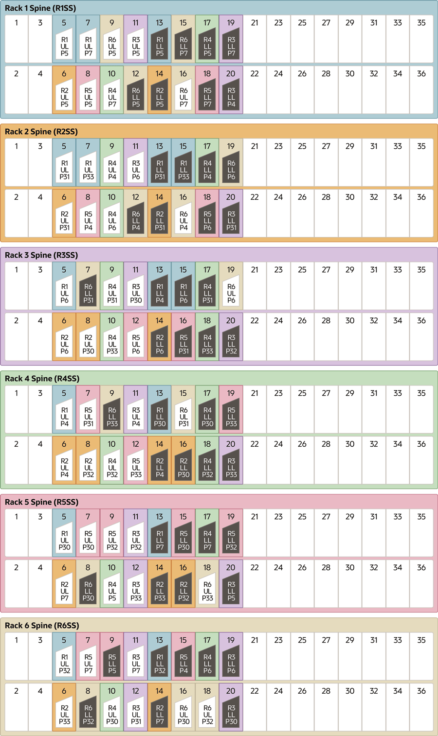

The following illustration shows the cable connections for the 6 spine switches when cabling six racks together:
