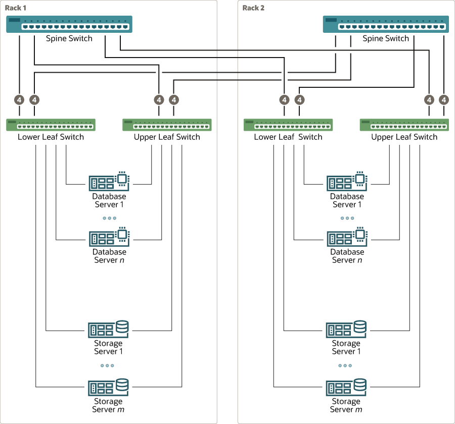

When connecting up to eight racks together, remove the eight existing inter-switch connections between each leaf switch on each rack. From each leaf switch, distribute eight connections over the spine switches in all racks. In multi-rack environments, the leaf switches inside a rack are no longer directly interconnected, as shown in the following graphic:
As shown in the preceding graphic, each leaf switch in rack 1 has the following connections:
Four connections to its internal spine switch
Four connections to the spine switch in rack 2
The spine switch in rack 1 has the following connections:
Four connections to each leaf switch in rack 1
Four connections to each leaf switch in rack 2

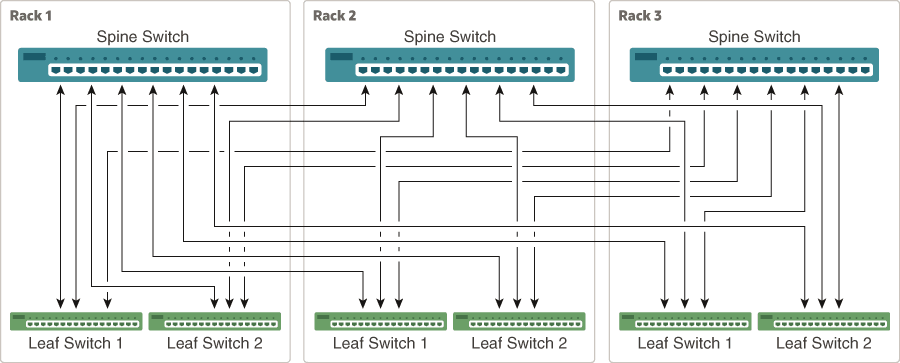

As the number of racks increases from two to eight, the pattern continues as shown in the following graphic:
Figure 23-1: Connections Between Spine Switches and Leaf Switches for up to 8 Racks
Description of the illustration connections-leaf-and-spine-switches-8-racks.png
As shown in the preceding graphic, each leaf switch has eight inter-switch connections distributed over all spine switches. Each spine switch has 16 inter-switch connections distributed over all leaf switches. The leaf switches are not directly interconnected with other leaf switches, and the spine switches are not directly interconnected with the other spine switches.
