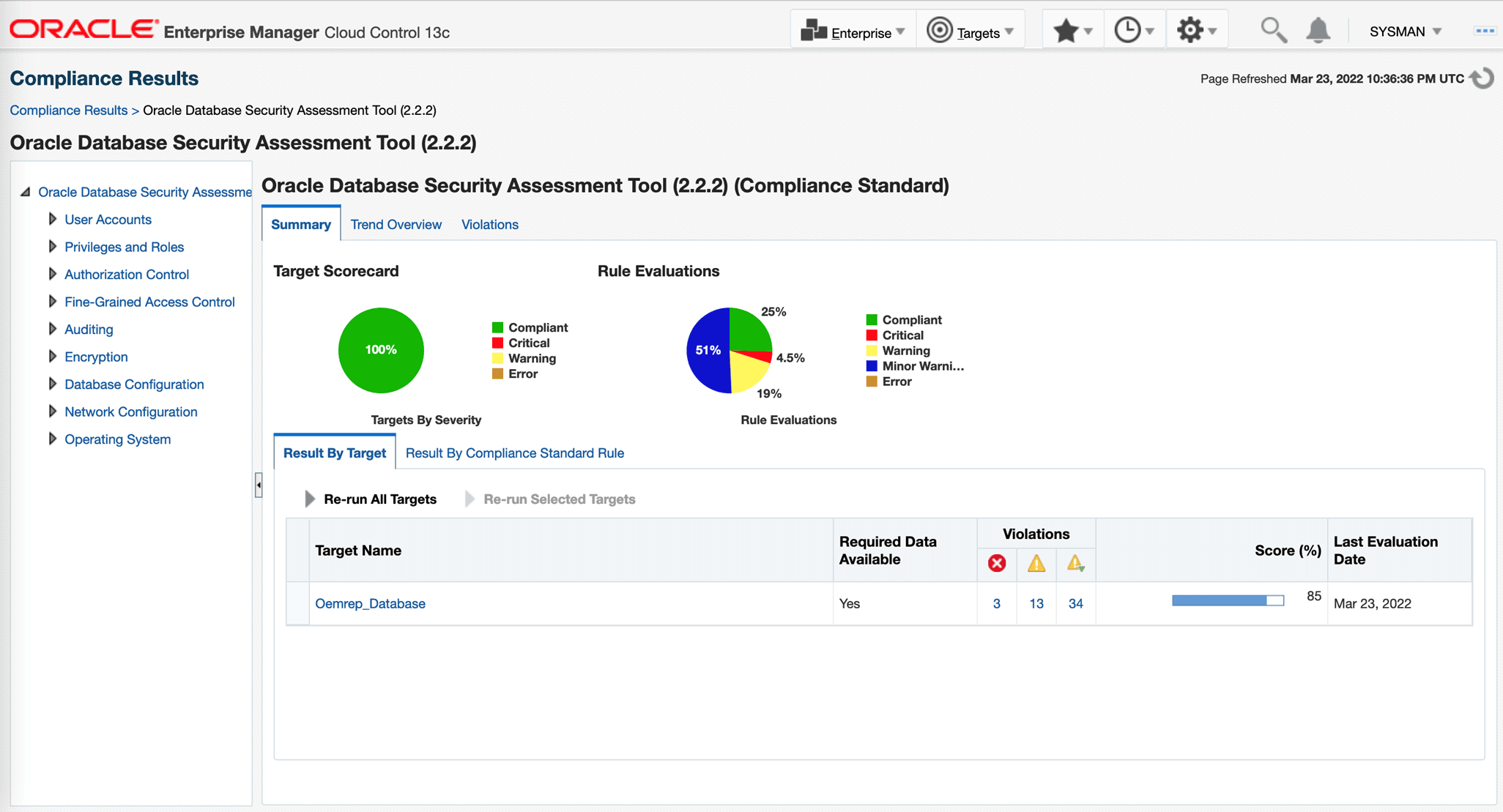

You can review the compliance information collected by Oracle DBSAT under Compliance Results, by navigating to Database Security Assessment Tool. Here the information collected is presented in an easy to read template within Enterprise Manager. Showing Scorecard, Rule Evaluation, Target Violations, Targets and Evaluation Date.
Figure 24-1 DBSAT Compliance Standard Overview

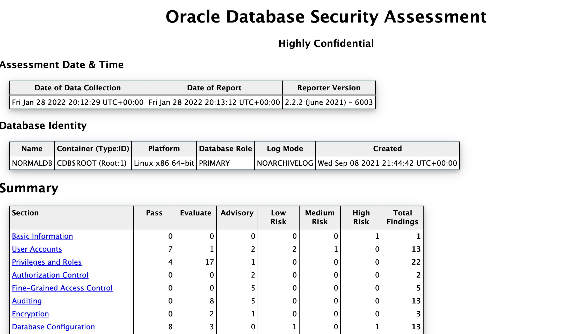

Figure 24-3 Oracle Database Security Assessment Report
Report detailing DBSAT compliance violations

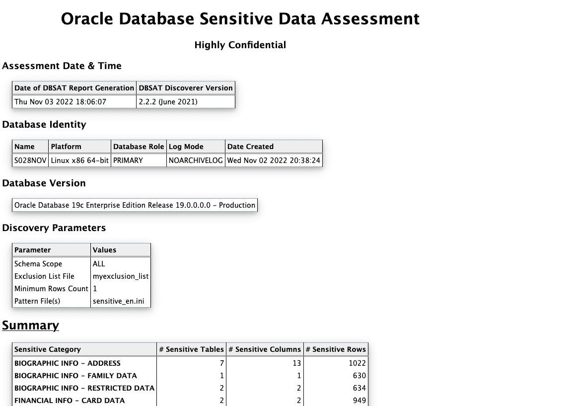

Figure 24-4 Oracle Database Sensitive Data Assessment
Oracle Database Sensitive Data Assessment report details

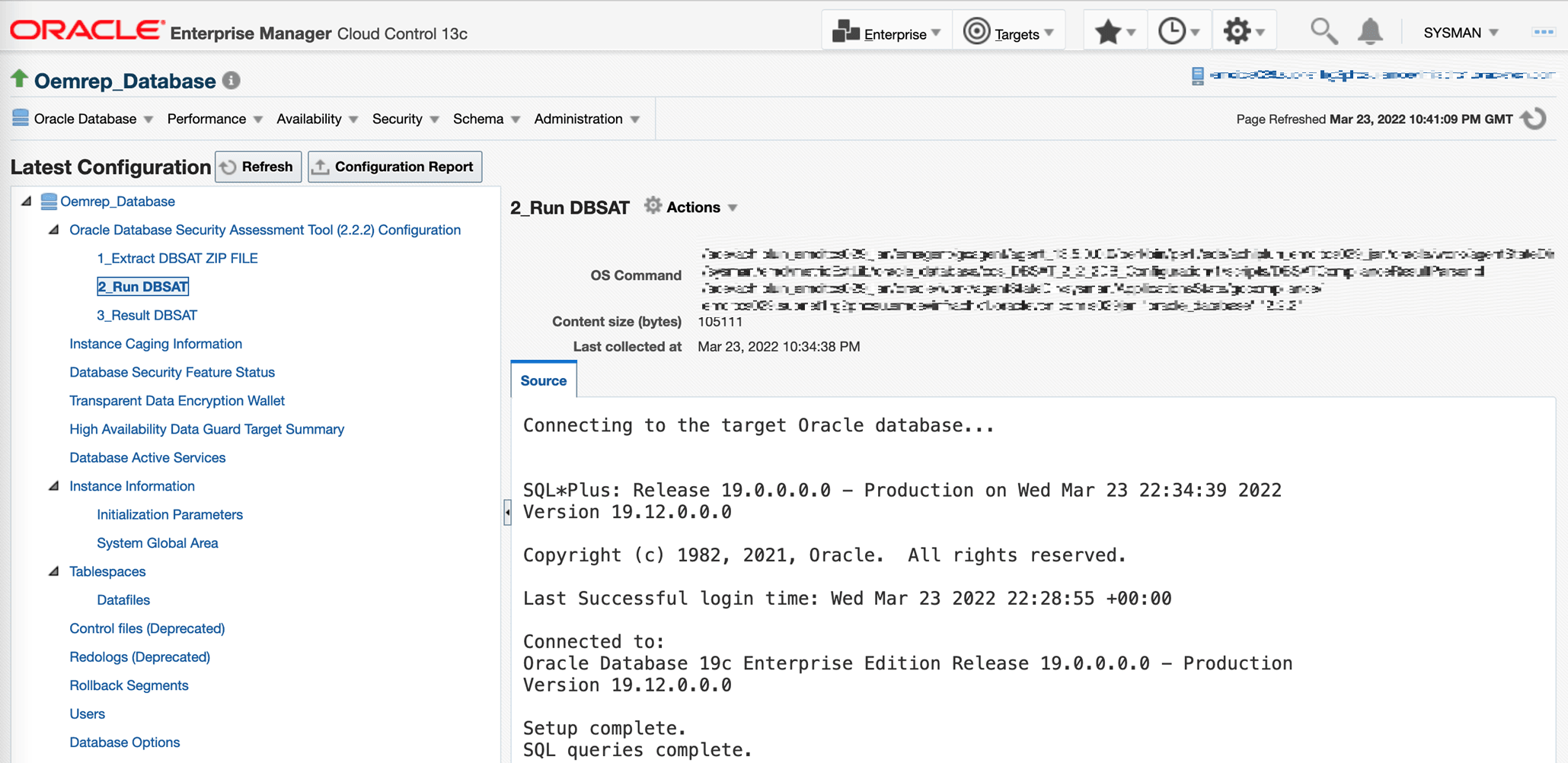

    • Verify Run DBSAT settings:
      1. From the Targets menu, select Databases. On the Databases page, select Database Name.
      2. On the selected Database page, go to the Oracle Database drop down menu, select Configuration, then select Latest.
      3. On the Database page with Identity Latest Configuration, click on Database, select Oracle Database Security Assessment Tool (2.2.2) Configuration then select 2_Run_DBSAT. This shows the current run execution of DBSAT any errors will be listed here.
      Figure 24-5 Run DBSAT Settings
      Run DBSAT Settings

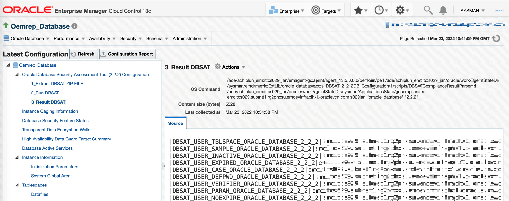

    • Verify DBSAT Result settings:
      2. On the selected database page, go to the Oracle Database drop down menu, select Configuration, then select Latest.
      3. On Database page with Identity Latest Configuration components, click on Database, select Oracle Database Security Assessment Tool (2.2.2) Configuration then select 3_Result_DBSAT. If the Source field is blank, DBSAT execution failed to generate valid results. Check the errors displayed in Run DBSAT for possible remediation.
      Figure 24-6 DBSAT Results Settings

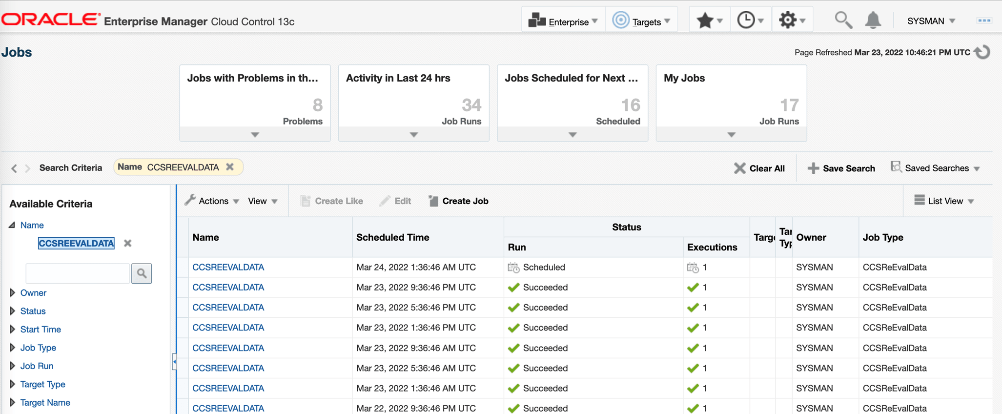

  • DBSAT data is sent by the DBSAT target every 24 hours. This data is collected in a central store by the management server as it arrives from each target. The Compliance Evaluation is performed every 4 hours by referring to the latest DBSAT data available in the central store at that time. To verify that the jobs are running properly go to Enterprise, then Job and click on Activity. On Jobs Page, in the Available Criteria components panel, select Name and Search by entering value CCSREEVALDATA, information will show targets with their respective associated standards. If there are none or missing, reassociate targets to their respective standards.
    Figure 24-8 DBSAT Job Overview
    DBSAT Job Overview
