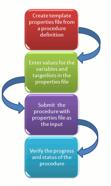

Creating the Properties File to Submit a Deployment Procedure
This graphic illustrates how to create a template properties file, update values into the file, and then submit the procedure with the updated properties file as the input.
Creating a Properties File for a Deployment Procedure
  1. Create Template Properties File From a Procedure Definition.
    All the details required for the selected Deployment Procedure like variable names, targets, credentials, and so on are provided in this step to successfully submit the procedure from the command line. Generating the Properties file is a two-step process as follows:

  2. Entering New Values in The Properties File
    Use any editor to open the properties file and enter values against the names. After updating all the fields, save and close the properties file.
    The main goal of this step is to create a library of property files where the most common input values have been set as defaults, this in turn reduces the chances of operator errors, and also reduces the number of inputs expected from the operators.

  3. Submitting the Procedure With The Updated Properties File as Input
    After the properties file is ready with the correct name-value pair required to run the Deployment procedure, you must use the EM CLI verb submit_procedure, which accepts the edited properties file as the input.

  4. Verify The Status Of the Procedure
    The final step lets you to track the progress and status of the procedure. This is especially important since the submit procedure verb does not wait for the completion of the Deployment Procedure:
