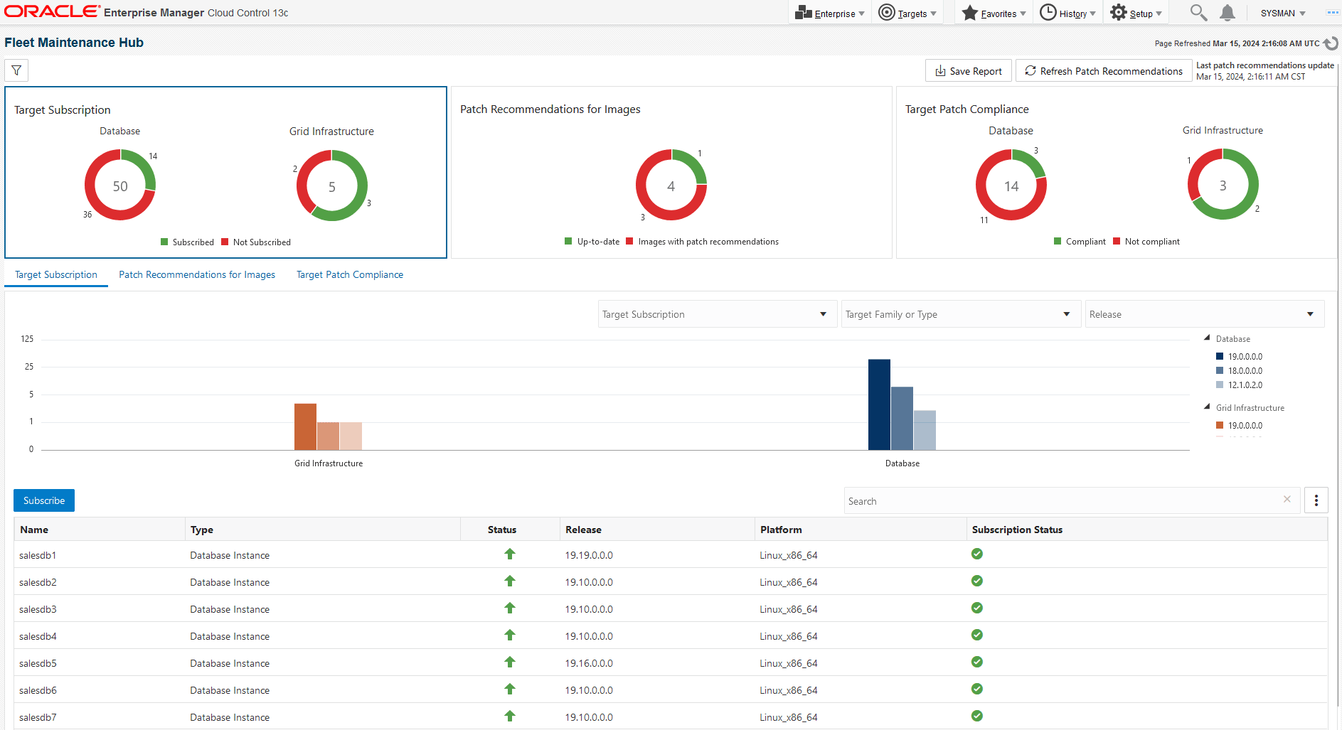

Figure 18-1 Fleet Maintenance Target Subscription
Fleet Maintenance Hub main screen showing the Target Subscription tab
The central section of the Target Subscription tab, shows two different sets of bar graphs, each set denoting release specific unsubscribed databases and Grid Infrastructures. By clicking on any bar, the table below the graph will show databases and/or Grid Infrastructure running on that release and not subscribed to any particular image.
You can further filter and refine the available data, by using the following filtering criteria: Target Type or family (database or Grid Infrastructure), Release (filter by version), and a text field to search by database name.
In order to subscribe a database to a image, it is recommended that you have already identified the image to subscribe the database to.

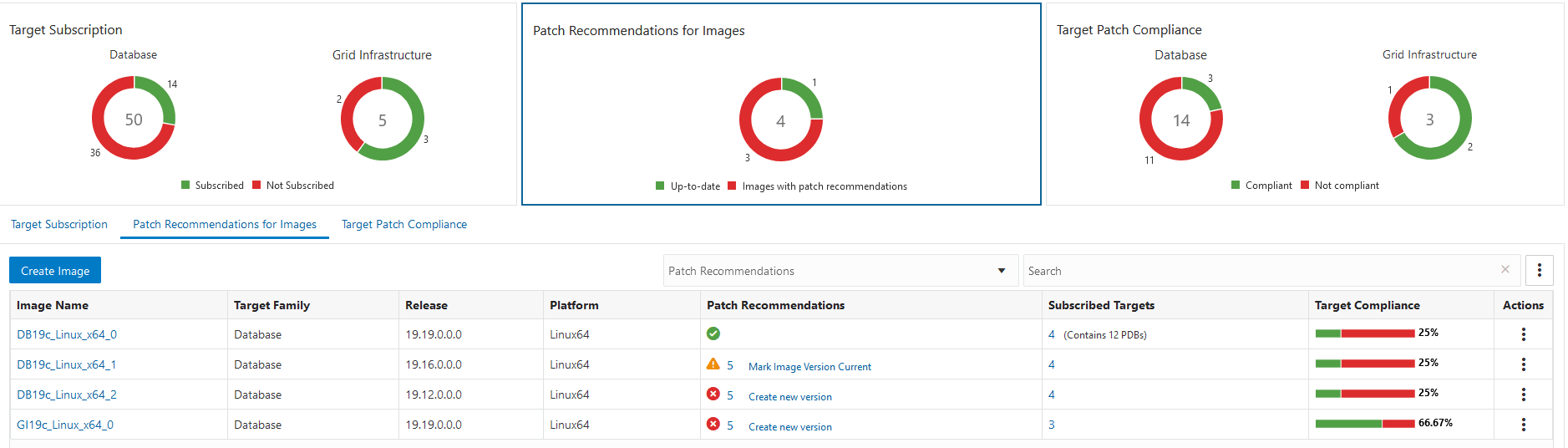

Patch Recommendations for Images
Figure 18-3 Patch Recommendations for Images
Patch Recommendations for Images Tab
The second tile shows patch recommendations (Oracle published patch recommendations and additional one off patches) for already existing images. The pie chart allows you to see up to date images, and images with pending patch recommendations to be applied. Click on the image to view its details in the table (below the pie chart) form with the following fields:
If you have recently subscribed or unsubscribed a target, run a Refresh Path Recommendations before selecting Patch Recommendations for Images to ensure the latest target information details are pulled.
  • Image Name: Name of the Gold Image, by clicking on it a pop-up will appear with image details.
  • Release: Release version to which the image has been created (eg. Oracle Database 19.0.0.0.0, 21.0.0.0.0, 23.0.0.0.0, 23.26.0.0.0).
  • Platform: Platform operating system which was used to create the image, (eg. Linux x86-64).
  • Target Type: Whether the image is for database or Grid Infrastructure.
  • Patch Recommendation: This column indicates the health of the image.
    • A green check mark indicates that the current version of the image has all the required latest recommended patches published by Oracle, as well as additional one off patches. The image is in good shape and you should use this image to perform update or upgrade operations.
    • A yellow exclamation mark indicates that one of versions contained in the image has all the required latest recommended patches published by Oracle, but it is not marked current. Only current versions can be deployed. An administrator role is required to change the version of the image to CURRENT.
    • A red X mark indicates that no version contained in the image contains all the latest recommended patches. The administrator has to create a new version including the recommended patches and mark it CURRENT.
  • Subscribed Targets: Shows details about the targets subscribed to the particular image. Click on the numeric to see more details about the targets that are subscribed to the image.
  • Patch Compliance: This linear graph shows how many of the subscribed targets are on the current version. If you see any targets in red, this indicates that they are not on the current version of the image and need to be updated.
  • Action: You can perform image management and update/upgrade operations on the subscribed targets from this menu.
Images created directly in FPP and synced with Enterprise Manager will lack information about bugs fixes included in the image, impacting patch recommendations for these images. Oracle recommends creating the FPP images using Enterprise Manager to avoid this issue with patch recommendations.

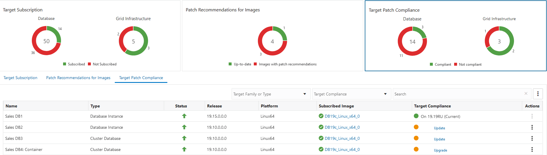

Target Patch Compliance with Images
Figure 18-4 Target Patch Compliance with Images
Target Patch Compliance with Images Tab
In the Target Patch Compliance with Images chart, you can see compliant targets and non-complaint targets. Click on any section of the chart, and this will populate the grid accordingly. The table will show the following information:
  • Name: Target name of the database or Grid Infrastructure.
  • Type: Type of target, database or Grid Infrastructure.
  • Release: Release version to which the target has been created (eg. Oracle Database 19.0.0.0.0, 21.0.0.0.0, 23.0.0.0.0, 23.26.0.0.0).
  • Platform: Platform operating system which was used to create the target, (eg. Linux x86-64).
  • Subscribed Image: Image name to which this target has been subscribed. Click on the image name to see details about the image.
  • Patch Level: Will show the patch status for a target, the following is a list of possible statuses:
    • If the target is on a current version it will show as Current and green.
    • If the target has additional patches pending it will show Drifted and yellow.
    • If outdated it will show the name of the Image Version it is on and will show as red.
  • Action: Launches the UI to start the update operation.

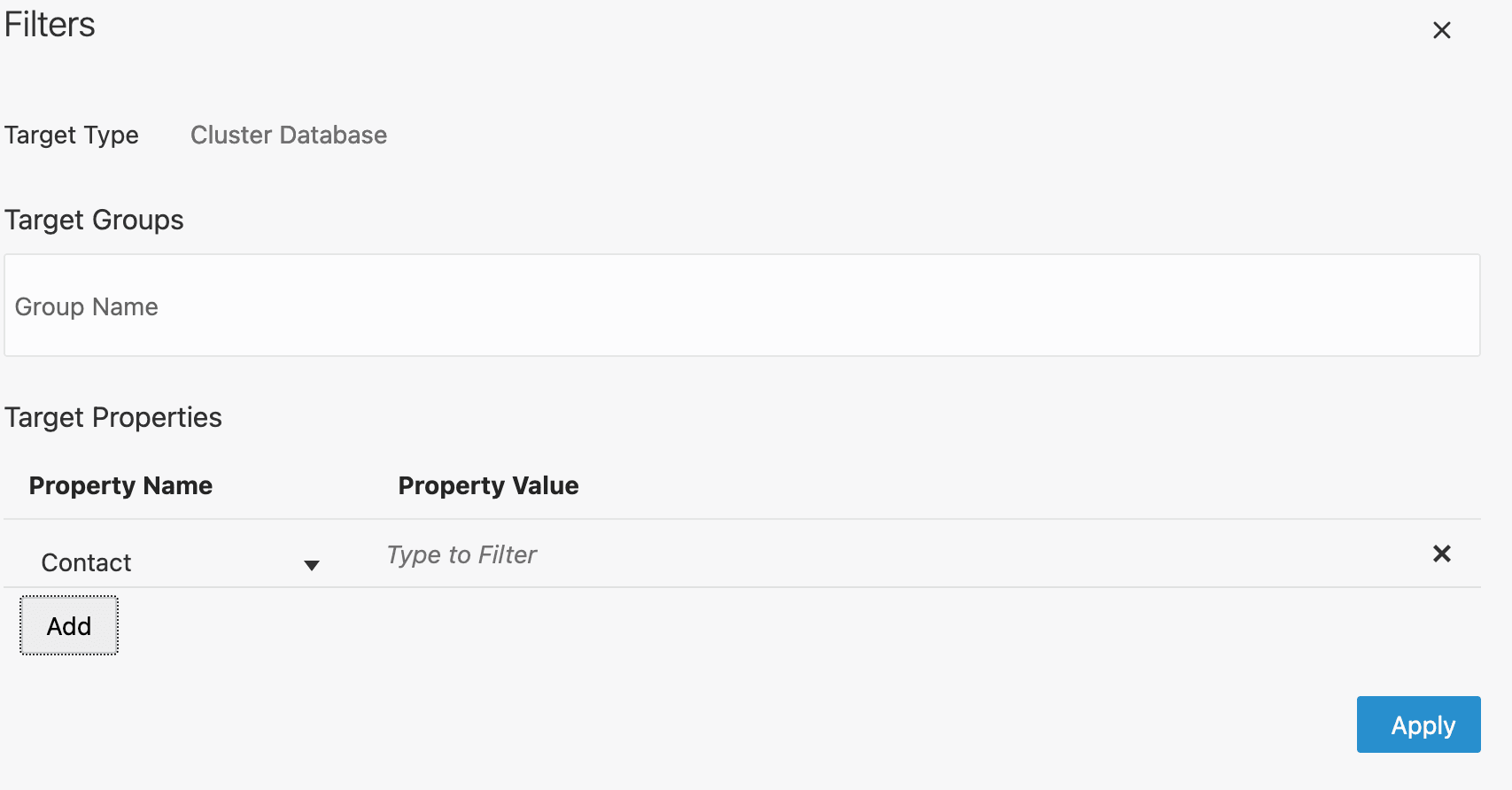

Use Global Filters To Find Databases
Starting with Enterprise Manager 24.1ai Release Update 2 (24.1.02) you can use Global Filters in Fleet Maintenance both in the Hub and patch Operator Wizard. Filter a search by with target family, target type Global Filters, with Enterprise Manager user pre-defined Target Groups (both static and dynamic), and by Target Properties. Once the filters are applied you can quickly find and visualize the databases that require fleet maintenance actions.
Global Filters optionsTo apply Global Filters, Target Groups and Properties click on the filter Icon located at the top left corner of the Fleet Maintenance Hub page, this will open the Filters slide-out. Select all filtering options and click Apply.
The filters that have been applied can now be viewed in the Global Filters bar at the top of the Fleet Maintenance hub page, the databases will be filtered accordingly.
