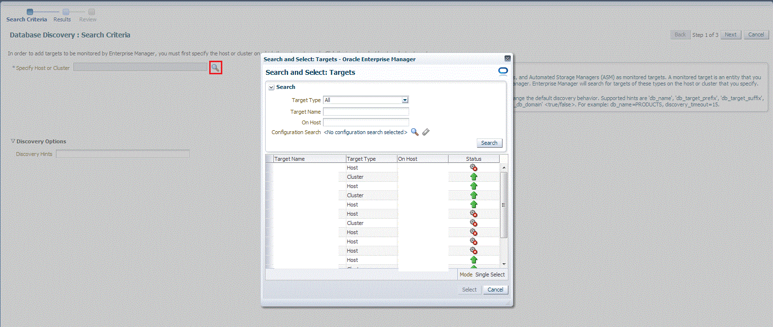

  4. On the Database Discovery: Search Criteria page, specify the database instance host, or click on the Specify Host or Cluster search icon to select the host.
    Database discovery search criteria page
    If the host you select is a member of a cluster, then use this page to also indicate whether the databases should be searched only on the selected host or on all hosts within the cluster.
    After you click the search icon, a Select Targets dialog box appears. Specify the target name or select a target from the target table. You can filter the search to search for all down targets or up targets, by clicking the filter arrows in the Status column.
    You can also configure your search by clicking the Configuration Search icon. After you select the host, click Select.
    You get an option to choose if you want to search for database targets only on the current host that you selected, or on all the hosts in the cluster that the host target is a member of.
    This option enables you to save time, if you want to search for database targets only on the current host selected.

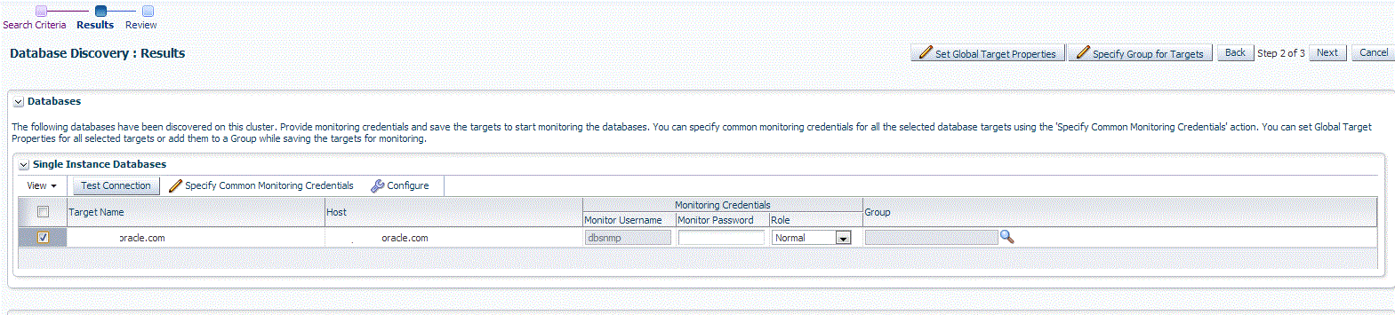

  5. The Database Discovery:Result page displays the databases discovered on the cluster. Select the database
    On the Database Discovery: Results page, under the Databases section, in the Single Instance Databases section, select the database instance target that you want to promote.
    Database Discovery Results instance page
