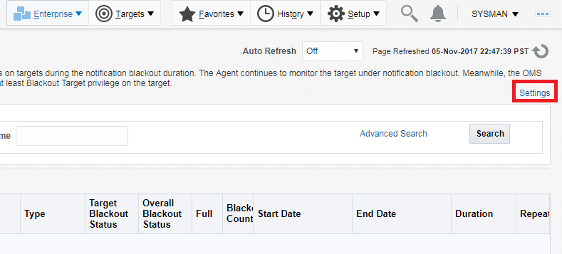

From the Enterprise menu, select Monitoring and then Blackouts. The Blackouts page displays.

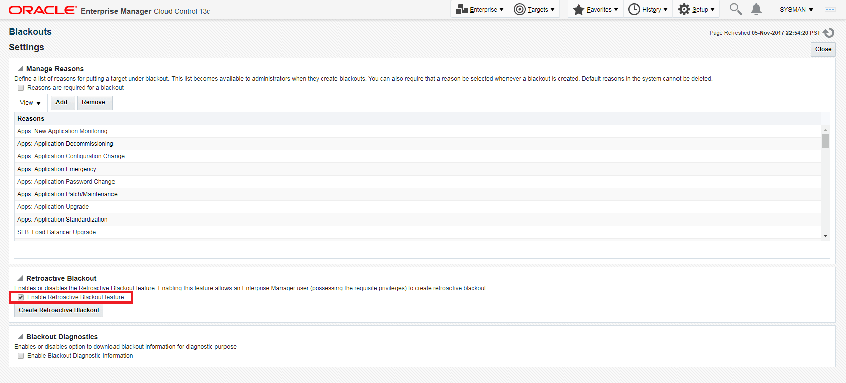

Click Settings. The Settings page displays.
At the bottom of the Settings page, check the Enable Retroactive Blackout Feature option box.

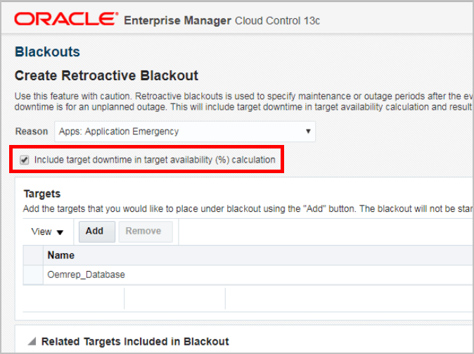

- Click Create Retroactive Blackout. The Create Retroactive Blackout page displays.
- Ensure that the Include target downtime in target availability (%) calculation option is checked.
The Include target downtime in target availability (%) calculation checkbox should be enabled during the creation of a retroactive blackout/outage, only if Enterprise Manager did not detect the outage. Checking this option will include target downtime in the target availability calculation and will result in a lower availability percentage. -

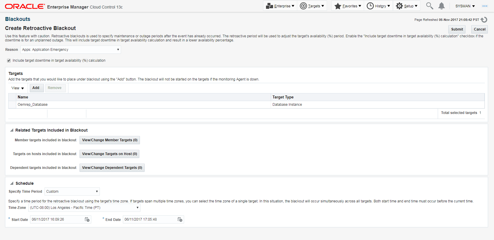

Select a reason from the Reason drop-down menu and then click Add to add the target(s) for which you are creating the retroactive outage.
In the Schedule region, specify the time period in which the target was down.
Click Submit to create the retroactive outage. A success confirmation message will be displayed on the Blackouts page.

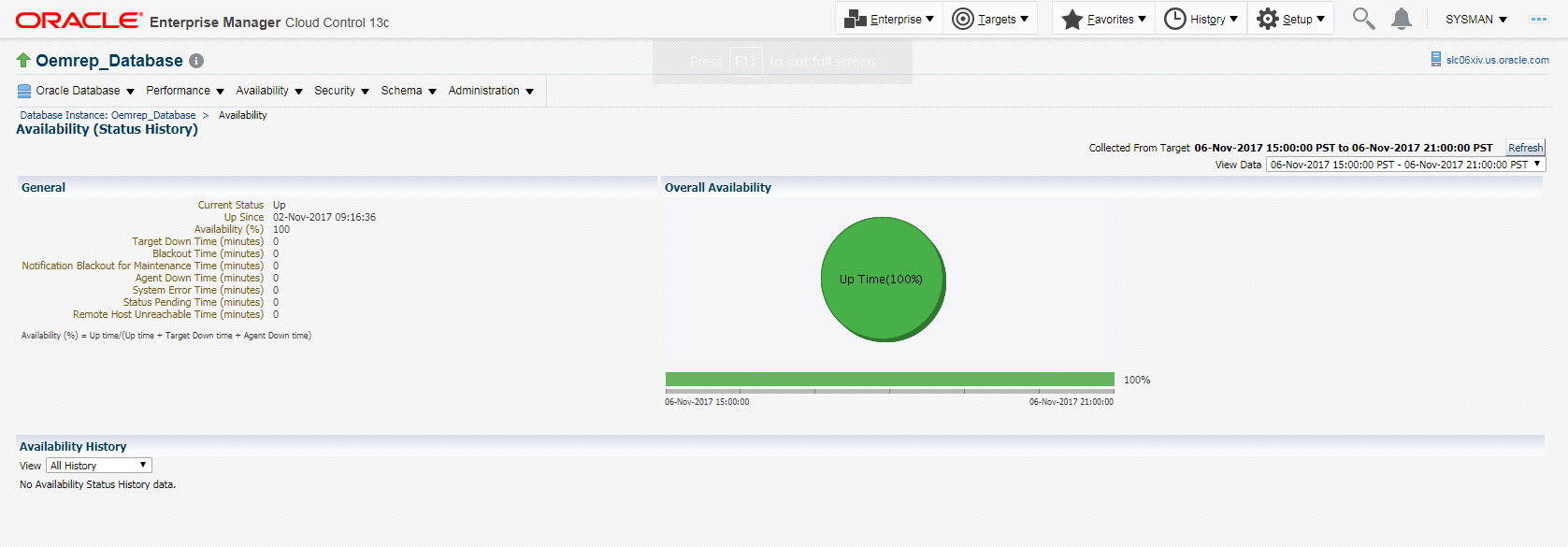

The following graphic shows target availability history for the repository database before the retroactive outage has been defined. Target availability percentage is 100% with no down time.

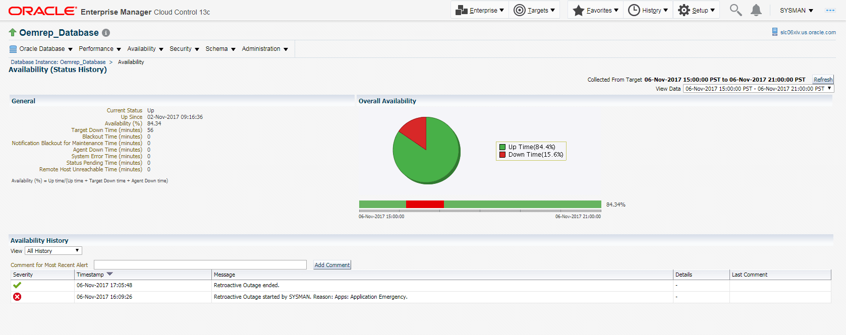

The next graphic shows the target availability history after a retroactive outage of 56 minutes has been defined. Target availability percentage has been reduced to 84% with 56 minutes of target down time.
