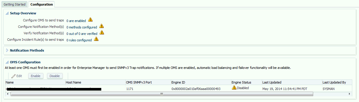

Click the Configuration tab. The Configuration page displays.
From the Notification Methods region, click Create. The SNMPv3 Traps: Create Notification Method page displays.
Enter the requisite Notification Method definition parameters. Note: You can enable Repeat Notifications at this point.
