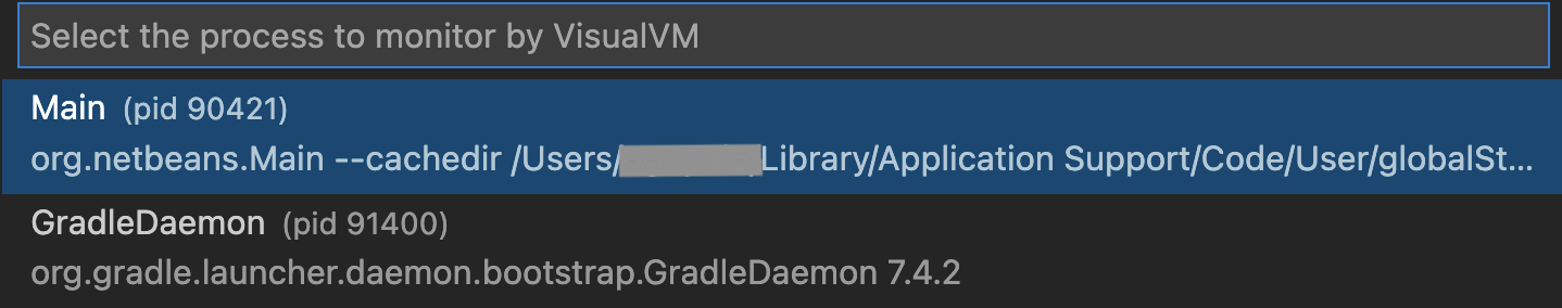

Process
A node to track the process selected for monitoring by VisualVM. By default no process is selected, showing the not selected value. A process can be selected for monitoring using the Select process action available for the Process node, by invoking any action which requires the process selection, using the Open Process In VisualVM in Command Palette, or by starting the project using the special Launch VisualVM & Java 8+ Application launch configuration.
When selecting a process for monitoring, list of local Java processes started by the current user is displayed (populated using the jps tool from the active GraalVM).
For each process the main class is displayed if available, along with the process ID.
If the process is configured to display a custom name in VisualVM (-Dvisualvm.display.name=CustomName), the custom name is displayed instead of the main class.
Each process item also shows a fully qualified main class name together with the arguments passed to the process, if available.
Once the selected process has terminated, the node is cleared on first invocation of either Start VisualVM or any action which requires the process selection.

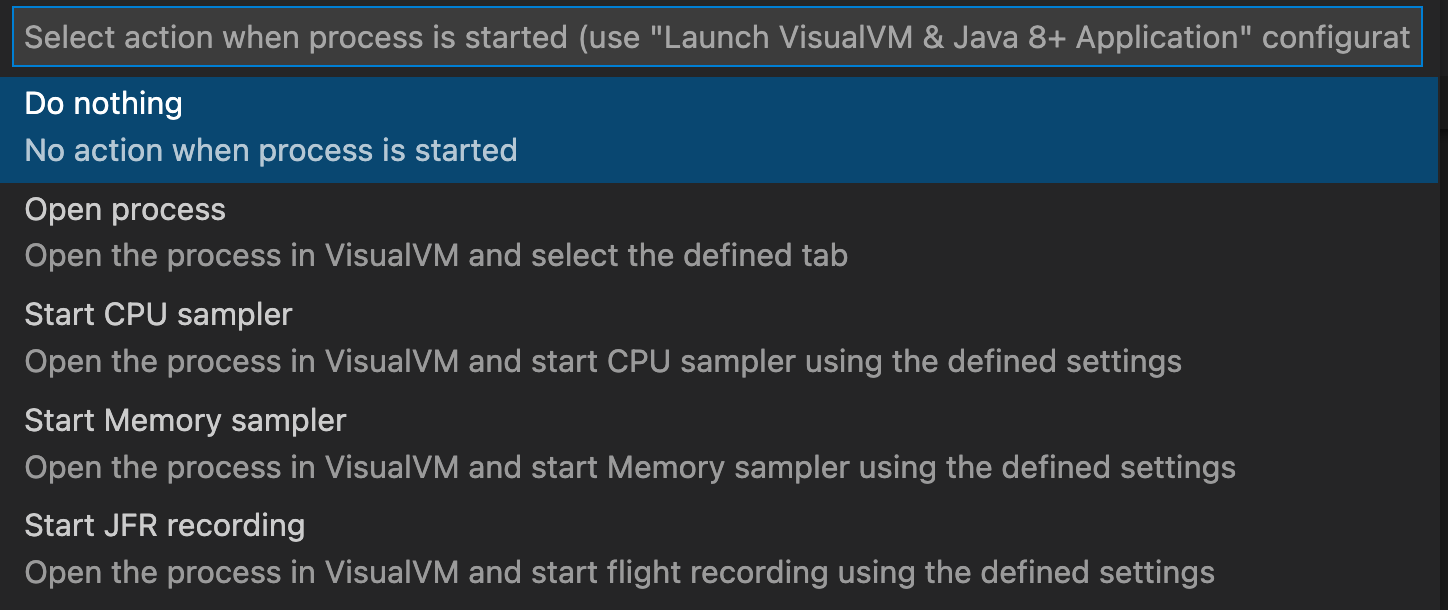

When Started
A node to define the action to perform when the process is started. This feature requires starting the project using the Launch VisualVM & Java 8+ Application launch configuration. The following choices are available:
- Do nothing: no action is taken when the process is started
- Open process: the process is opened in VisualVM and the defined tab is selected
- Start CPU sampler: the process is opened in VisualVM, the Sampler tab is selected, and the CPU sampling session is started using the defined settings
- Start Memory sampler: the process is opened in VisualVM, the Sampler tab is selected, and the memory sampling session is started using the defined settings
- Start JFR recording: the process is opened in VisualVM, and the flight recording is started using the defined settings
By default, the Open process choice is selected. This means that once the project process is started (using the Launch VisualVM & Java 8+ Application launch configuration), VisualVM is started as well, the project process is opened, and defined tab selected. Use the Configure action to change the default choice.
