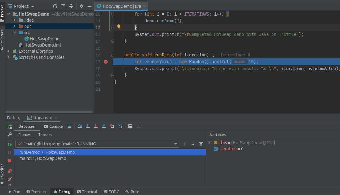

  4. Place a line breakpoint on the first line in runDemo().
  5. Setup the Run configurations to run with Java on Truffle and press Debug. You will see:
    HotSwap Debugging Session: Debug Output

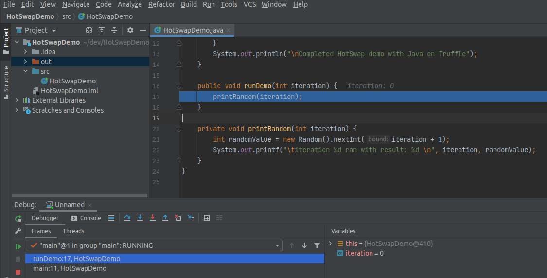

  6. While paused at the breakpoint, extract a method from the body of runDemo():
    HotSwap Debugging Session: Extract Method

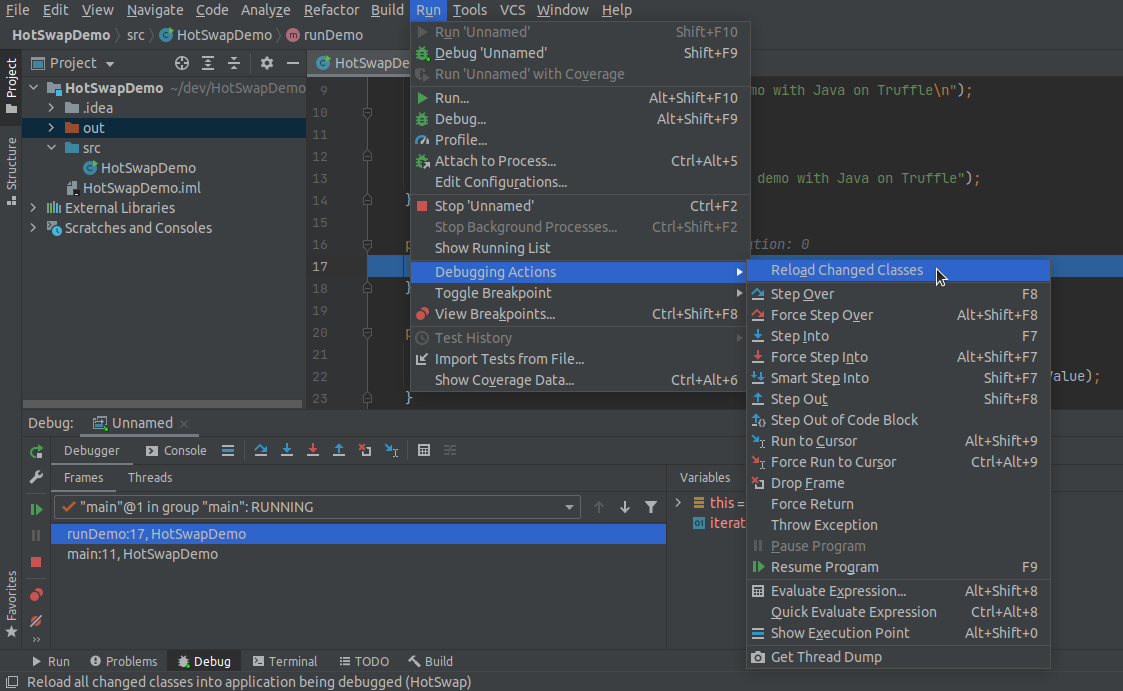

  7. Reload the changes by navigating to Run -> Debugging Actions -> Reload Changed Classes:
    HotSwap Debugging Session: Reload Changed Classes
  8. Verify that the change was applied by noticing the <obsolete>:-1 current frame in the Debug -> Frames view:
    HotSwap Debugging Session: Frames View

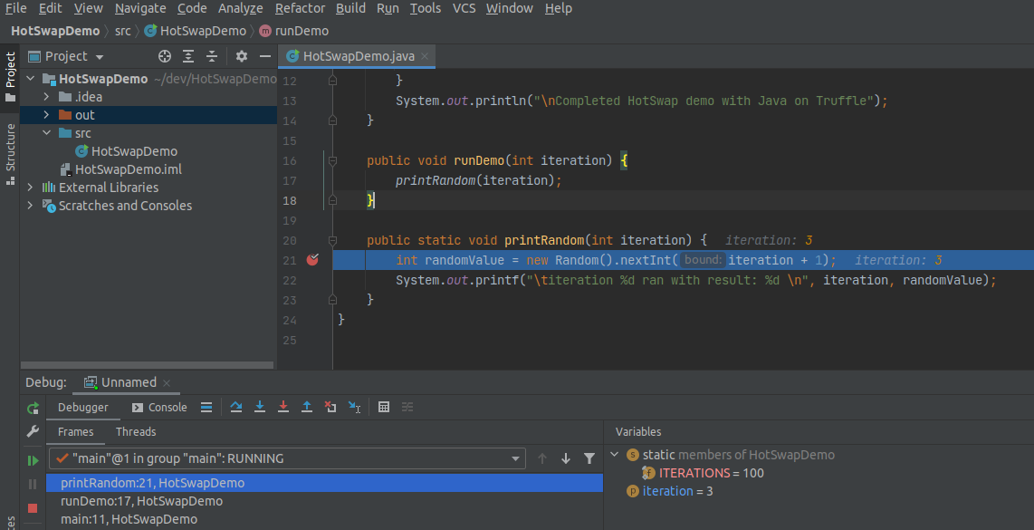

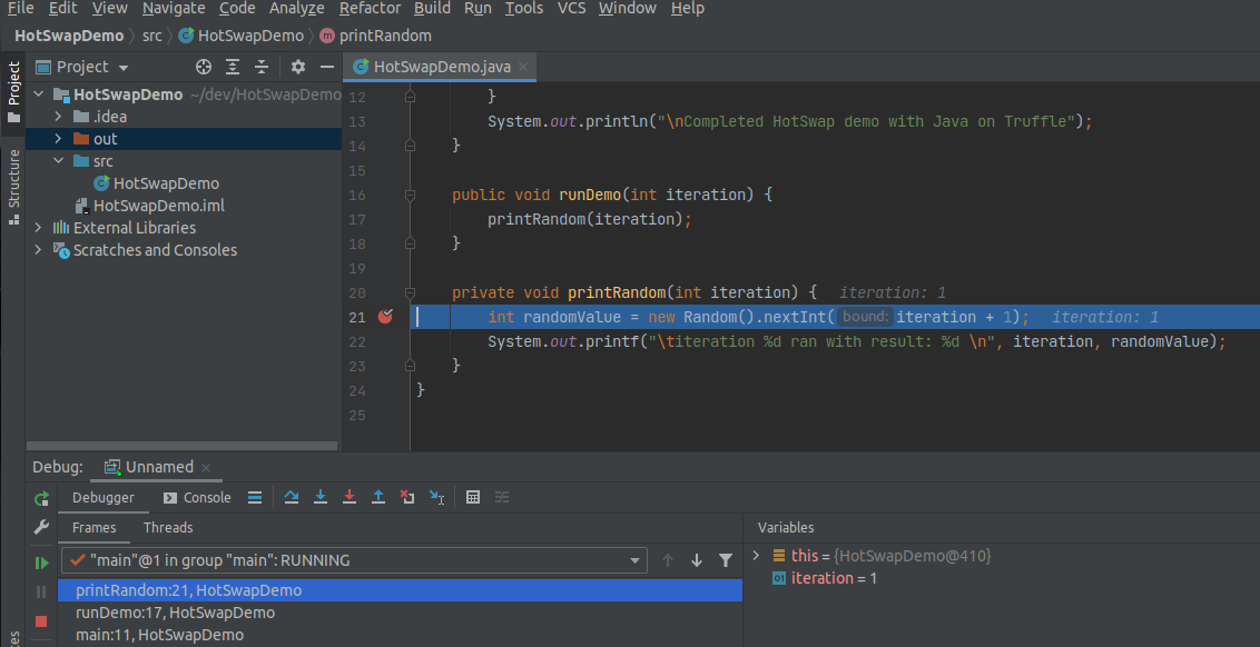

  9. Place a breakpoint on the first line of the new extracted method and press Resume Program. The breakpoint will hit:
    HotSwap Debugging Session: Set a Breakpoint and Resume Program
  10. Try to change the access modifiers of printRandom() from private to public static. Reload the changes. Press Resume Program to verify the change was applied:
    HotSwap Debugging Session: Change Access Modifiers
