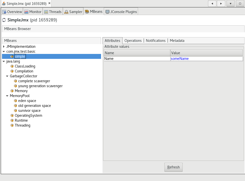

Step 6: Inspect Using VisualVM
Start VisualVM to view the managed beans in a user-friendly way.
Make sure you have the VisualVM-MBeans plugin installed (go to Tools, then Plugins, under Available Plugins, select “VisualVM-MBeans”, and click Install).

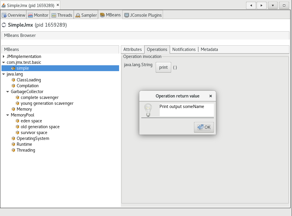

Go to the Applications tab and select the SimpleJmx process. From there you can select the MBeans tab.
In the MBeans tab, you can inspect the custom MBean you created earlier and perform operations on it.
