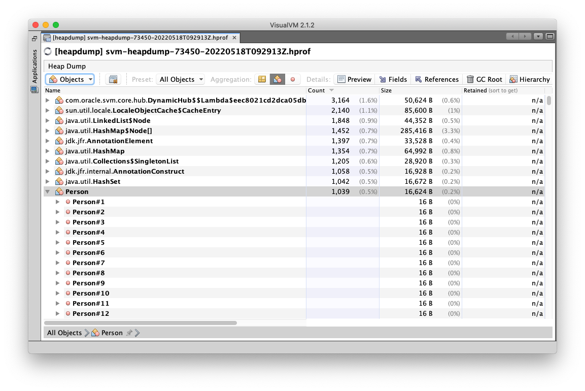

Run the application, send it a signal, and check the heap dump:
Run the application:
./svmheapdump 17 May 2022, 16:38:13: Hello GraalVM native image developer! The PID of this process is: 57509 Send it a signal: 'kill -SIGUSR1 57509' to dump the heap into the working directory. Starting thread! 17 May 2022, 16:38:13: Thread started, it will run for 60 seconds
Make a note of the PID and open a second terminal. Use the PID to send a signal to the application. For example, if the PID is
57509
:kill -SIGUSR1 57509
The heap dump will be created in the working directory while the application continues to run. The heap dump can be opened with the VisualVM tool, as illustrated below.

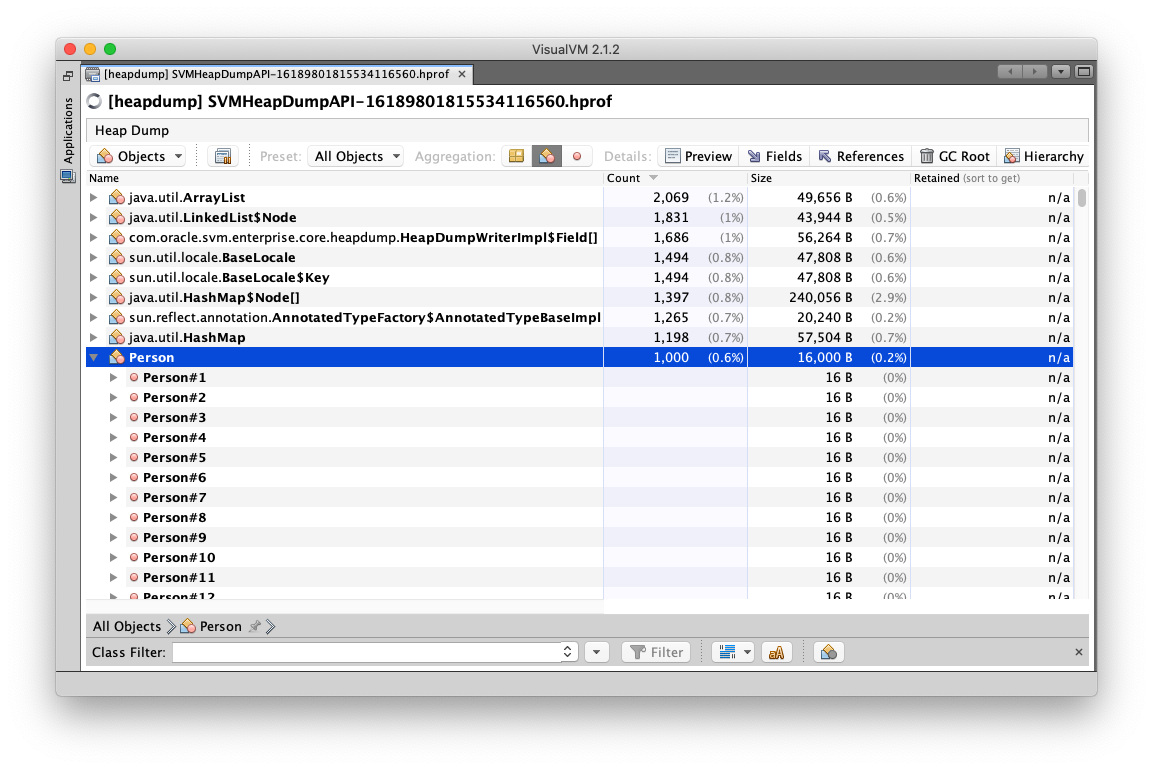

Run the application and check the heap dump
Now you can run your native executable and create a heap dump from it with output similar to the following:
./svmheapdumpapi --heapdump Sep 15, 2020, 4:06:36 PM: Hello GraalVM native image developer. Your command line options are: --heapdump Heap dump created /var/folders/hw/s9d78jts67gdc8cfyq5fjcdm0000gp/T/SVMHeapDump-6437252222863577987.hprof, size: 8051959
The resulting heap dump can be then opened with the VisualVM tool like any other Java heap dump, as illustrated below.
