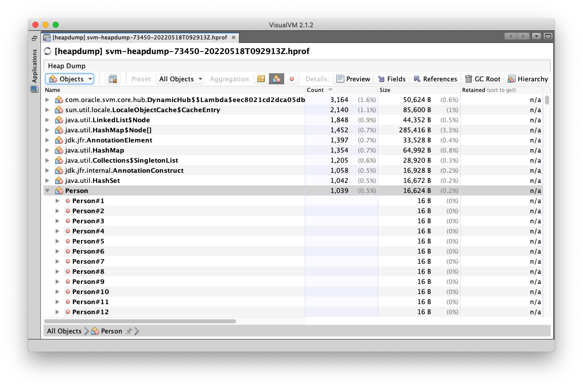

    Make a note of the PID and open a second terminal. Use the PID to send a signal to the application. For example, if the PID is 57509:
     kill -SIGUSR1 57509
    The heap dump will be created in the working directory while the application continues to run. The heap dump can be opened with the VisualVM tool, as illustrated below.
    Native Image Heap Dump View in VisualVM

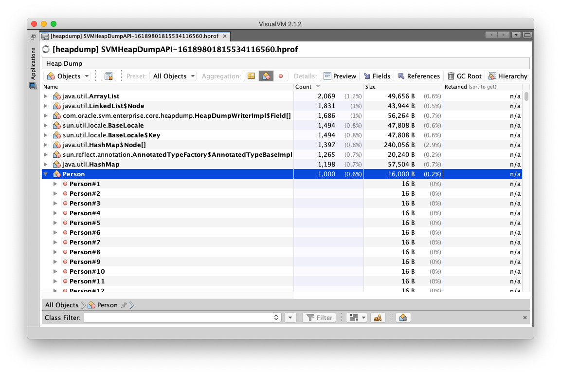

    As in the earlier example, the application creates a Collection of Persons referenced by the static variable CROWD. It then checks the command line to see if heap dump has to be created, and then in method createHeapDump() creates the heap dump.
  2. Build a native executable.
    Compile SVMHeapDumpAPI.java and build a native executable:
     javac SVMHeapDumpAPI.java
     native-image SVMHeapDumpAPI
    When the command completes, the svmheapdumpapi native executable is created in the current directory.
  3. Run the application and create a heap dump:
     ./svmheapdumpapi --heapdump
    You should see a similar output:
     Sep 15, 2020, 4:06:36 PM: Hello GraalVM native image developer.
     Your command line options are: --heapdump
       Heap dump created /var/folders/hw/s9d78jts67gdc8cfyq5fjcdm0000gp/T/SVMHeapDump-6437252222863577987.hprof, size: 8051959
    The resulting heap dump can be then opened with the VisualVM tool like any other Java heap dump, as illustrated below.
