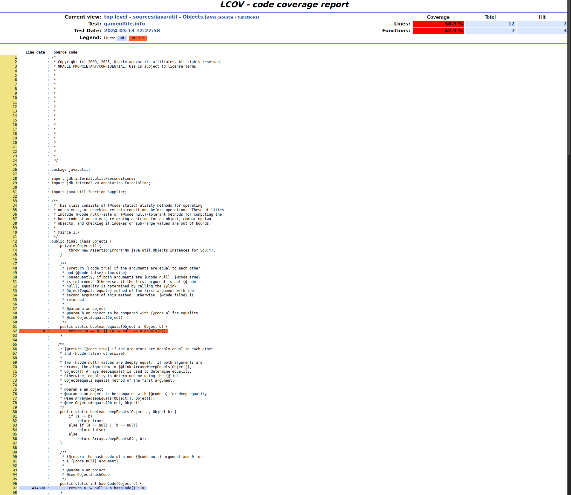

See below an example source file view from the report for the gameoflife-coverage.info trace file
generated by the former command:
More over, the functions view lists all the methods found in the particular source file along with
their execution counts:
