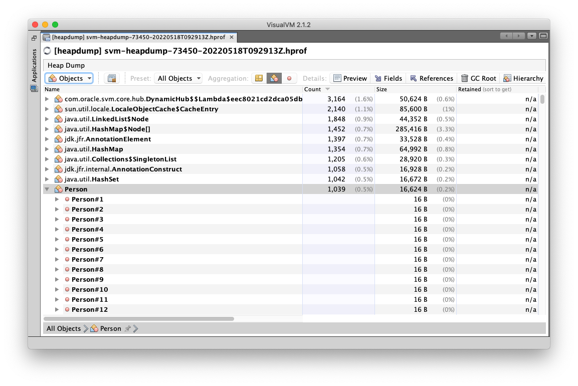

The heap dump will be created in the working directory while the application continues to run. The heap dump can be opened with the VisualVM tool, as illustrated below.

The resulting heap dump can be then opened with the VisualVM tool like any other Java heap dump, as illustrated below.
