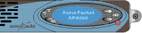

System Reset
Resetting the Acme Packet 4600 via the reset pushbutton on the front of the chassis performs a cold reboot. This action is the equivalent of disconnecting the power from the system and then reconnecting it. There is no orderly termination of tasks, and the system shuts down abruptly. You should only reset the Acme Packet 4600 when it becomes unstable and no other means of gaining administrative control is possible.
During a system reset, certain files are not closed properly, and they may become corrupted. If an unclean shutdown is detected, filesystem recovery/repair will be run to ensure the system returns to a stable state. Filesystem verification also runs every 30 boots as a precautionary measure.
Always try to first reboot the Acme Packet 4600 from the ACLI before performing a cold reset. Only reset the system as a last resort.
To reset the Acme Packet 4600:
  1. Insert a rigid paperclip-sized tool into the small hole on the front of the chassis beneath the graphic display. The system immediately resets and begins its initialization and boot sequence.Image showing the reset pushbutton

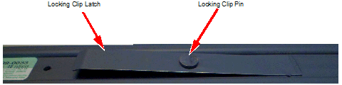

  7. When mounted in slide rails, the chassis will stop when the locking clip pin on the chassis slide rail engages with the equipment rack slide rail. Image showing Locking Clip Fastens the Chassis and Rack Slide Rails
  8. Push on the locking clip pin and locking clip latch to unlock the slide rails from each other. Image showing Locking Clip Latch and Locking Clip Pin

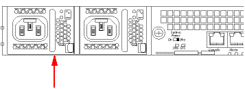

Power Supply Removal and Replacement
This section explains how to remove and replace the power supplies in the Acme Packet 4600 chassis.
After physically unplugging a power supply, disconnect it from the power source before you remove or install it in the chassis.
The power supply is a user-replaceable component. If an Acme Packet 4600 power supply malfunctions, you should remove the malfunctioning power supply and replace it.
Power supplies can be removed from the chassis while it is still installed in the rack and while the second power supply is providing system power; this is called a warm swap.

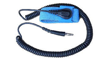

When removing and replacing a power supply, remember to first ground yourself using appropriate ESD grounding equipment such as a wrist strap.
Image showing a ESD Grounding StrapTo remove a power supply from the Acme Packet 4600 chassis:

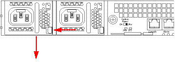

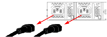

  1. Remove the power cables from the power supplies.Diagram showing Removing the Power Cords
  2. With your thumb, push the grey locking tab to the left to unlock the power supply from the chassis.Diagram showing Releasing the Locking Tab
  3. Holding the handle, pull the power supply towards you. This will disengage the power supply from the midplane and the chassis.
  4. Continue pulling the power supply towards you until it is completely out of the chassis.
  5. Move the power supply to an ESD-safe location.
    NEVER power up a power supply before it is installed in the Acme Packet 4600 chassis.
  6. Ground yourself with an ESD wrist strap before installing a power supply.

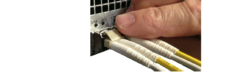

  3. Unplug all network and management cables from the NIU you plan to remove from the Acme Packet 4600.
    This will cause a link loss on all connections.

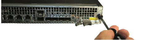

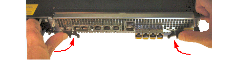

  4. Using a #2 Phillips screwdriver or your hands, unscrew the two captive thumbscrews located on each side of the NIU. The screws are spring-loaded and will push forward, but they will not fall out of the NIU.Diagram showing how to Loosen NIU Captive Thumbscrews

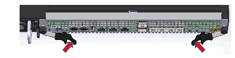

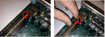

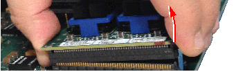

  5. With thumb and index finger slide ejector levers inward prior to pivoting ejectors. Diagram showing how to slide ejector levers
    Failure to follow this step may cause damage to the NIU ejectors:

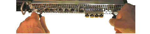

  6. Slide the lever catch and pivot the two ejection levers outward at the same time, pulling the card out of its connection to the motherboardand away from the system chassis. This action disengages the NIU from the system, severing all electrical contact to the processing unit. Diagram showing Pivoting the Ejection Levers
  7. Remove the loosened NIU out of the Acme Packet 4600 by holding and pulling on each side of the NIU's front panel.
  8. Place the NIU in an antistatic bag while it remains outside of the Acme Packet 4600 System chassis.
NIU Installation
To install an NIU into the Acme Packet 4600 chassis:
  1. Locate the NIU.
  2. Ensure that the ejection levers on the front of the card are in the open and extended position.
  3. Hold the NIU by its sides with the front panel bezel facing you.
  4. Note the two flared guide rails that the NIU rides as it is inserted into the Acme Packet 4600. The guide rails lead the NIU to engage with the bus connector squarely.Image showing Aligning the NIU Card with the Chassis Slot Guides
  5. Slide the card into the Acme Packet 4600. The physical interface card circuit board slides into the guide rails in the NIU bay of the system chassis. Image showing how to install the NIU
  6. Continue sliding the card into the chassis until the ejection levers meet the chassis and start to fold inward as the NIU is inserted into the chassis.
  7. Fold both ejection levers inward toward the card to complete the NIU connection to the motherboard. Pushing the ejection levers inward draws the physical interface card toward the system chassis and completes the connection. Image showing locking the NIUDiagram showing locking the NIU
    Ensure pressure is applied to the ends of the ejector (not the sliding section) when seating the NIU/TCU.
  8. Verify the lever catch is fully engaged with the bezel.
  9. Screw the NIU into the chassis with a #2 Phillips screwdriver. This creates the final connection between the interface unit and the chassis. Image showing how to tighten the thumbscrews

    3. Set the System Power switch to ON to apply power to the chassis. The system boots up.
    4. When the NIU PWR LED lights and the H/S LED is extinguished, proceed with normal operations. Otherwise, contact customer support for further assistance.

  • ESD wrist strap

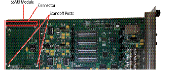

Removing the SSM3 Module
The following procedure describes how to remove the SSM3 module located on the Acme Packet NIU card.
Prerequisites:
  • Provide an ESD-safe location to place the SSM3 and NIU card.
  • Wear an ESD wrist strap or take similar equivalent actions to prevent static damage to the NIU card or other ESD-sensitive components.
  • Note the location of the SSM3 module connector on the NIU card.
  • #2 Phillips screwdriver
  1. Remove the NIU card as directed in this guide.
  2. Place the NIU card on an ESD-safe mat or other similar location.
  3. Using the Phillips screwdriver, remove the four standoff screws from the SSM3 module and store them for later reuse. Image showing the Location of the SSM3 Module Connector and Standoff Posts
  4. To remove the module (shown below), grasp the SSM3 module along either side of the connector between your thumb and index finger and pull up on one side of the connector until the module is fully disconnected from the connector. Place the module on an ESD-safe surface. Image showing Removing the SSM3 Module
Installing the SSM3 Module
The following procedure describes how to install the SSM3 module onto the Acme Packet NIU card.
Prerequisites:
  • Place the new SSM3 module in an ESD-safe location.
  • Standoff screws (stored after removing the SSM3 module or available with the new SSM3 module)
  1. Grasp the SSM3 module along either side of the connector between your thumb and index finger and join the module connector to the NIU connector by pressing evenly across the connector until the module is fully seated (see below). Image showing Installing the SSM3 Module
  2. Press evenly across the top of the connector to fully seat the SSM3 module on the NIU PCB as shown below. Note that the SSM3 is fastened to the connector at one end while at the other end, the board rests on two standoffs attached to the NIU as shown in the figures below. Image showing Fully Seating the SSM3 Module Connector
  3. Using the Phillips screwdriver, insert and tighten the four standoff screws to secure the SSM3 module to the PCB.

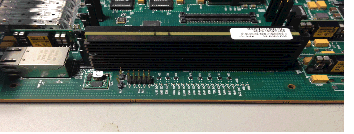

  4. Replace the NIU in the Acme Packet 4600 chassis.Image showing the Location of the SSM3 Module Connector and Standoff Posts

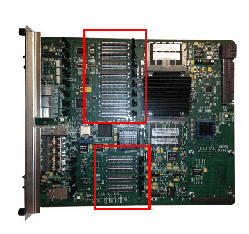

Up to twelve transcoder DSP modules that provide transcoding functionality to the Acme Packet 4600 are installed on the NIU printed circuit board in slots 0 through 11. Image showing Up to twelve transcoder DSP modules that provide transcoding functionality to the Acme Packet 4600 are installed on the NIU printed circuit board in slots 0 through 11.
Never remove the heatsink from the transcoder DSP modules.
There are slots for installing the transcoder DSP modules in two locations on the PCB (two groups - the first of eight slots, and the second of four slots- See Figure 6 - 122). Transcoder DSP modules should be installed consecutively in numerical order, starting with slot 0. Image showing the Locations of Transcoder DSP Modules

  1. Remove the NIU card as directed in this guide. See See NIU Removal and Replacement.
  2. Place the NIU card in an ESD-safe location.

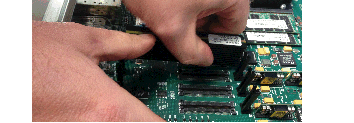

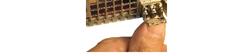

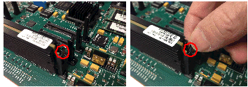

  3. To remove the module (as shown in the photos below), use a fingertip to release the catch holding either end of the transcoder DSP module. Image showing Releasing the Fastener Holding the Transcoder DSP Module (1 of 2)Image showing Releasing the Fastener Holding the Transcoder DSP Module (2 of 2)
  4. Once the fasteners are detached from both sides of the transcoder DSP module, hold the center of the module between your finger and thumb and slowly remove the module. Be careful to keep the module level while removing it and guide it smoothly through the guide slots on either side.Image Showing Removing the Transcoder DSP Module
  5. Place the transcoder DSP module on an ESD-safe antistatic surface.

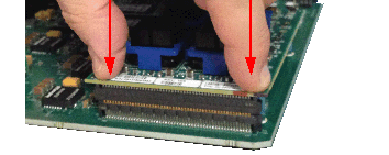

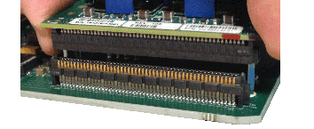

  1. Grasp the transcoder DSP module between your thumb and index finger and line up both sides of the module with the slot guides attached to the NIU PCB (see below). Image showing Installing the Transcoder DSP Module
  2. Using your thumb on your other hand, guide the module evenly into the slot guides located on each side as you lower the component into the connector. Press evenly across the top of the connector to fully seat the transcoder DSP module on the NIU PCB as shown below. Note that the module is fastened to the connector at one end while at the other end, the board rests on two standoffs attached to the NIU as shown in the figures below. Image showing Installed Transcoding DSP Module

  • Remove the power cable(s) from the Acme Packet 4600’s power supplies.

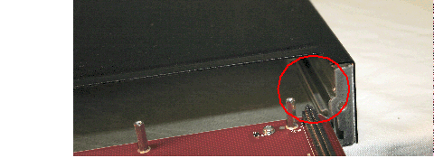

Removing Hardware in Center-Mount Configurations

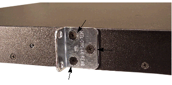

The rack ears must be removed before you can open the chassis.Image showing left rack ear
To remove center-mount equipment rack hardware:
  1. Remove the left rack ear by using a #1 Phillips-head screwdriver.
  2. Remove the right rack ear by unscrewing the three screws.
  3. Set the rack ears and screws aside.

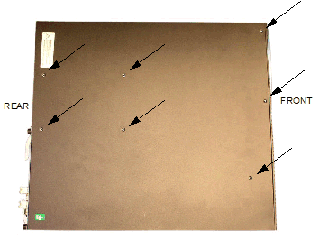

Opening the Chassis

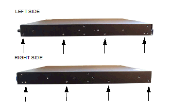

The chassis lid is secured to the chassis by 15 screws. Remove the screws and lift the chassis lid off the chassis.
Before opening the Acme Packet 4600, ground yourself using an ESD wrist strap or other comparable grounding system. Failure to do so could damage the Solid State Drive and the Acme Packet 4600.
Use a #2 Phillips-head screwdriver for all chassis cover and side screws.

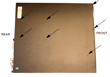

  1. Unscrew the four countersunk screws on each side of the Acme Packet 4600 that hold the chassis cover to the chassis. Image showing countersunk screws on the sides.
  2. Set these screws aside.Image showing screws
  3. Unscrew the seven countersunk screws on the top of the Acme Packet 4600 that hold the chassis cover to the chassis. The following is an image of the top of the chassis.
  4. Set the lid and screws aside.
  5. Lift the chassis lid off of the chassis and set aside.

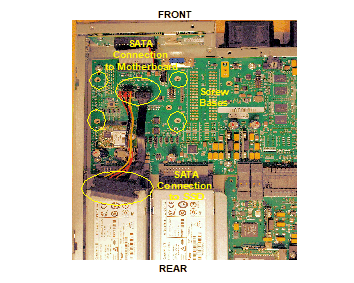

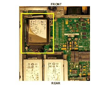

Once the Acme Packet 4600 is open, replacement is straightforward. The Solid State Drive (SSD) attaches electrically to the Acme Packet 4600 motherboard by a standard 2.5” SATA connector. In addition, it is secured to the motherboard by four screws.
The SSD is located at the front of the motherboard, on the left side as you view it from the rear of the chassis. The SSD has brackets on each side, with four screws attaching it to the motherboard.Image showing the location of installed SSDClose-up of installed SSD
  1. Identify the four screws that attach the SSD to the motherboard.
  2. Identify the SATA connector attached to the SSD.Image showing the positions of screws and the SSD SATA cable connector
  3. Using a number 1 Phillips screwdriver, unscrew the four screws attaching the SSD to the motherboard.
  4. Hold the SSD in one hand, and the SATA connector in the other, and gently disconnect the two. Note that the SATA cable should remain attached to the motherboard.After SSD removal
Replacing the Solid State Drive
  1. Exchange the current SSD for the replacement, then re-attach the SSD to the SATA cable. The connector is keyed, so make sure the gap in the connector is lined up with the key in the SSD.
  2. Push down on the part of the SATA connecter attached to the motherboard to check to make sure the SATA cable is seated properly to the motherboard.
  3. Line up the screw mounts on the SSD with the screw bases, and tighten the screws. Be careful not to over-tighten the screws.

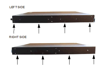

Attaching the Lid
  1. Set the lid on top of the Acme Packet 4600 chassis. The stickers are positioned at the chassis rear.
  2. Screw the eight countersunk screws into the top of the Acme Packet 4600 to secure the chassis cover to the chassis. The following is an image of the top of the chassis without any screws.Image showing the top of the chassis without screws
  3. Continue securing the chassis lid with four screws on each side. Image showing the chassis lid

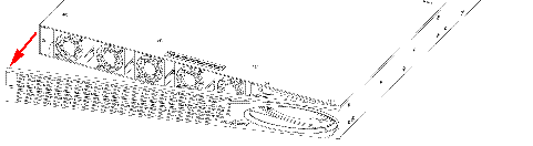

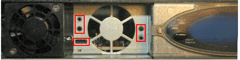

The individual fan is a user-serviceable, hot-swappable component. There are five individual fans in the Acme Packet 4600. If the Acme Packet 4600 experiences a fan malfunction, you must remove the existing fan and replace it with a functional one.
The hot-swappable fan removal and replacement procedures require that you have a replacement fan on hand. In order to maintain system operations, you must be able to remove the malfunctioning fan and quickly replace it with a functioning one to prevent the system from overheating.

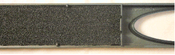

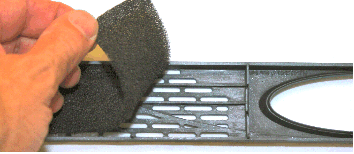

The Acme Packet 4600 air filter is located behind the front bezel and is a Field Replaceable Unit (FRU).
An over temperature condition can stop packet processing.
If you do not have a replacement fan nearby, always shut down the system and disconnect the power before removing the malfunctioning fan to replace at a later time.
When removing and replacing a fan, remember to first ground yourself using appropriate ESD grounding equipment such as a wrist or heel strap.

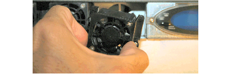

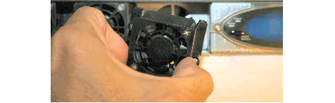

To remove a fan:
  1. Press two fingers against the left end of the plastic fan bezel and pull it directly toward you. The fan bezel comes off the chassis. Set the fan bezel aside. The individual fans are now exposed.Image showing removing the Front Bezel
  2. Using a small bladed screwdriver, unscrew the two captive screws at each upper left and lower right corners of the individual fan you are replacing.Image showing Loosening Fan-Fastening Screws
  3. Pull the individual fan you just unscrewed directly toward you, out of the chassis. Move the fan to an ESD-safe location.Image showing Removing the Fan

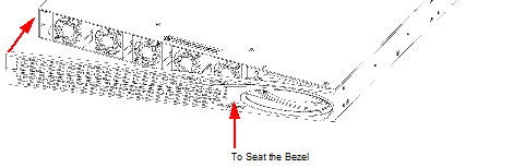

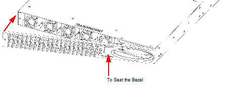

  3. Install the front bezel onto the Acme Packet 4600 by hooking the right side of the bezel onto the chassis and then pivoting the bezel to the left until the magnet catches the chassis. You may need to push on the left side of the display opening to fully seat the bezel. Image Showing Replacing the Front Bezel

Cleaning the Cooling Components
To clean the fan module:
  1. Remove the fan module from the chassis.
  2. Spray compressed air into the fan module to dislodge and blow away any contaminants and clean out the fans.
  3. Replace the fan module.
  4. To clean the perforated air inlets: Remove the bezel from the chassis by gripping the two corners and pulling on it. The bezel is held on magnetically.Image Showing Removing the Front Bezel
  5. Place the bezel face down.
  6. On the back of the bezel, pull off the air filter. Image showing Removing the Air Filter from Behind the Front Bezel
  7. Replace the air filter with a new one. Do not reuse the worn air filter.
  8. Gently wipe the front fan bezel that contains the perforated air inlets with a clean, dry cloth. You can alternatively remove the fan bezel from the system and use compressed air to clean out the perforated air inlets.
  9. Install the air filter carefully in place behind the front bezel.Image showing Air Filter Installed Behind the Front Bezel
    Only the removable fan bezel has vent holes that require cleaning.
    To prevent damage to the painted finish, do not use any solvents or liquids to clean the perforated air inlets on the front of the chassis.
  10. Install the front bezel onto the Acme Packet 4600 by hooking the right side of the bezel onto the chassis and then pivoting the bezel to the left until the magnet catches the chassis. You may need to push on the left side of the display opening to fully seat the bezel.Image Showing Replacing the Front Bezel

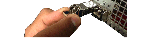

Removing an Optical Transceiver
To remove the transceiver from an NIU transceiver port:

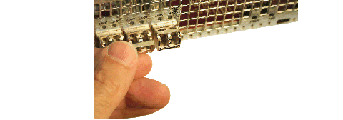

  1. Unplug all fiber optic cables from the optical transceiver to be replaced. Image showing NIU Transceiver Ports
  2. Pull the bale clasp latch out and down. It will pivot downwards on its hinge. Image showing Lowering the Bale Clasp Latch
  3. Holding the extended bale clasp latch, pull the optical transceiver fully out of its socket of the physical interface card. Image showing Removing the Optical Transceiver
Install an Optical Transceiver
To install an optical transceiver:

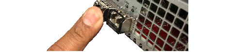

  1. Slide the replacement optical transceiver into the socket on the NIU.Image showing Inserting the Optical Transceiver into the Socket
  2. Press on the face of the optical transceiver to seat it in the socket.Image showing Seating the Optical Transceiver
  3. Flip the bale clasp latch back into the rest position. Image showing Closing the Clasp Latch
  4. Reconnect the optical cables to their corresponding ports. Image showing Reconnecting Optical Cables
