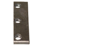

Nut Bar (4)

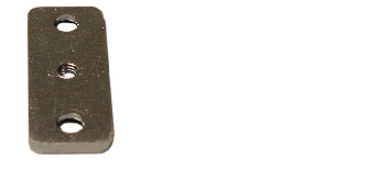

Mounting Spacer (2)

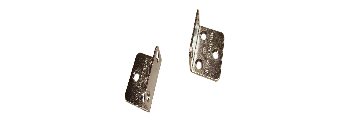

Center mounting flanges (2) for a 2-post rack

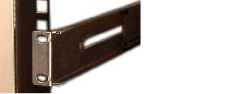

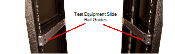

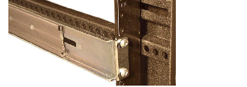

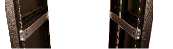

Installing the Equipment Rack Slide Rails
In the first stage of system installation, secure the equipment rack slide rail to the equipment rack. The painted end of the equipment rack slide rail attaches to the front of the equipment rack and the bare steel side attaches to the rear of the equipment rack. The equipment rack slide rail can expand and contract to accommodate equipment racks of various depths up to 32”.
You can mount the equipment rack slide rail to both tapped hole rack and square rack. Follow the appropriate procedure below.

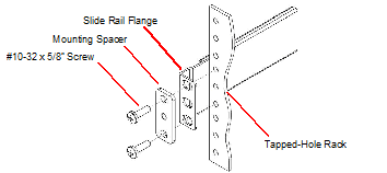

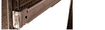

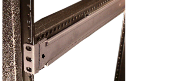

Installing Slide Rails into a Tapped-Hole Rack
This section explains how to mount the Acme Packet 4600 slide rail assembly into a tapped-hole equipment rack.
The following procedure presumes that the tapped hole size is #10-32. If alternate tapped holes are used, the customer must supply the proper screws.- Locate the following components: Assembled equipment rack slide rails (2), #10-32 x 5/8” screws (8), Mounting spacers (2)
- Line up the painted side of the equipment rack slide rail with an appropriate
mount point on the front of the equipment rack.
- For both holes in the flange, place one #10-32 x 5/8” screw through the
mounting spacer, then through the slide rail flange and into the tapped
hole.
- Using a #2 Phillips head screwdriver, tighten the screws to secure the slide
rail to the equipment rack. Do not completely torque the screws; leave a small
amount of play at this time.
- Expand and line up the unpainted side of the equipment rack slide rail on the
outside of the rear rack slide rail at the same height used for the front mount
point.
- For both holes in the slide rail flange, place one #10-32 x 5/8” screw through
the flange and into the tapped hole, and screw them into place.
- Repeat Steps 2 and 6 for the other test equipment slide rail.

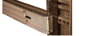

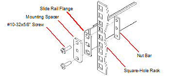

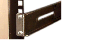

Installing Slide Rails into a Square-Hole Rack
This section explains how to mount the Acme Packet 4600 slide rail assembly into a square-hole equipment rack. The customer can use #10-32, 1/4-20, M5 or M6 cage nuts as an alternative, but the cage nuts will be customer-supplied along with the associated mounting screws for the cage nut selected.
To install the slide rails on the front of a square-hole equipment rack:- Locate the following components: Equipment rack slide rails (2), #10-32 x 5/8” screws (8), Mounting spacers (2), Nut bars (2)
- Line up the painted side of the stationary rail with an appropriate mount
- For each of the two holes in the slide rail flange, place a #10-32 screw
through the mounting spacer, then through the slide rail flange, and finally
through the square hole in the rack rail.
- Hold the nut bar behind the front rack rail.
- Expand and line up the unpainted side of the stationary rail flange on the
outside of the rear rack rail at the height used for the front mount point.
- Hold the nut bar behind the rear rack slide rail.
- Place one #10-32 screw through each of the holes in the slide rail flange, then through the square hole in the rack, and finally into the nut bar.
- Using a #2 Phillips head screwdriver, tighten the screws securely into
place.
- Torque the screws on the front and back of the rail slide.
- Repeat this procedure for the other slide rail.

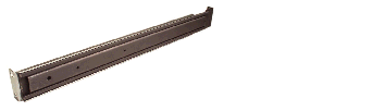

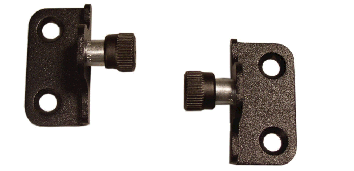

Installing the Chassis Flanges and Slide Rails
In this second portion of system installation, two chassis flanges and two chassis slide rails are secured to the Acme Packet 4600 chassis.
To install the chassis rail slides on the Acme Packet 4600 chassis:- Locate the following components: #10-32 x 5/16” flat head (black) screws (4), Front-mounting flanges (2), #6-32 x 5/16” screws (6), #2 Phillips screwdriver, Chassis slide rails (2)
- Line up one chassis flange with the tapped holes. Position the chassis
flange’s spring-loaded thumbscrew toward the front panel of the system.
- Insert 2 x #10-32 x 5/16” flat head screws into the flange and chassis, and
using a #2 Phillips screwdriver, tighten the screws to secure the flange to the
chassis.
- Line up the chassis slide rail with the Acme Packet 4600 side panel. Position
the large marker hole in the slide rail at the front of the Acme Packet 4600
chassis. The remaining three tapped holes in the Acme Packet 4600 chassis will
line up with the slide rail holes.
- Use 3 x #6-32 x 5/16” screws to secure the chassis slide rail to the side of
the Acme Packet 4600. Notice that the large hole in the slide is positioned
toward the front of the Acme Packet 4600 chassis.
- Repeat this procedure for the other side of the Acme Packet 4600 chassis.

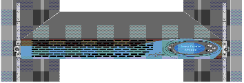

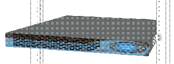

Center-Mount 2-Post Chassis Installation
The following sections explain how to center mount your Acme Packet 4600 into a
2-post equipment rack.
Installing the Center-Mount Hardware
Center-mounting flanges are attached to each side of the Acme Packet 4600. These mounting flanges are reversible, and are not mated to a specific side of the chassis. While the Acme Packet 4600 is shipped with all mounting hardware for attaching the rack flanges to the chassis, you must obtain and use the appropriate hardware recommended by the equipment rack manufacturer for mounting the system in the rack.
To install your Acme Packet 4600 in a center-mount configuration:- Locate the following components: Center-mounting flanges (2), #10-32 x 5/16” flat head (black) screws (6)
- Line up one chassis flange with the three tapped holes found along the center
of the side of the Acme Packet 4600 chassis. The three screw holes of the
chassis flange will only align in one direction.
- Using a Phillips head screwdriver, tighten the three #10-32 x 5/16” Phillips
head (black) screws to secure the flange to the chassis.
Installing the Chassis in the Rack
- This installation requires two people and should not be attempted otherwise.
- Follow your organization’s best practices for lifting and installing heavy components into an equipment rack.
- Ensure that the Acme Packet 4600 chassis remains supported until you have completely installed it into the equipment rack.
- Locate the following components: Equipment rack screws (4)
- Lift the Acme Packet 4600 into the correct position in the equipment rack.
- Use a #2 Phillips screwdriver to secure two screws through the mounting flanges
on the Acme Packet 4600 and into the equipment rack. One person should hold the
Acme Packet 4600 in the correct position while the other person screws the Acme
Packet 4600 in place.

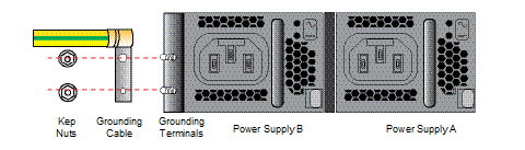

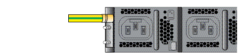

Ground and Power Cable Installation
- Garbled output on the console display
- Sudden crashes
- Physical damage to the Acme Packet chassis and its hardware components
Failure to ground the chassis properly can result in permanent damage to the Acme Packet 4600 and its components. Bodily harm may also result under some circumstances.Note:
The Acme Packet 4600 does not support mixing AC and DC power supplies in the same chassis. A mixed power configuration is prohibited.Your equipment rack location must have a local earth ground. This ground can be either an unpainted spot on the grounded equipment rack frame, or a grounded bus bar in the equipment room.

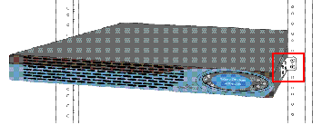

Grounding Cable Installation
The ground terminals are located to the left of power supply B on the rear of the Acme Packet 4600 chassis. The Acme Packet 4600 ships with 2 kep nuts screwed onto the ground terminals. Use an 11/32” nut driver to remove and install these kep nuts.
This section shows you how to install the grounding cable on your Acme Packet 4600.
Acme Packet 4600 equipment is suitable for installation as part of a Common Bonding Network (CBN).Note:
The Common Bonding Network (CBN) is a term used for the connection of building steel, water pipes, cable racks, vertical and horizontal equalizer conductors, bonding conductors and electrical metallic raceways within a building, when they are bonded together by either deliberate or incidental connections. The CBN is also connected to the building’s grounding electrode system. Connections to the CBN are usually made from equipment frames to reduce voltage differences to acceptable levels when current flows through these frames, either during fault occurrences in the AC or DC power systems, or when lightning strikes.AC Power Cord Installation
Use a 15 Amp fused circuit for each AC power supply.Note:
This equipment is intended for installation in locations where National Electrical Code (NEC) applies.- Set the System Power switch to the Stby position to cut off power to the Acme
Packet 4600.

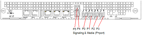

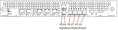

Media and Signaling Network Interfaces
This section explains how to cable the NIU for media and signaling. The NIU is available with either copper or optical SFP Ethernet connectors. The media and signaling ports that can be configured are either any combination of P0, P1, P2, and P3, or P4 and P5; not a mixture of the 1GbE and 10GbE ports.
Perform all cabling procedures according to the established standards for your organization.1GbE Copper Cabling Procedure
Shielded CAT 5e or CAT 6 (or higher) Ethernet cables with RJ45 jacks are used for connecting the Acme Packet 4600 1GbE copper NIUs to your production network over the signaling and media network ports.
To connect 1GbE Copper cables to the signaling and media ports:- Locate the Ethernet cables you plan to connect to the Acme Packet 4600.
- Insert the RJ45 connector on the end of the Ethernet cable into one of the 1GbE
copper NIU media and signaling ports. The release tab on the RJ45 jack will
click into place when you insert it properly.
- Route the cable away from the Acme Packet 4600. Make sure that the Ethernet cables are not stretched tightly or subjected to extreme stress.
- Repeat Steps 1 through 3 for each additional Ethernet cable you connect to your Acme Packet 4600.

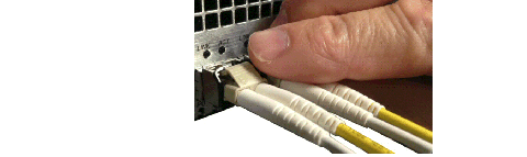

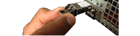

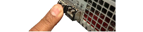

- Locate the fiber optic cables you plan to connect to the Acme Packet 4600. You
can choose from either P5 and P4 (10GbE), or P0, P1, P2 and P3 (1GbE).
- Slide the optical transceiver into the socket on the NIU.
- Press on the face of the optical transceiver to seat it in the socket.
- Flip the bale clasp latch back into the rest position.

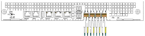

- Connect the optical cables to their corresponding ports.
- Route the cable away from the Acme Packet 4600. Make sure that the fiber optic cables are not stretched tightly or subjected to extreme stress.
- Repeat Steps 1 through 6 for each additional fiber optic cable you connect to your Acme Packet 4600.

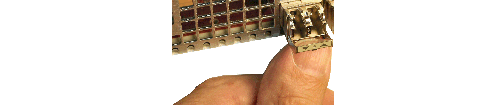

Copper Transceivers
- Insert the duplex LC connector on the end of the fiber cable into one of the
NIU’s SFP optical transceivers. The connector should click and lock in place
when you insert it properly. The example shows GbE fiber optic cables connected
to media and signaling ports (left to right) P0 , P1 , P2 , and P3 .
- Repeat Steps 1 and 2 for each additional fiber optic cable you connect to your Acme Packet 4600.

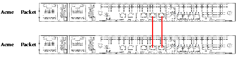

Cabling for HA Deployments
The information and instructions in this section explain how to cable an HA node.
HA Cabling
Category 5 (or higher) shielded Ethernet cables are required for cabling two HA nodes together.
Rear Panel Cabling
- Mgmt0 should be reserved as the boot/maintenance interface.
- Mgmt1 and Mgmt2 are available for sharing HA information.
Management network ports feature automatic crossover negotiation so that a crossover cable is not necessary for HA cabling.
To cable Acme Packet 4600 in an HA configuration using single rear interface support:
- Insert one end of an Ethernet cable into either Mgmt1 or Mgmt2 on the rear panel of the Acme Packet 4600 A. The release tab on the RJ45 jack clicks into place when you insert it properly.
- Insert the other end of the Ethernet cable into the corresponding management
interface on the rear panel of the Acme Packet 4600 B. The release tab on the
RJ45 jack clicks into place when you insert it properly. If you use Mgmt1 on
Acme Packet 4600 A, then you will connect it to Mgmt1 on Acme Packet 4600 B.
- Refer to the configuration procedures located in the HA Nodes chapter of the Acme Packet Configuration Guide .

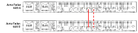

Dual Rear Interface Support
- Insert one end of an Ethernet cable into Mgmt1 on the rear panel of Acme Packet 4600 A. The release tab on the RJ45 jack clicks into place when you insert it properly.
- Insert the other end of the cable into the Mgmt1 port on the rear panel of Acme Packet 4600 B.
- Insert one end of a second Ethernet cable into Mgmt2 on the rear panel of Acme Packet 4600 A.
- Insert the other end of the cable into Mgmt2 on the rear panel of Acme Packet
4600 B.
