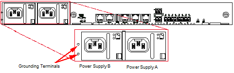

Oracle offers AC or DC power options for the Acme Packet 4600. The power supplies are user-replaceable, hot swappable components. When servicing your power components, make sure to read the Acme Packet 4600 Service Manual .
Each power supply is accessed from the rear panel of the Acme Packet 4600. The power
supply located at right is designated as power supply A while the power supply located
at left is designated as power supply B.
