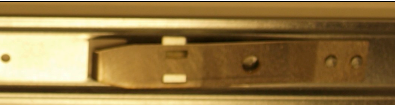

- To remove the bezel, pull on its left corner.
- To replace the bezel, hook the right to its slots and press the left side forward until the magnet catches.

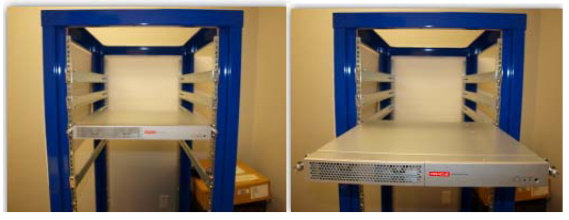

Always gracefully power down the Acme Packet 4900 and then disconnect the power supplies from the power source when removing the chassis cover.- Remove Acme Packet 4900 from the rack.

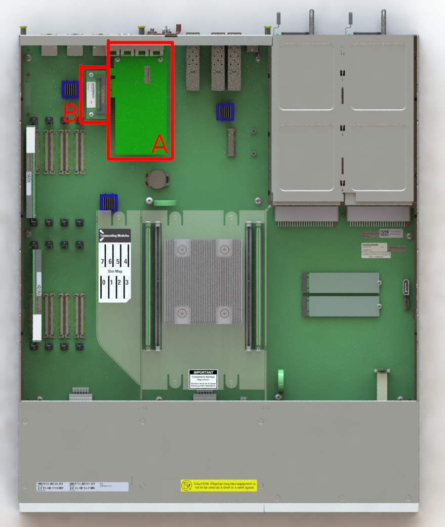

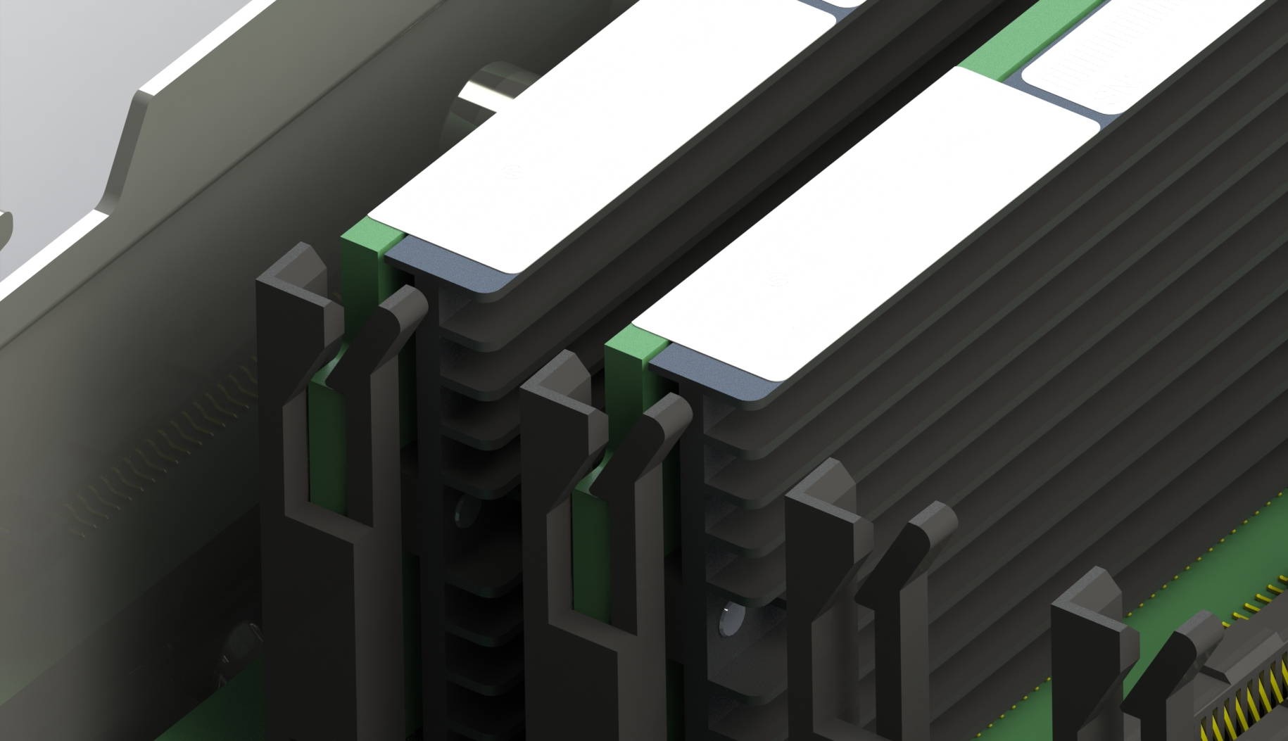

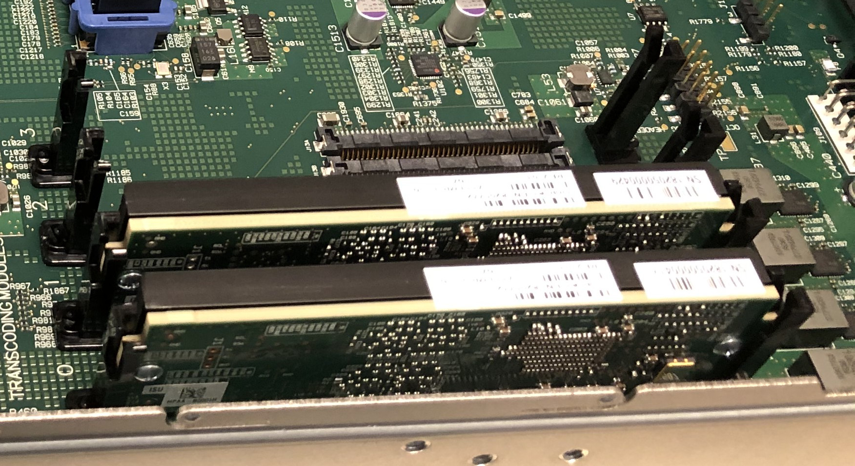

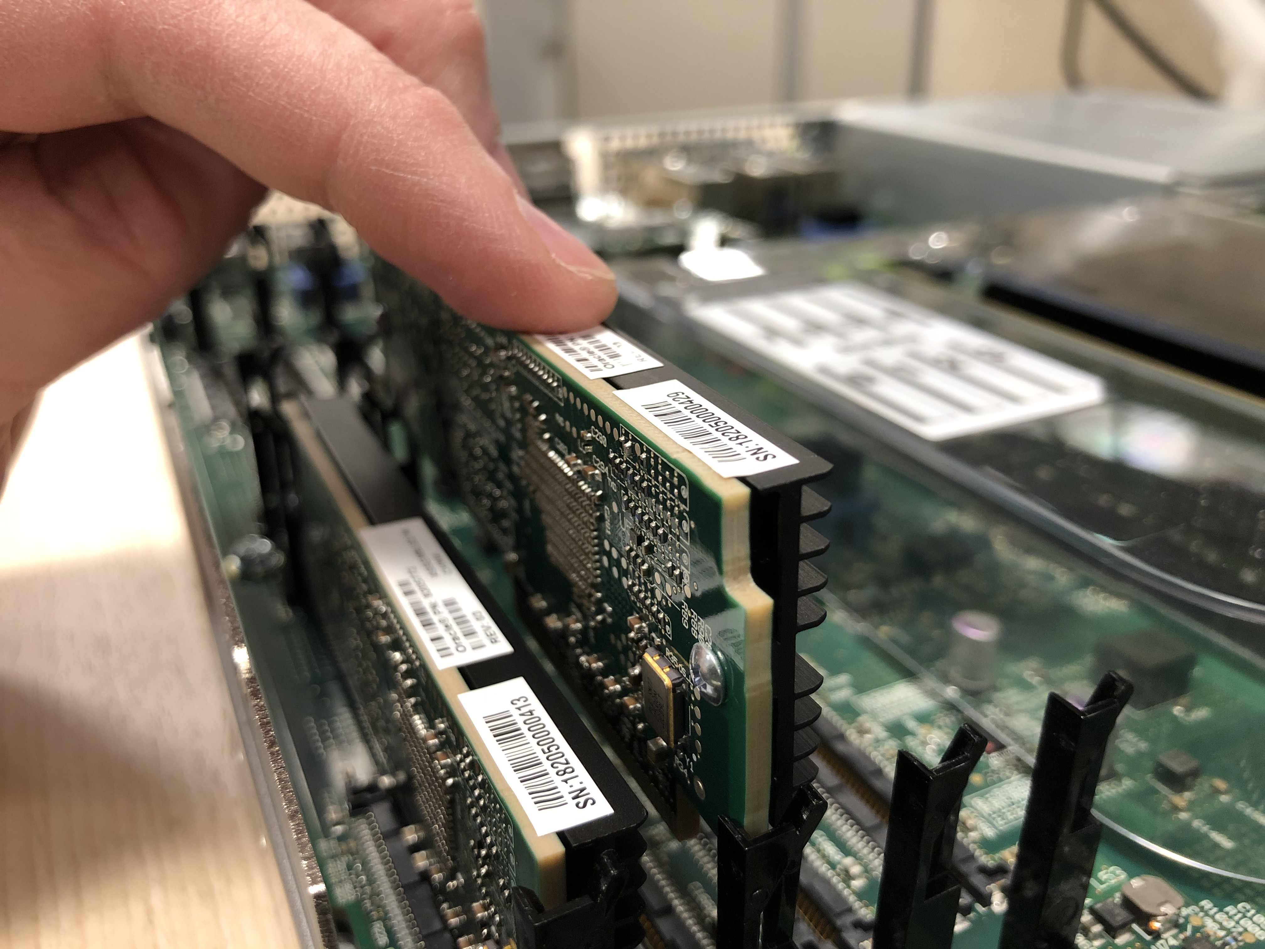

Replacing Transcoder Modules

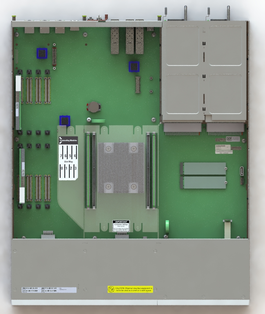

Up to 8 transcoder modules may be installed on the Acme Packet 4900 printed circuit board (PCB).
The Acme Packet 4900 PCB includes slots for installing the transcoder TCM modules. The slots are numbered 0-7. Slot 0 is in the bottom row and closest to the edge of the unit when looking at it from the front of the chassis. Transcoder TCM modules should be installed consecutively in numerical order, starting with slot 0.
Guidelines
- The transcoder module can be installed only in the designated location.
- Ground yourself and follow proper ESD grounding procedures.
- Remove the transcoder module from the shipped packaging.
- The installation of these modules should be performed during low-traffic periods or during times of scheduled maintenance.
- Follow industry-standard procedures to ensure ESD protection.
- When installing or removing a TCM module, move the card to an ESD-safe location.
Before handling any components, follow the proper ESD grounding procedures. Failure to do so could damage the card and its components.Required Parts
- ESD wrist strap
- ESD-safe location
- Transcoder TCM module

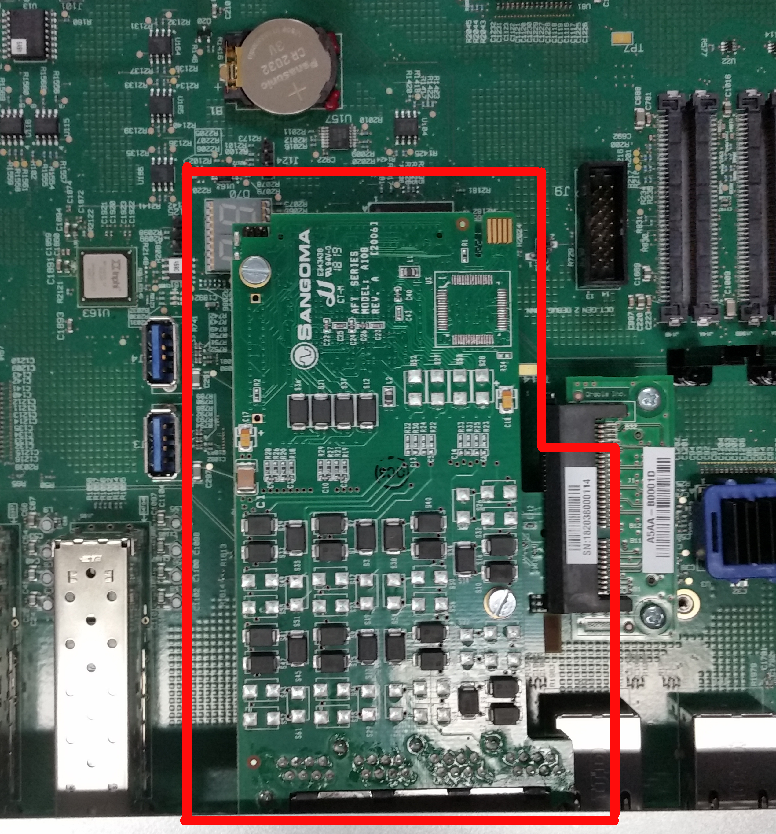

Removing and Replacing the T1/E1 Module

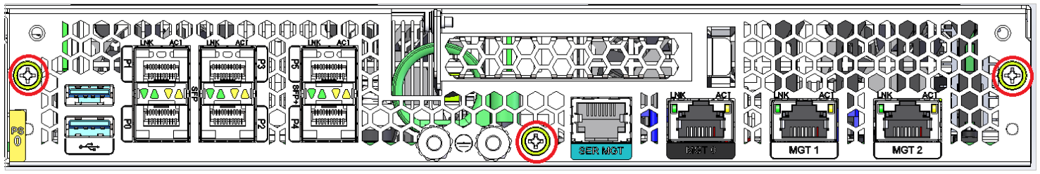

The T1/E1 module (A) is located near the rear of the board. It plugs into the rear panel as well as a raised PCI Express connector (B).

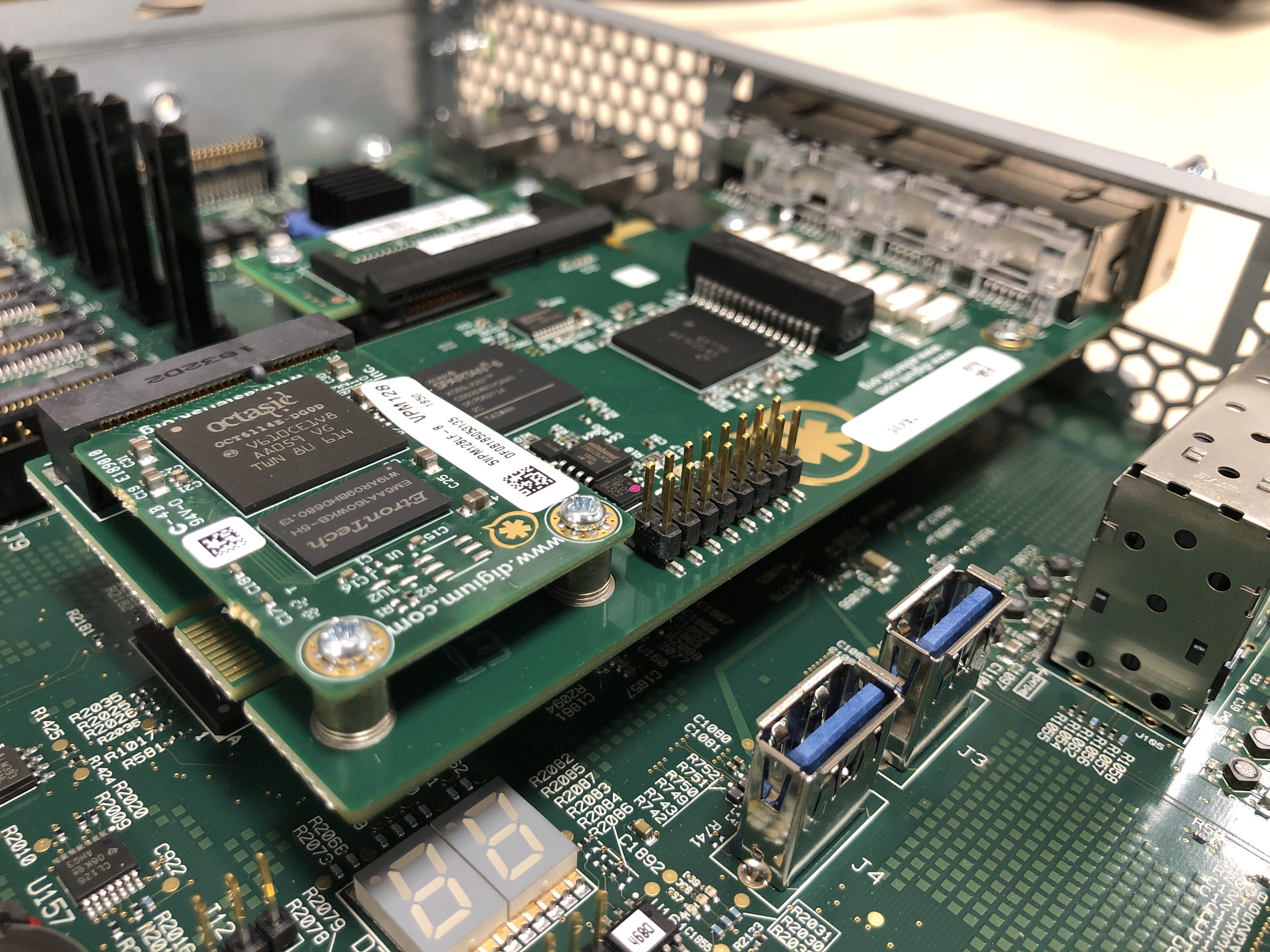

Install the TDM Module
If you returned your device to Oracle to replace a Digium TDM card with a Sangoma TDM card, the new port numbers are reversed. So port number 1 on the Digium card is now port 4 on the Sangoma card. Use show tdm spans to view the span information.
