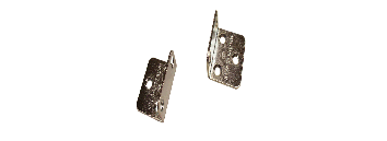

- Front mounting flanges (2) for use with mounting slide rails, used
to secure the chassis into the rack.

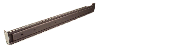

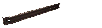

- Slide rail assembly (2), as shipped, with the chassis slide rail
inserted into the equipment rack slide rail.
- Equipment rack slide rail (part of the slide rail assembly).
- Chassis slide rail (part of the slide rail assembly)

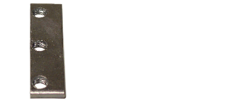

- Nut Bar (4)

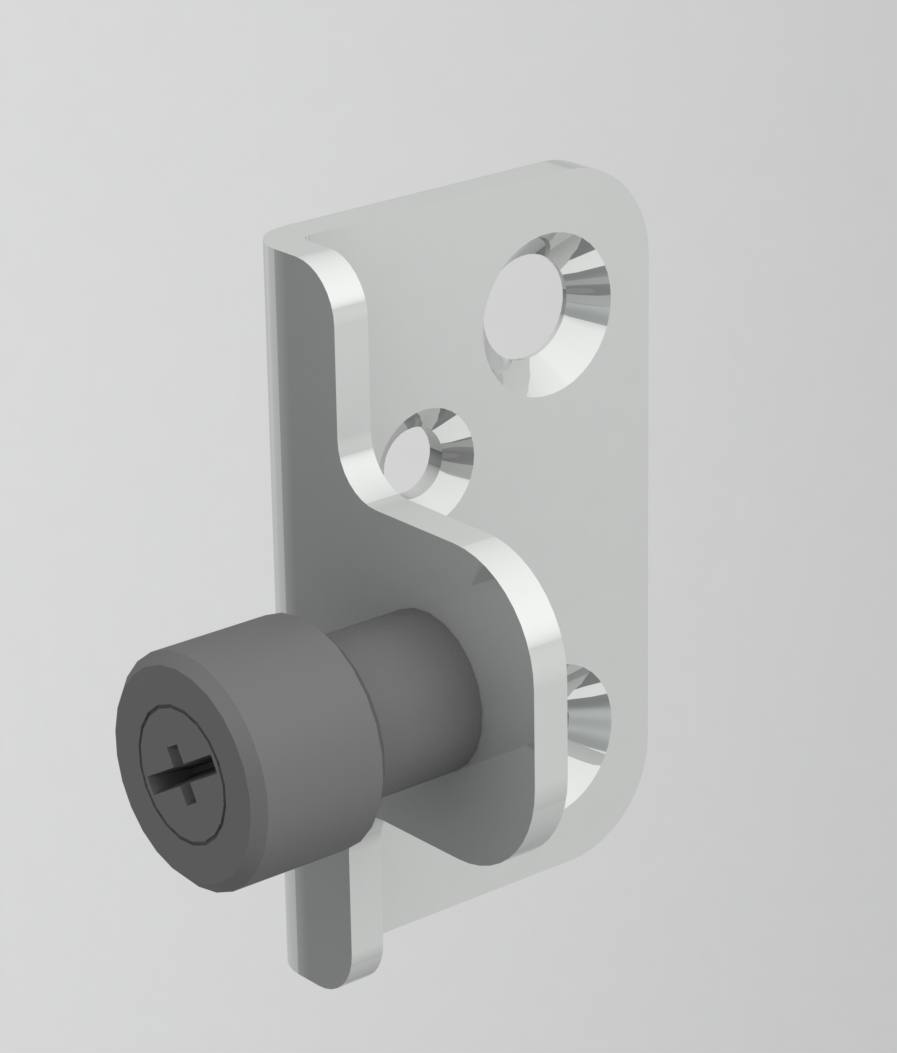

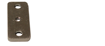

- Mounting Spacer (2)
- Phillips screws and a flat head screw
