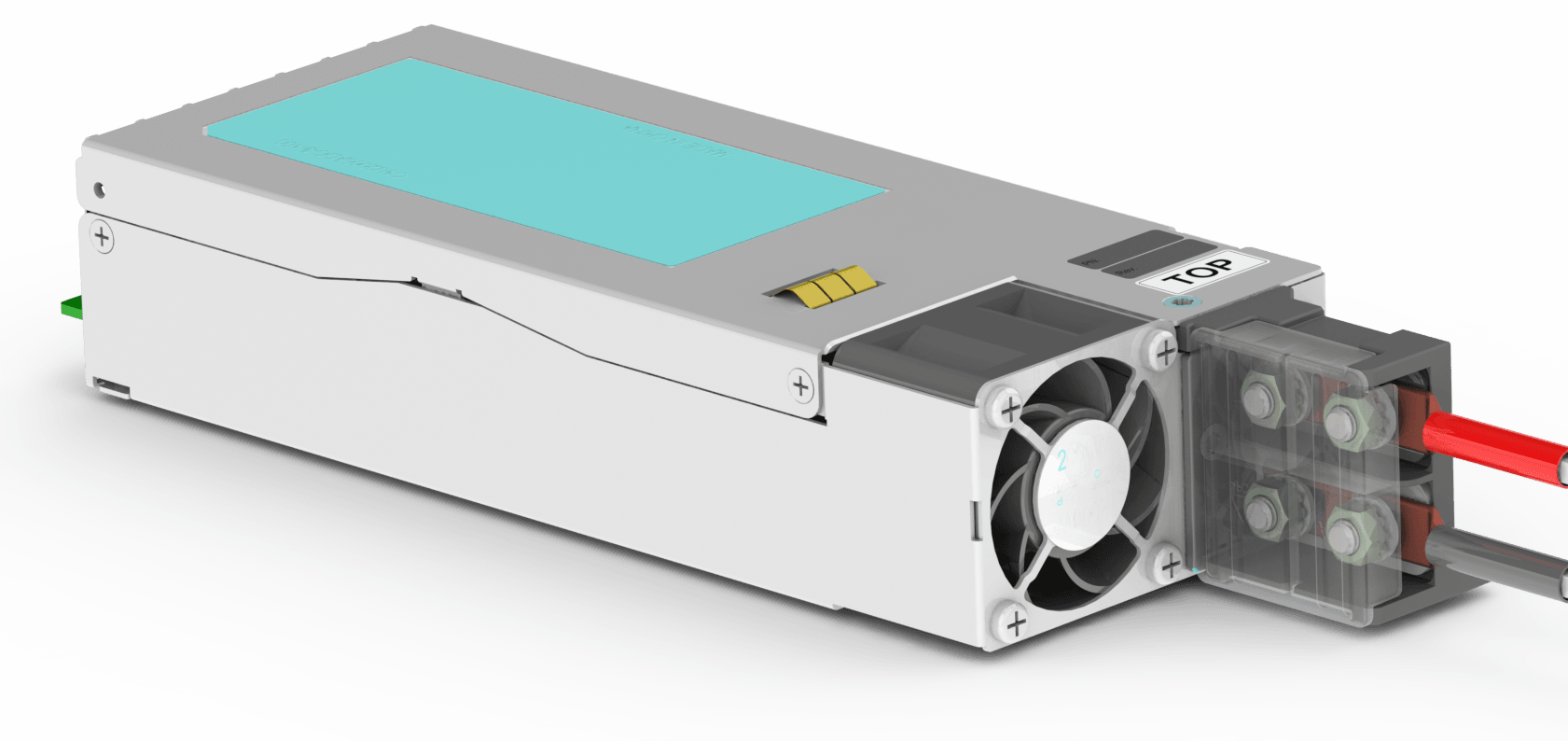

DC Power
The Acme Packet 6400 can be powered by central office –48 VDC operations with a DC-DC supply. The handle on the power supply is used to remove the power supply from the chassis. Move the locking handle from right to left to unlock the power supply. A removable terminal block on the DC power supply serves as the DC power interconnect. The terminal block must be removed before the locking handle can be moved to free the power supply.

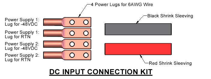

DC Power Cords
The mating connector kit only includes the components shown below. You must supply both the wire and the termination hardware for your rack level or facility level power supply.
Lug | Power Supply Designation | Suggested Wire Color (6 AWG) |
Power Supply 1: -48VDC | "-" (-48VDC) | Black |
Power Supply 1: RTN | "+" (RTN) | Red |
Power Supply 2: -48VDC | "-" (-48VDC) | Black |
Power Supply 2: RTN | "+" (RTN) | Red |
For each Lug, use a piece of corresponding color shrink sleeving to protect the wire connections.
