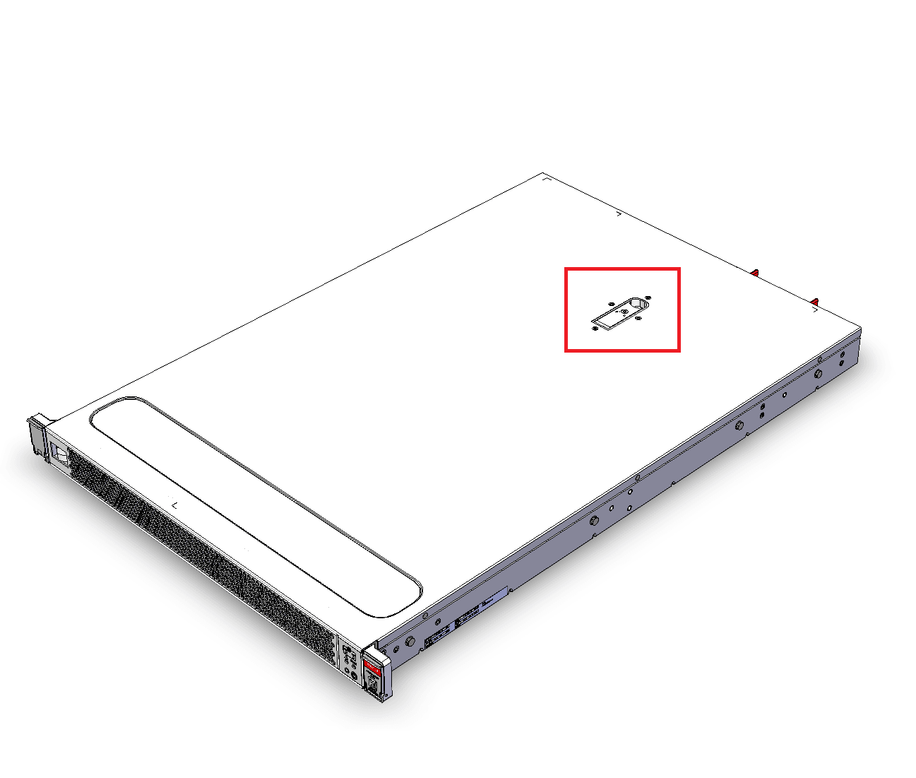

  1. Identify the latch for the top cover.
    Top cover latch

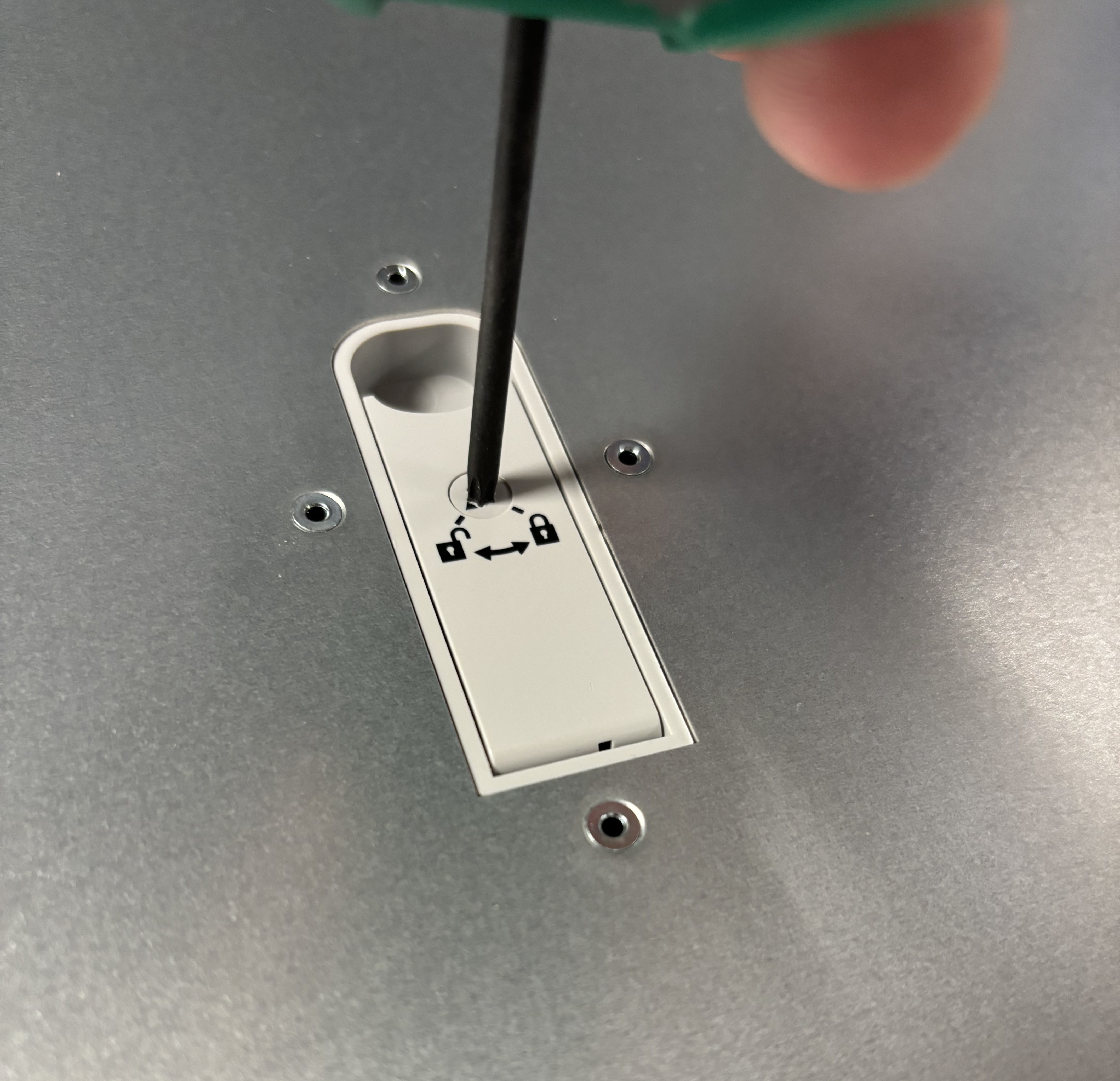

  2. Use a T15 Torx tip screwdriver to unlock the latch.
    Unlock cover

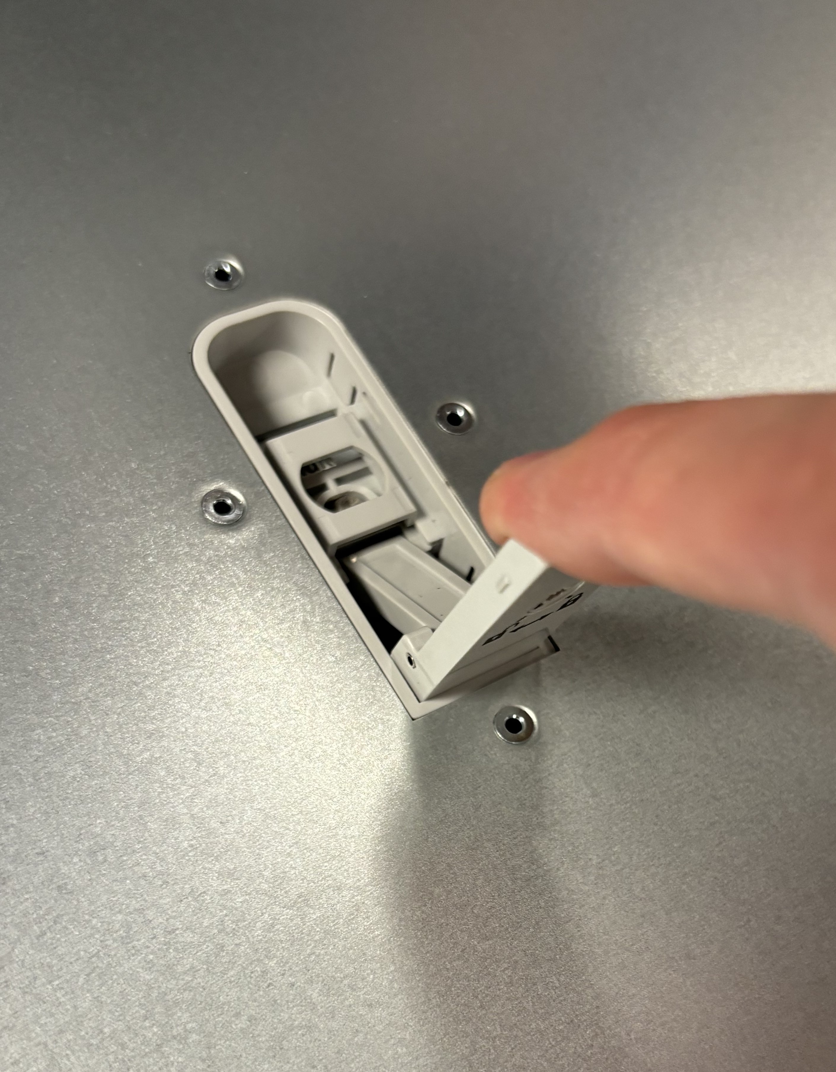

  3. Pull the latch up.
    Open latch
