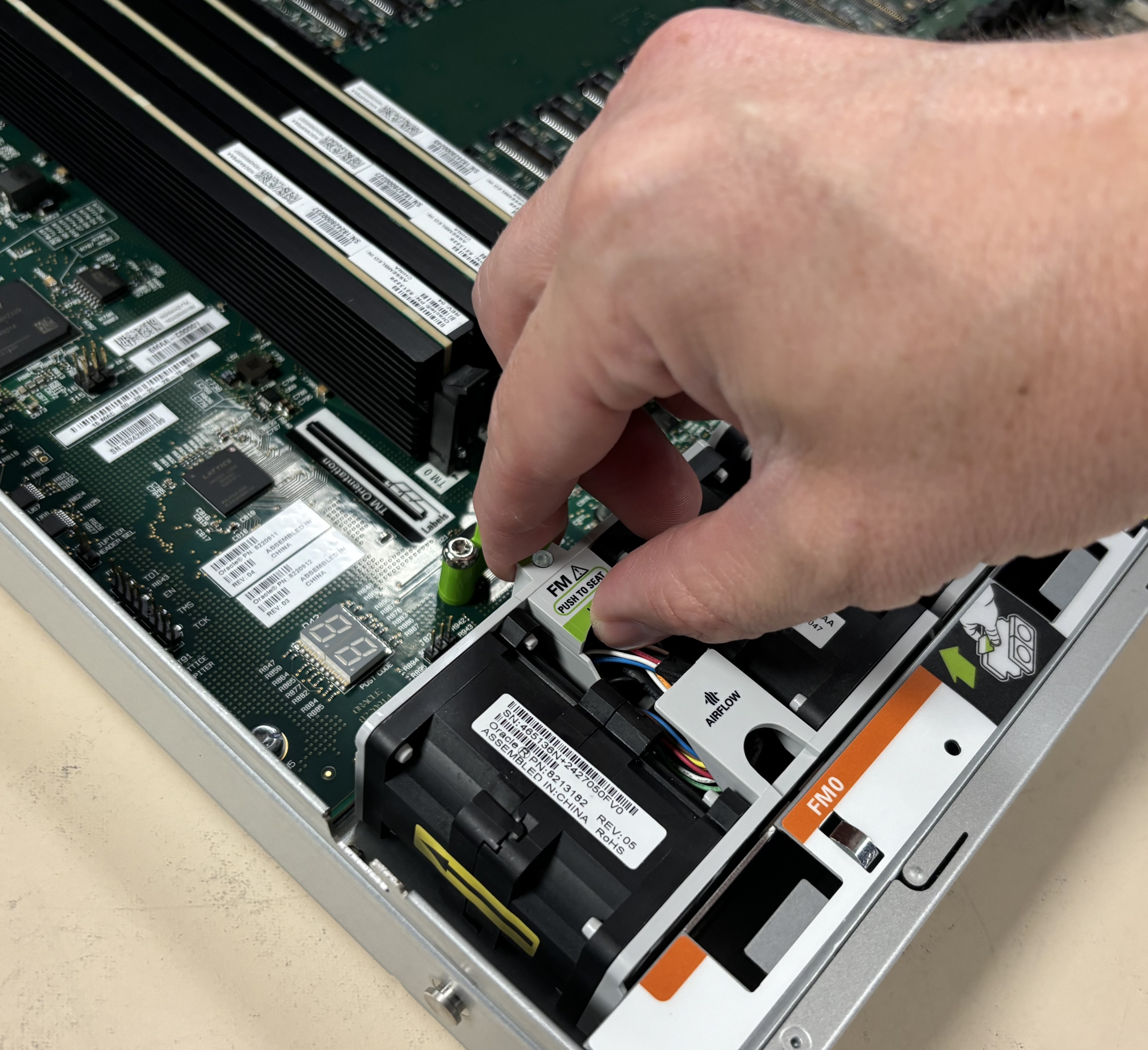

  1. Remove the top cover.
  2. Grasp the fan module by its center handle and pull it out.
    Remove fan
  3. Move the fan to an ESD safe location.
